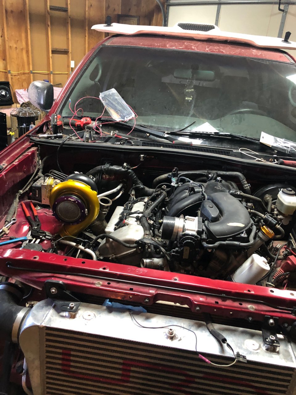

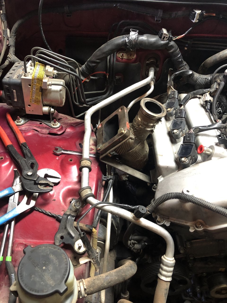

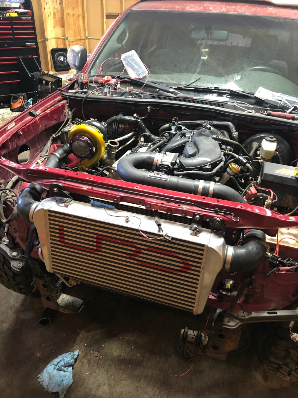

    Pesky A/C lines getting in the way. I still need to make my new lines. Ugh.
