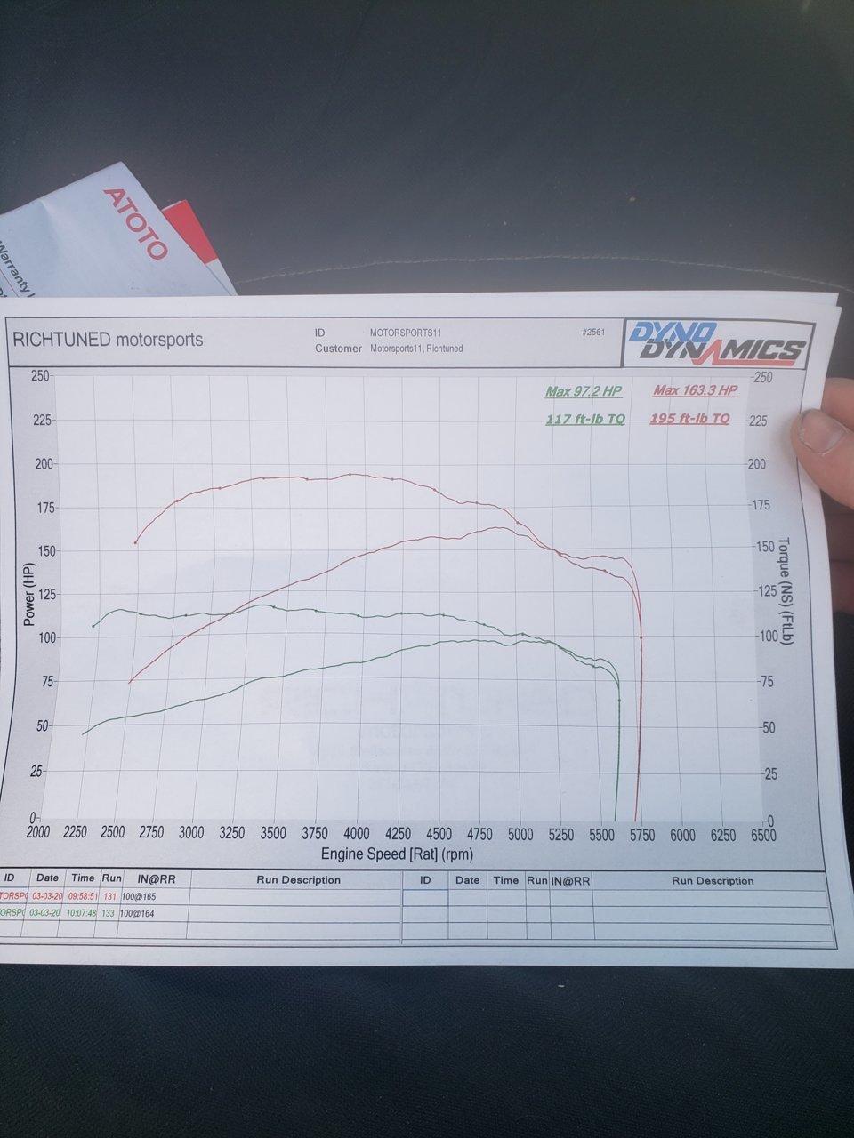

    Reaching peak boost at 2300 RPM's?
    I'm going to have a second guess at 240 whp.

    Man you have a lot of faith lol. Im hoping. I want to spank my buddies stock v6 and my buddy's cruiser with the ls in it. The second one is going to be a feat

    It all depends how well of shape the engine was in before the turbo was added.
    I am assuming yours was around 130 whp. That may be a bit high.

    Thats with 285/75r16 mts on it too. Happy with the numbers. im guessing around 230 flywheel

    That is a huge gain for your setup! Especially how early the torque comes on. So happy that you had a before Dyno run to compare against.
    As a reference, Dyno Dynamics typically read a few percentage points less than the Dyno Jet style. Neither here nor there though.
    You should seriously post that in my F/I Dyno thread, linked in my signature.

    @Bloodytaco208 , I believe that you have an upgraded fuel pump, and MAP-ECU3 (with the AFR module???).
    What size injectors do you have, and or do you only have a 5th injector?

    Im running just the pump i havent got mapecu or the urd adr cal installed yet. Stock injectors. Aem 320 pump. Its pretty lean 14.7 till i hit open loop and then it dumps it at 11.3 thats around the 4k mark

    Isn't the @OVTune software available? That would be the least painless, as far as installations go. And would allow you to run larger injectors. That's allowing you to turn up the boost some more. As well as having proper afr's all the way through the load ranges.
    @JustDSM may also be able to help out with the tuning. Big IF, but still an if.

    Since that and the Haltech both have to be wired in, and that the Haltech version that you need won't be much more than the MAP-ECU3, then the Haltech would be the much better choice. More capability, flexibility, and tuneability. Facilitating much larger injectors and the ability to dial them in easily.

    Ahhh. Do you have the AFR module? You'll need it.

    Yeah i bought it already. i need to get the cable and buy the software so i can manipulate it
