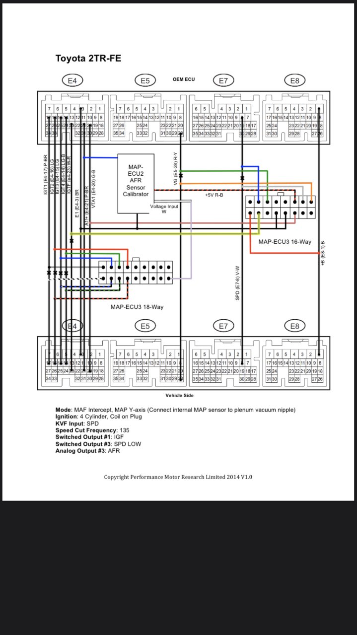

    I know im just getting lazy. When you wired in the MAF intercept

    My man thats what im talking about. Thanks bud. I need to start fueling i think my engine feels like that little chair under the fat chick.

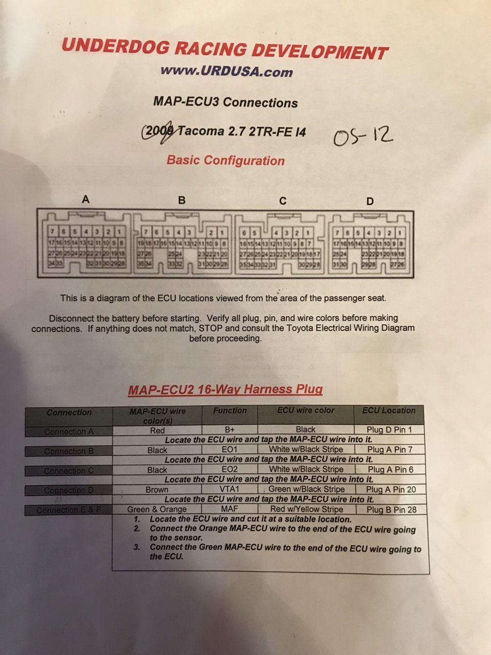

    It should be noted the diagram i posted above is for 2005-2012 2TRs. Plugs on the ECU changed for 13-15 year models, i believe

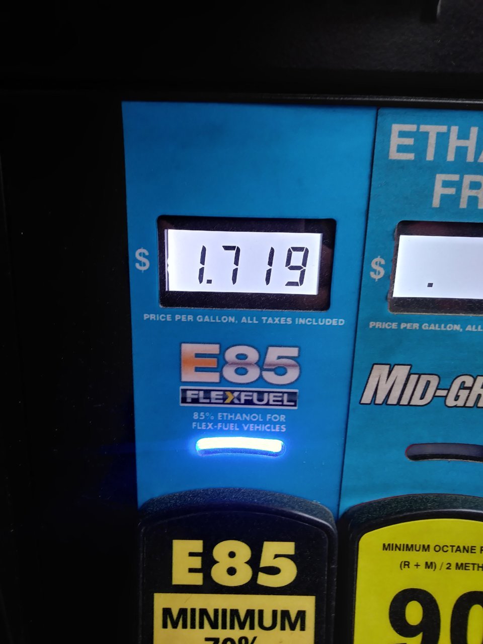

    20200319_073811_HDR.jpg $.10 off but still...

    Well dip me in dog shit good sir its my lucky day. My tacoma came into this fine world in 2006

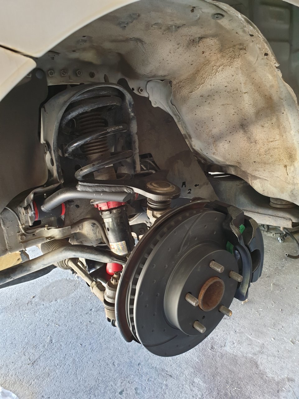

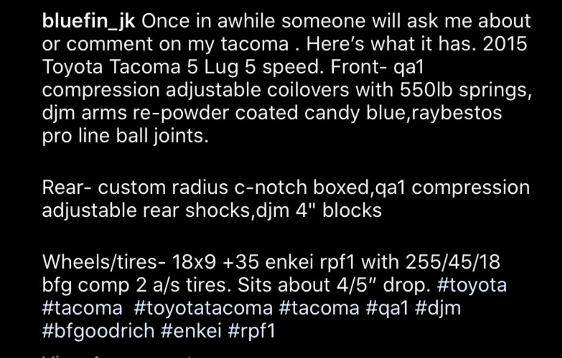

    I used to off-road with this guy. I like the look of his 5 lug, but I have no idea if it any good with handling. It’s his work truck and drives it very conservative.

    Damn, that's a wicked clean taco.

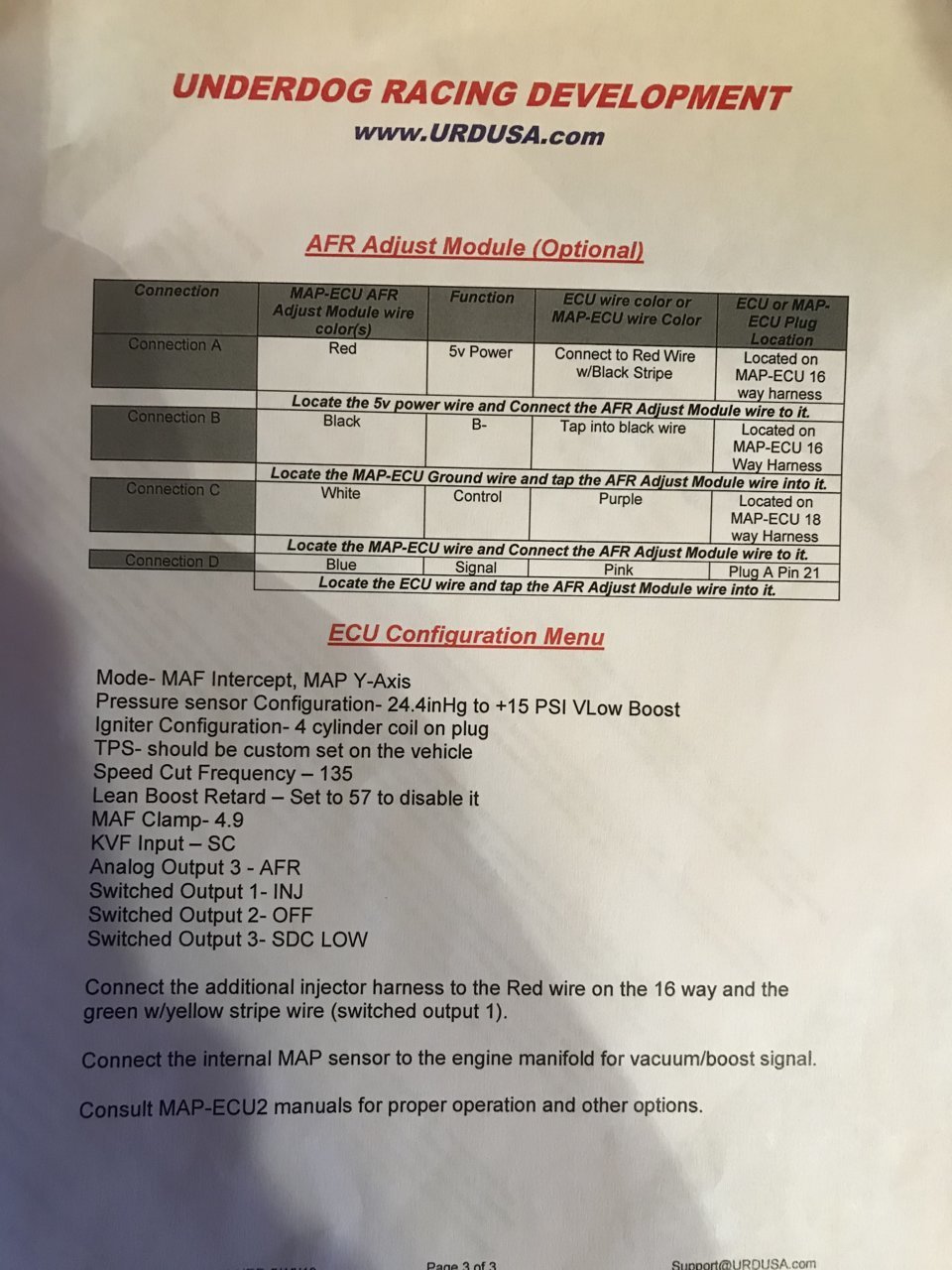

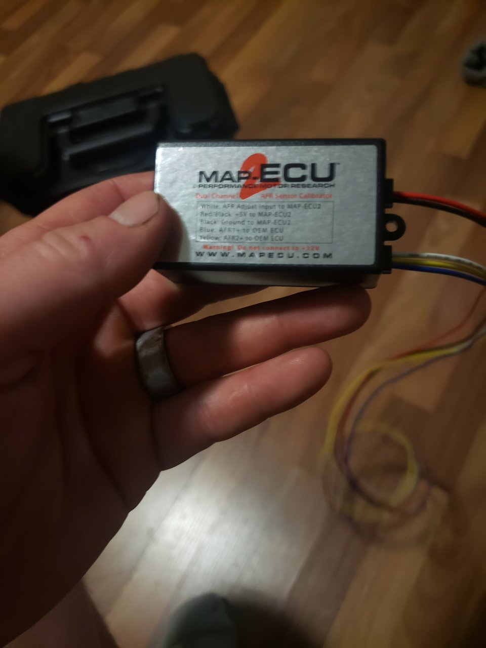

    So i finally got the urd afr calibrator switched out for a map ecu 2 and a shortshift kit so i can roll through the burnouts and make the panties drop lol. The wiring diagram has 4 wires for the afr calibrator and the afr calibrator has 5 wire

    Here's a little more info brother. I dont believe the yellow is used for anything. See the second pic for the afr adj wiring connections. Should use red (+), black (-), white (control), and blue (signal)

    Notice, the urd instructions are referring to the factory harness as Plug A, which was plug E4 on the previous diagram posted

    Thanks bud i just wanted some clarification. Your the man. How much boost you running in ur taco?
