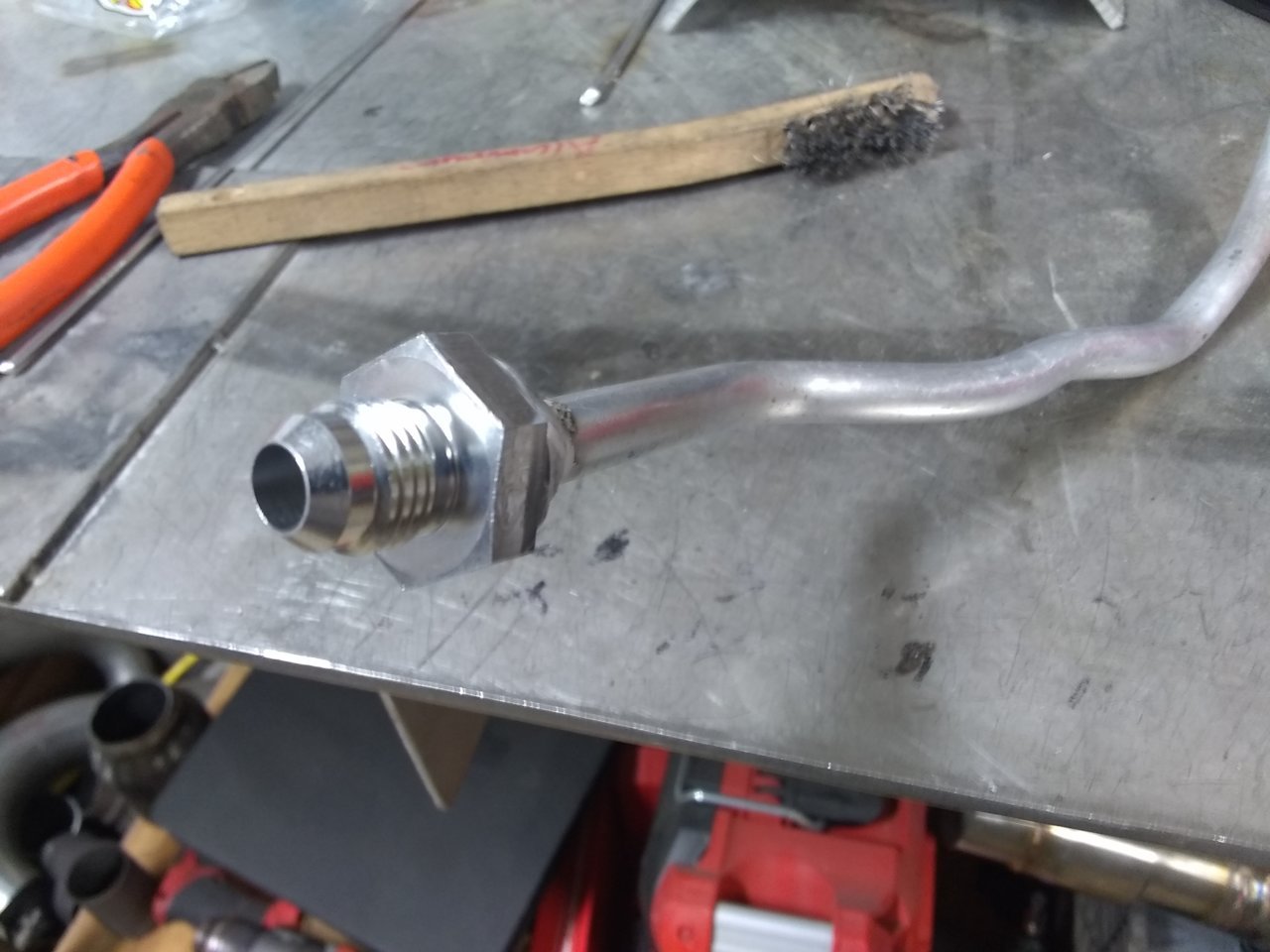

    What soft line did you use for your AC lines? Do you have a link?
