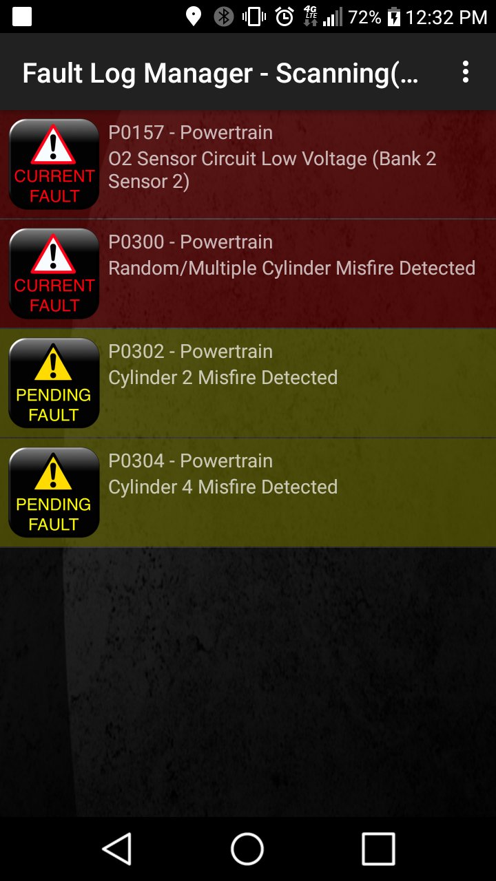

    Thoughts on tracking this down? I assume this may be the cause of my bank 2 ltft being 10-15% richer than bank 1... Maybe swap coils on 2 and 4 to 1 and 3 and see if the codes follow? Check the pligs while I'm in there?

    You check your plugs?

    Haven't since... Like a month after I swapped em and I can't right off tell you when that was; probably 15k miles or so
    Just looked back and first start up on mapecu3 was with 211k and I think I'm at ~235k now and plugs went in a bit before that so 25k miles on em
