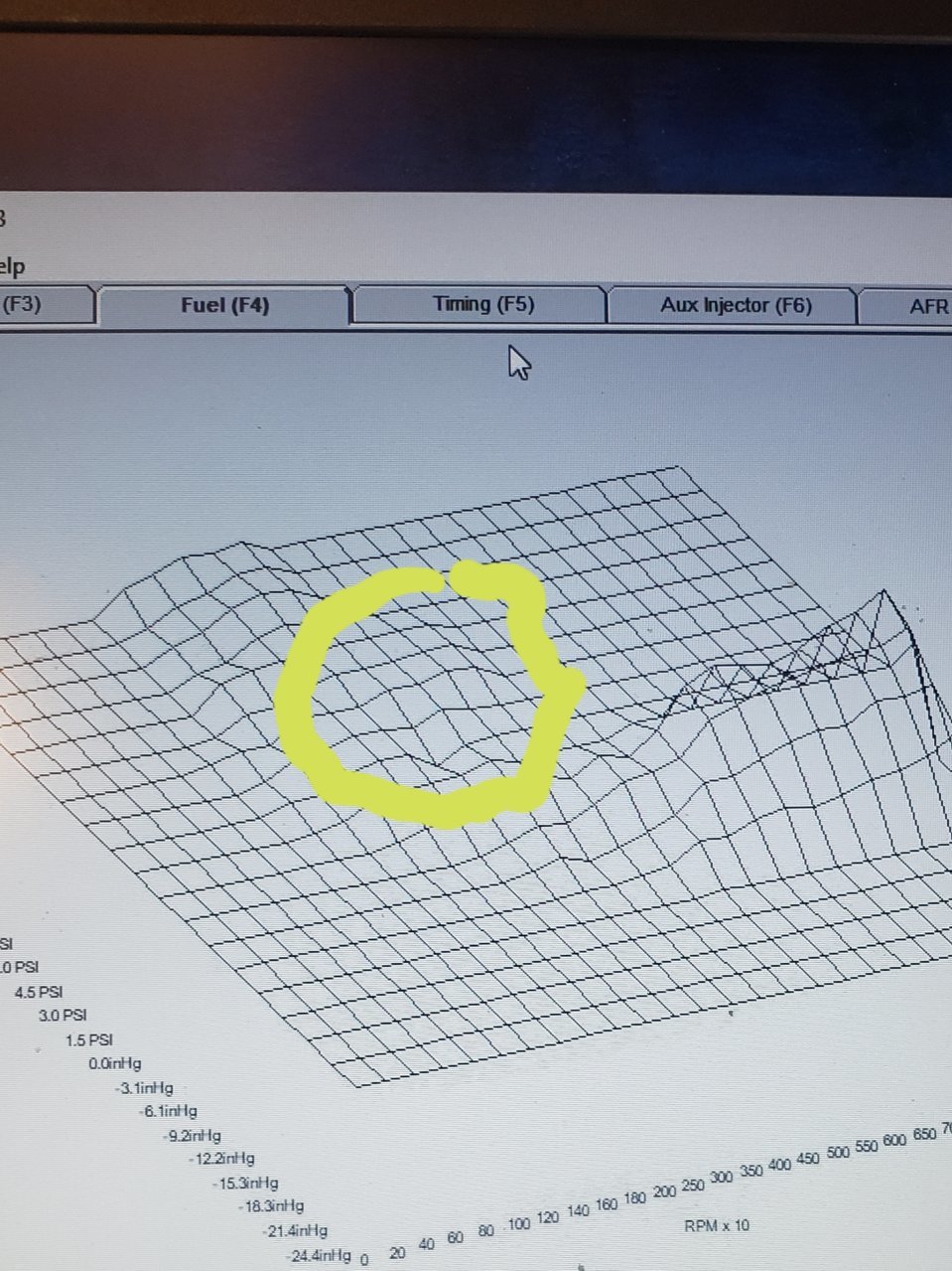

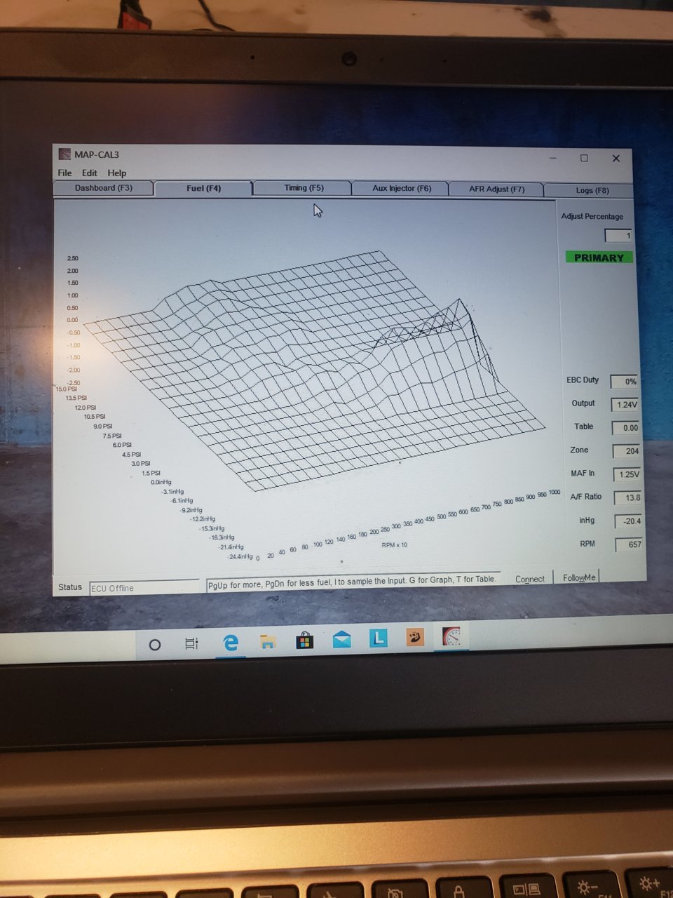

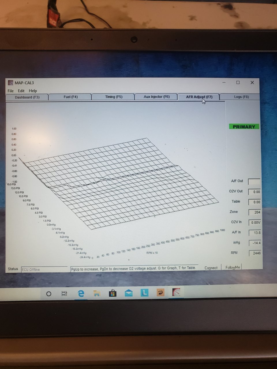

    So tell me if im not understanding this correctly. I know theres fuel cut at 5 volts with the maf makes the truck jerk like a bastard. When im in closed loop i sit at a nice 11.9 to 12.5 depending on rpm and boost. When i transition to open loop it jumps to 14's and starts rising. I get the maf to about 4.9 output from the table and the afrs wont go down. This is where my theory of im out if injector comes into play. By noting the screen im only applying about .65 volts into the ecu to fuel more. So am i correct or am i missing something?
    Refer to tables

    Yes im still on stock injectors. I just manipulate the afrs to transition smoothly from closed to open loop. I would believe it to be a positive number needed to be added sue to the maf sensor voltage increases with throttle

    You need to adjust your MAPECU configuration. The majority of your fuel table adjustments are over the engines redline. Given that you're trying to add fuel at 6-10k RPM, I bet that's why your adjustments are making no changes.

    This^^^. It will drastically change your map.

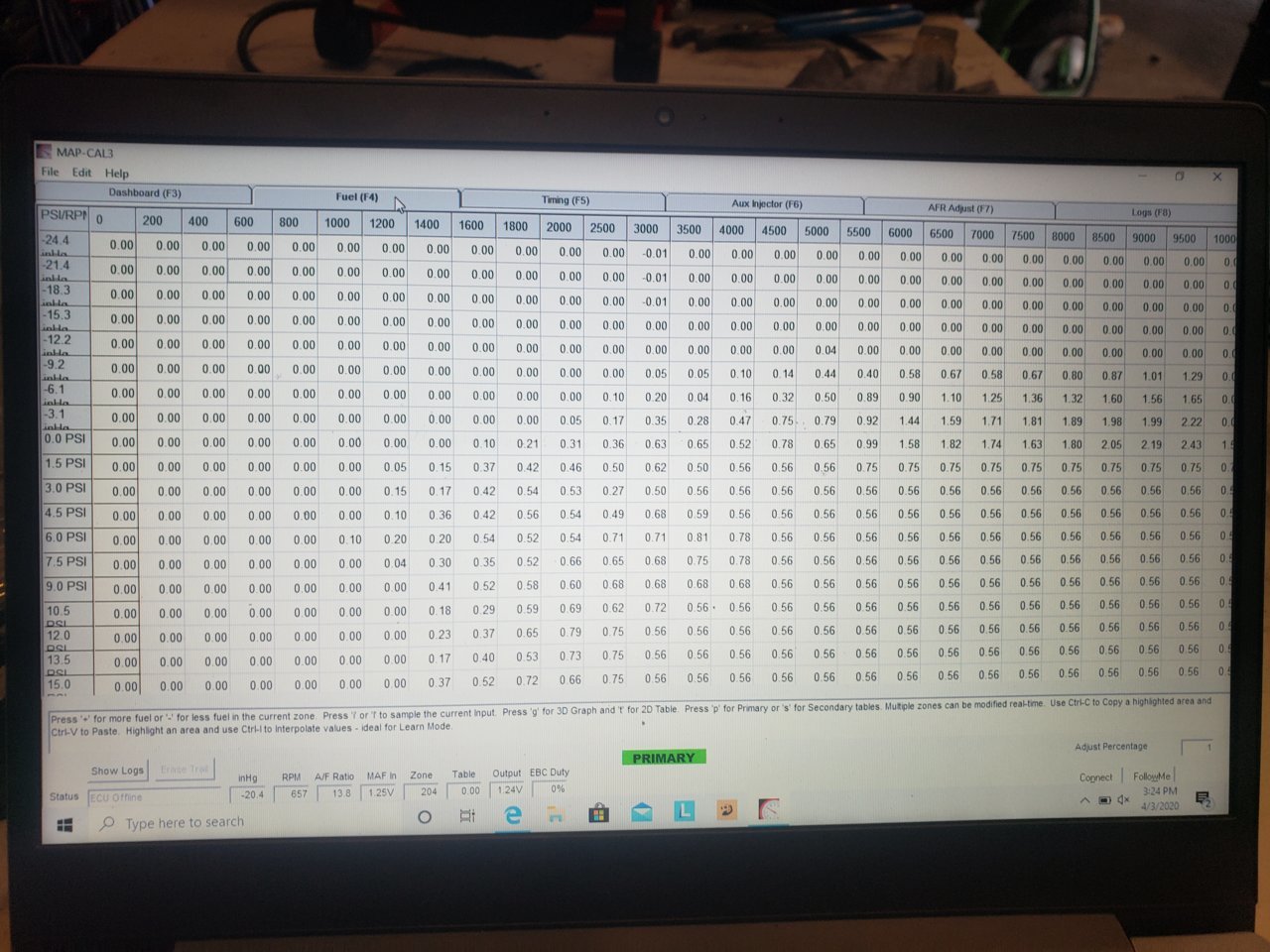

    So i havent cleaned up the table to make it "pretty" sorry lol, my tuck doesnt get into the area of the tables.upper central from 2-4500k rpm and 1 to 6 psi of boost is where im at. The table is rouglhy around .65-.75 increased voltage to keep the maf from holding on 5 or exceeding the threshold to reduce fuel cutout. At an idle my tuck sits at 1.3 volts input. If i push the table higher ill get a over voltage code for the maf. The manual says idle should be between .5-3 volts

    Setting the RPM range properly puts the cells at tighter groupings which gives you finer control of your adjustments. Can't really tell what's going on with the graph as is. The table view would be easier to follow or atleast see specific adjustments a given RPM/pressure.

    Everytime i bring the table down it tells me there is an error in the table

    Heres the table

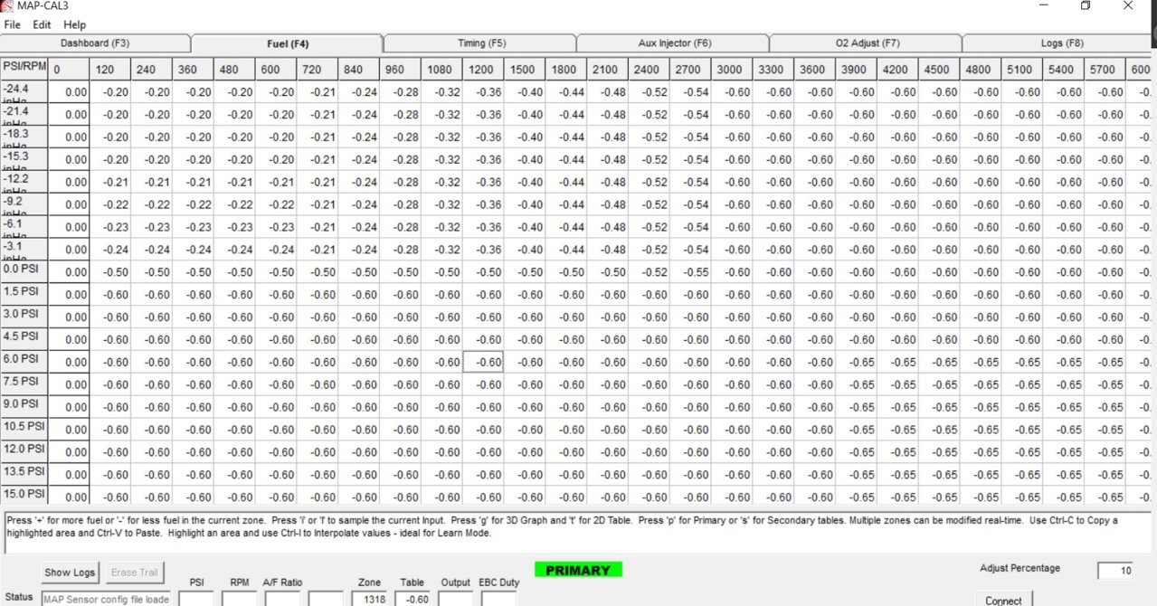

    Definitely chop your fuel map down to 6k rpms. ECU config - General Tab.
    You are out of injector when your log file FUEL voltage gets near 5V. Good chance you are at the end of your injector adding that much fuel.
    Larger injectors brings you whole table down. I peg out my maf sensor, but I can still add fuel because my ecu is still seeing less than 5v. My whole table is in the negative.
