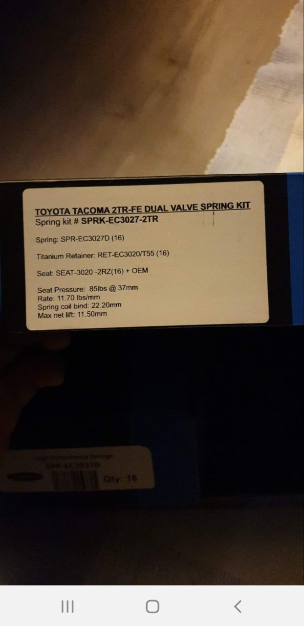

    Lads, supertech have dual springs, retainers, nitride and inconnel valves for the 2tr. Thats who i went through and im happy as.
    I had gsc make custom valve guides.
    And ported :)
    Sleipnir, 05Taco4x4, not_nick and 3 others like this.

    Do you have part numbers? There aren't any 2TR parts on the supertech website.
  11. Apr 7, 2020 at 7:12 PM
    Twinkles
    Twinkles Member
    Jun 30, 2019
    #297862
    17
    08 turbo hilux
    Turbo 2tr hilux, haltech elite 1500 Shortened and c notched chassis, 4link with qa1 coil overs
    This is for the valve springs. For the valves, email them. Cause there is different types and sizes
