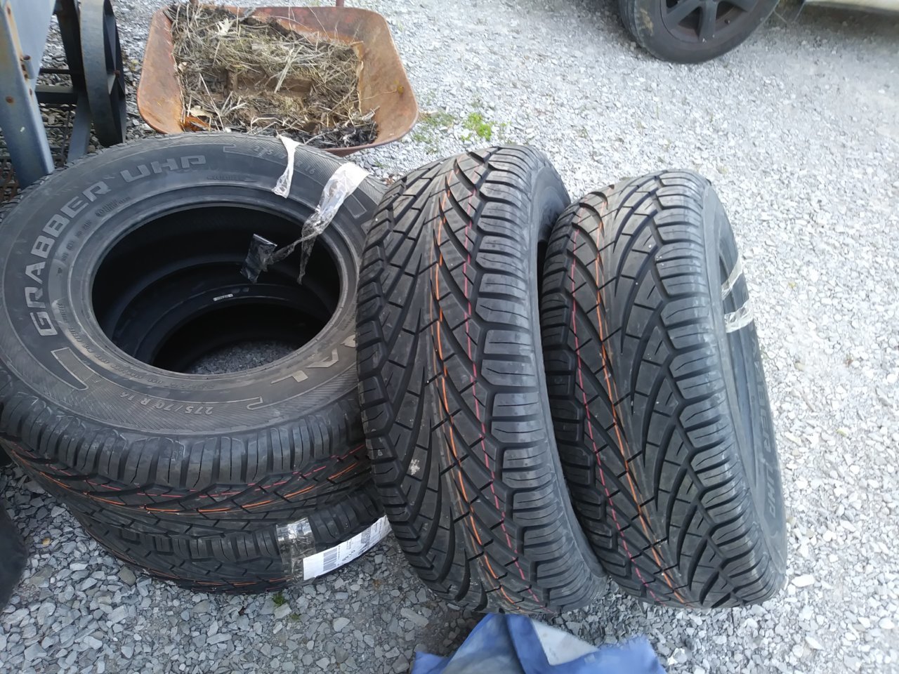

    Bw s256 turbo with 3 in glass pack dumped pre axle raptor liner bed and top rails and fenderflares and rocker panels. Hunter side steps. Plasti-dipped upper fenders and emblems. satin black spray paint here and there inside and out. 5100's set to 1.75" up front . C channel front bumper. Maxxis bighorn 255/85/16
    Prioritytire.com does free 2 day shipping it seems

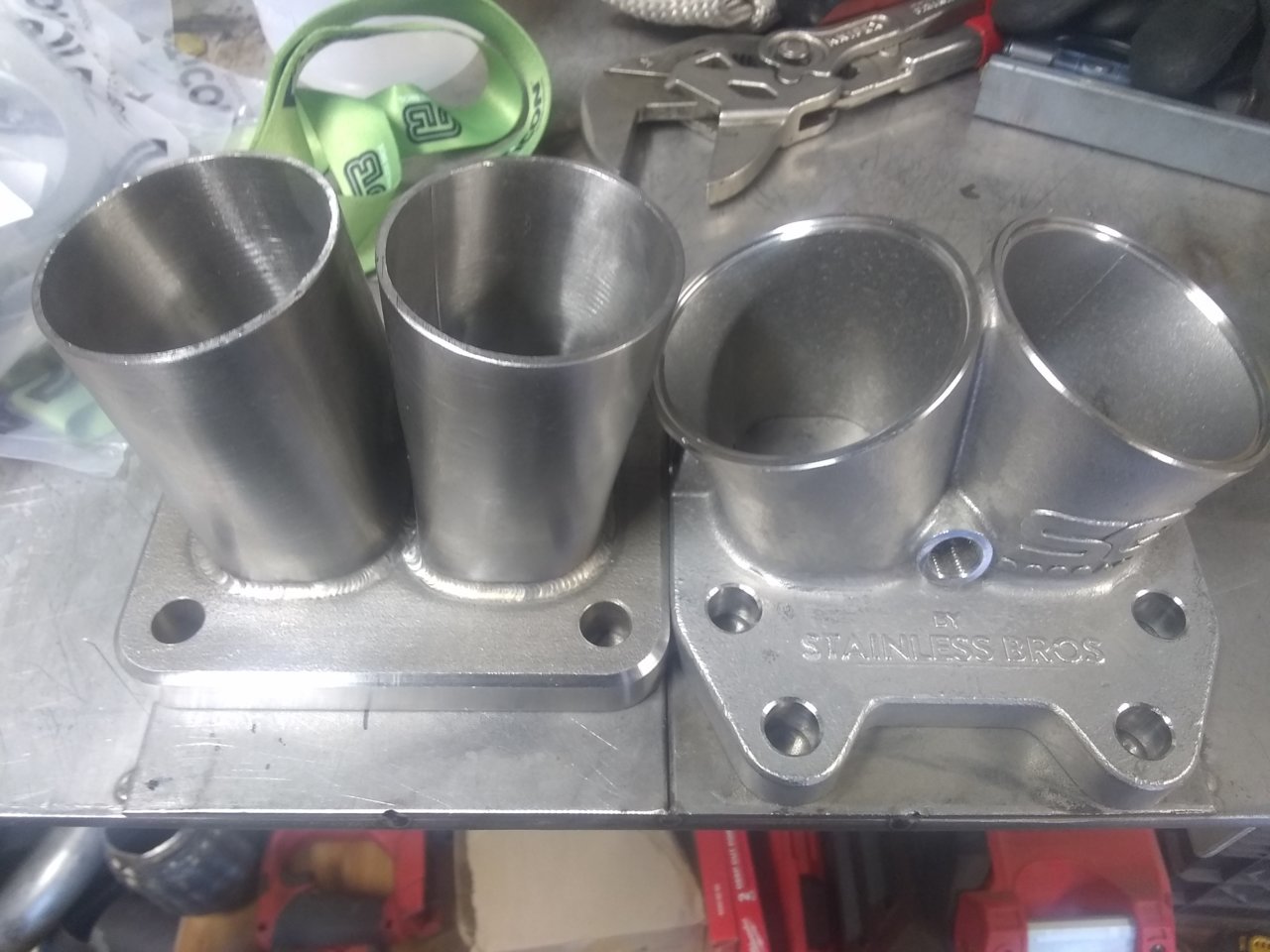

    4.3+ Liters. 3000 breaking boost threshold, and about 3600 for full boost at 17.
    Not happy with it. Tried a different exhaust routing and sizes. Greatly reduced the spool time versus the old (original exhaust) setup. Some material on order to change things up. :D
