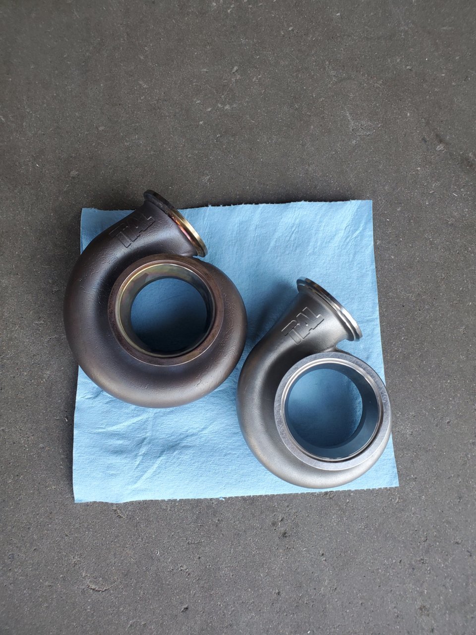

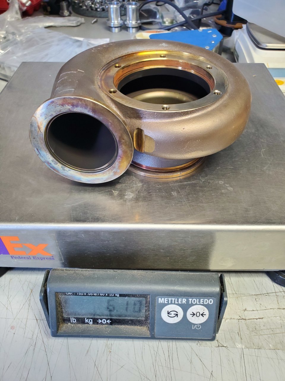

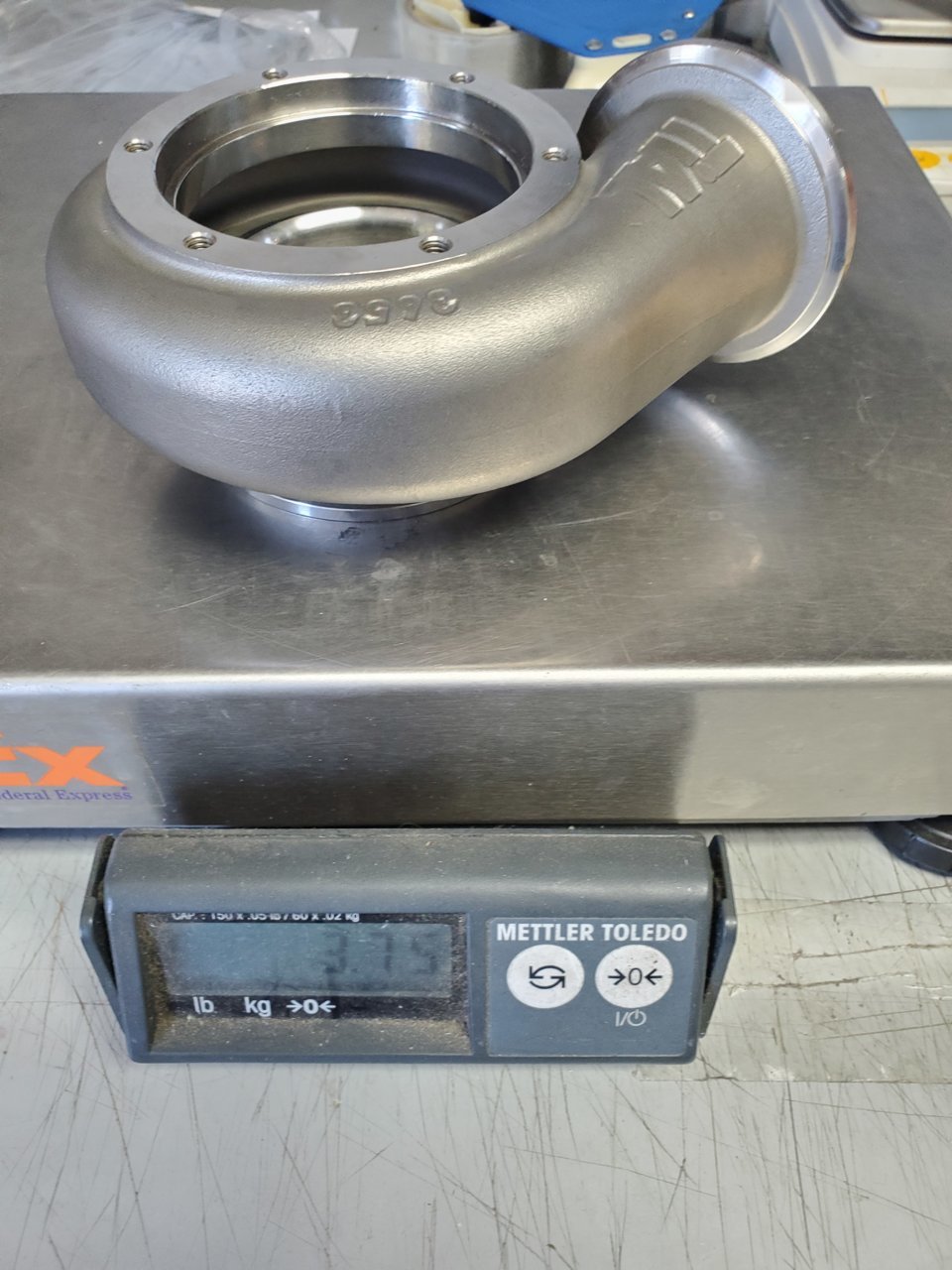

    Welp, the guy who was going to trade me housings flaked.
    So I found a decent deal on a new .63 housing in stock locally. Its comical how small this housing is! Guess we will see how quick a 35r can spool (and choke) on a 3.4. What are your guesses?

    Almost half the weight, and probably half the spool time. ;) Max boosty at 2200.

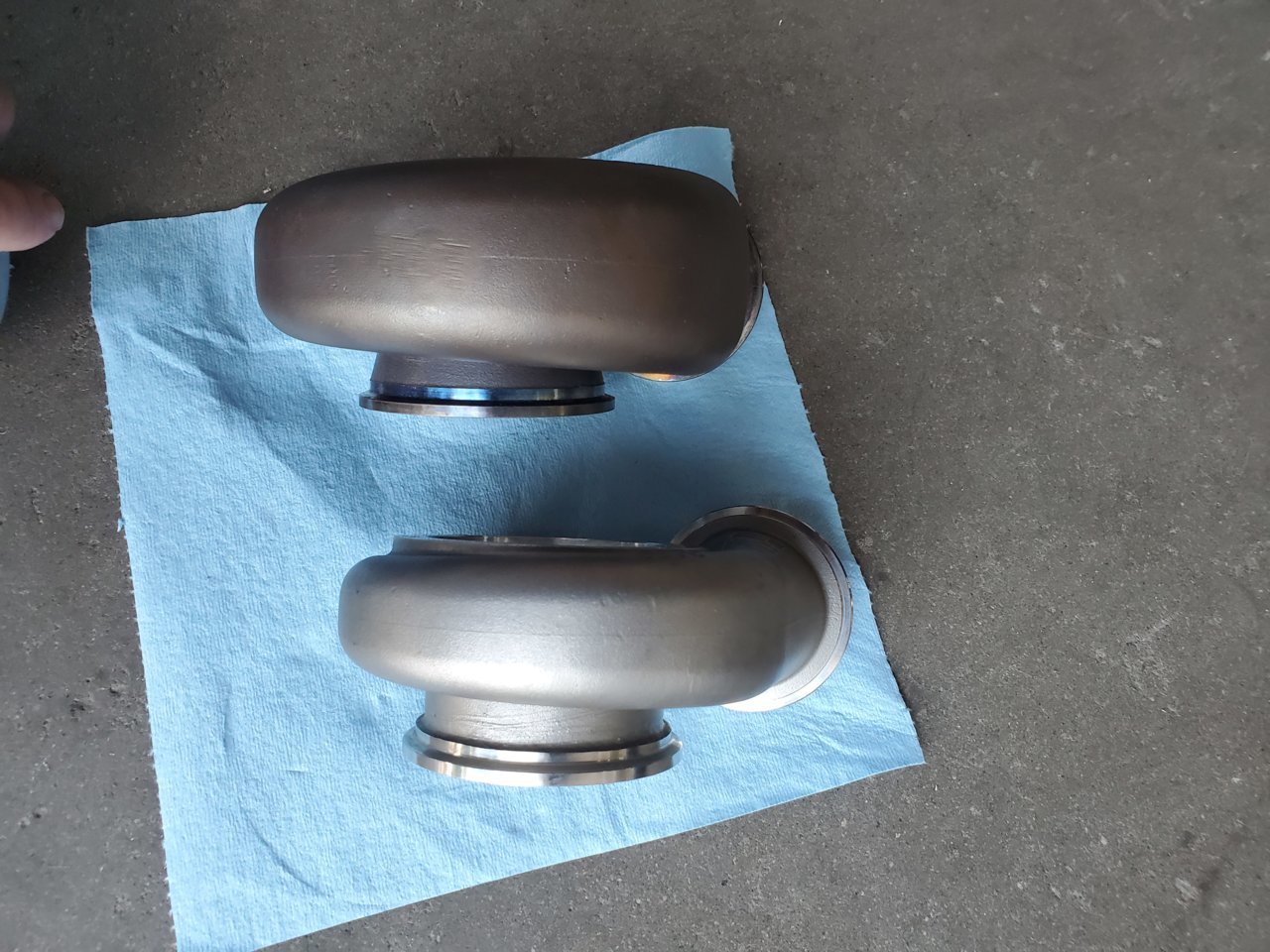

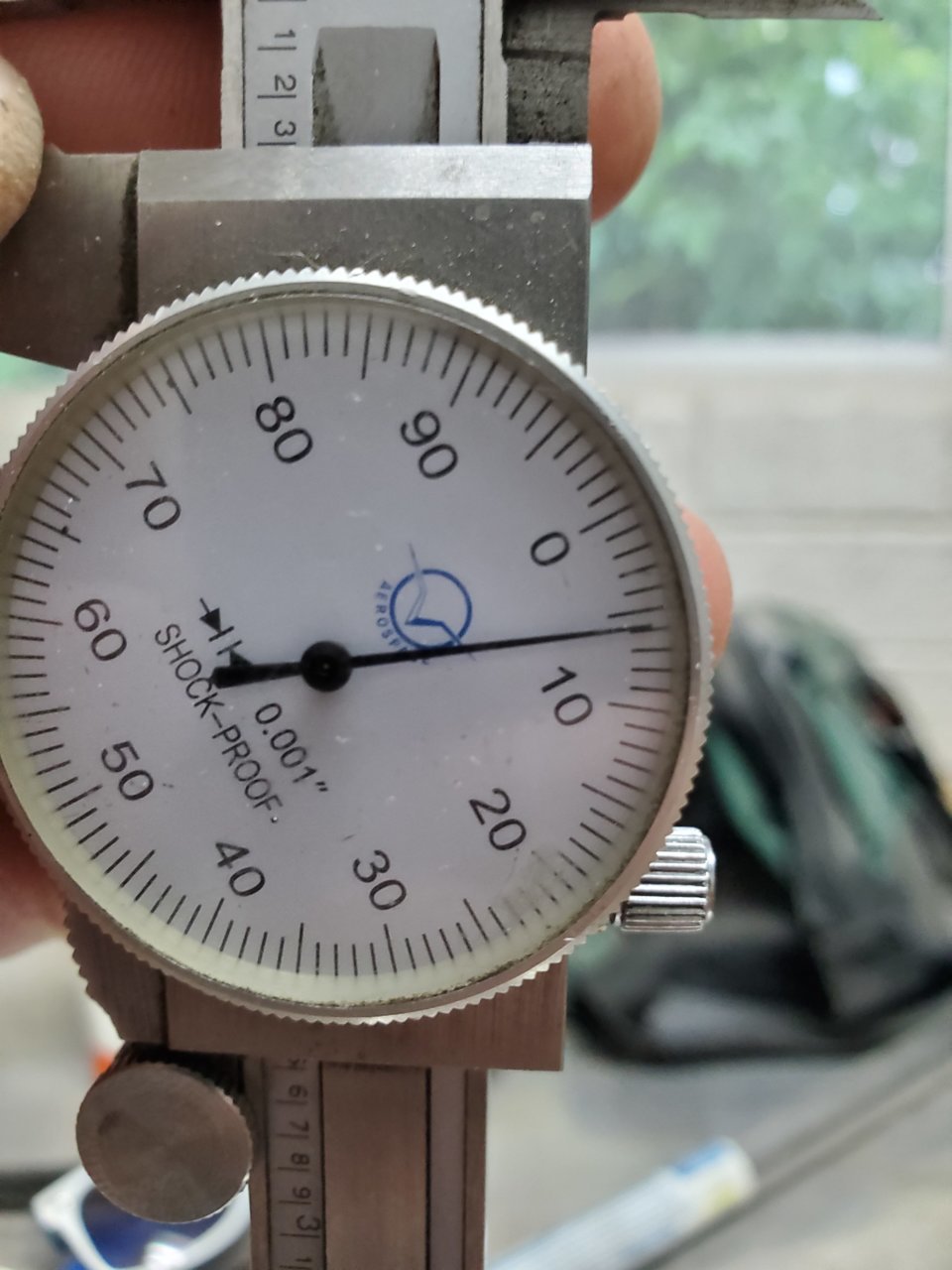

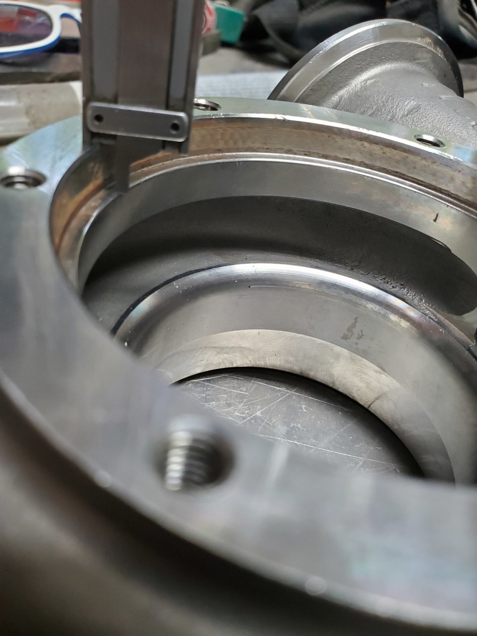

    Psych!

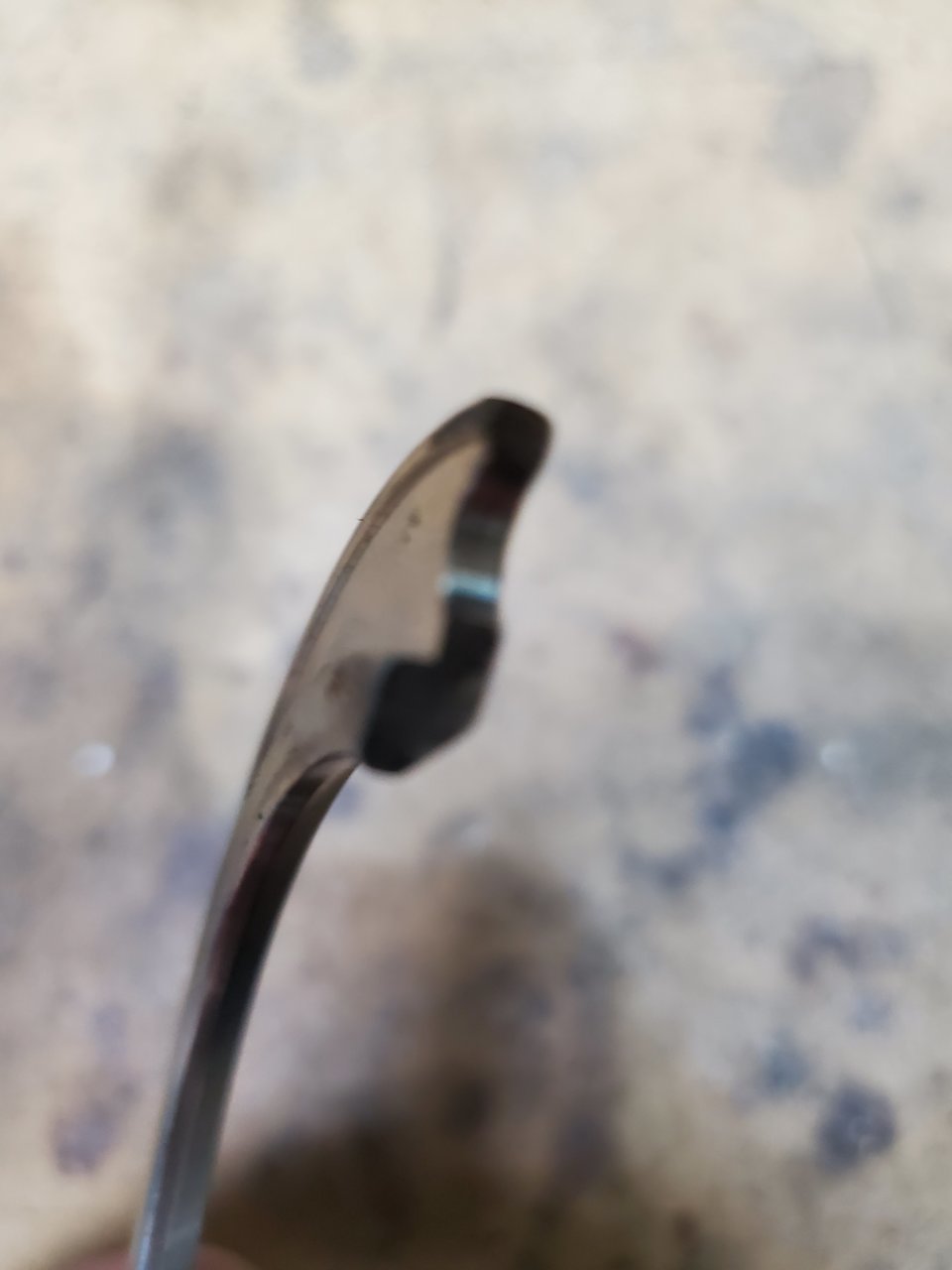

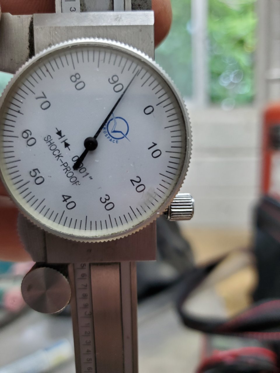

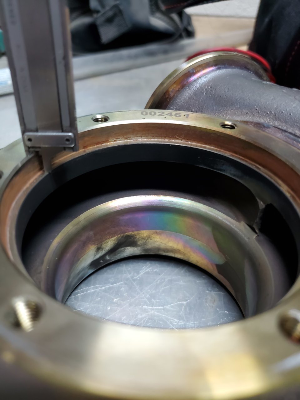

    Just went to install the new housing and it wont tighten down. Yes, I tightened the bolts but the housing still spins on the Chra. Quick check with calipers and the depth is about 0.013" deeper on new housing. Gonna pop it in the lathe and face it down.
    Bonus round! There is a lip on the clamps that is about 0.017" thick. Thinking about just grinding that down if the lathe somehow doesn't work out.

    Wonder why they would have different depths if made for the same turbo or turbo range?

    I'm not sure either, can only speculate. Machining goof up I suppose. 1st housing fit great, was purchased separately from turbo too.
