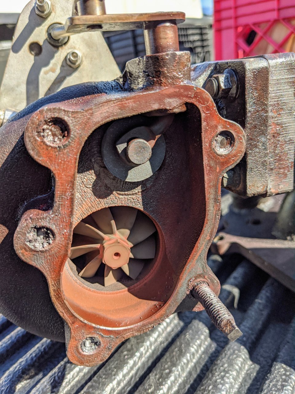

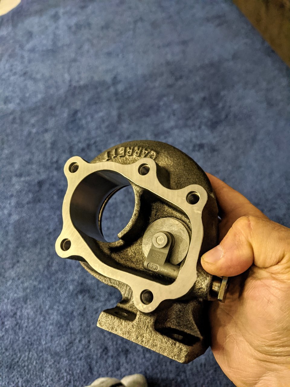

    Side note - Finally got my exhaust leak fixed! Decided to just get a new genuine Garrett turbine housing to make life easier. Also adjusted the preload on my wastegate a little better since the downpipe was off and I could ensure it was fully closed. So happy to be making boosty noises again!

    This is good news! Got that gooch all cleaned up and weld glued back together holding steady eh?
    How well did the Garrett housing fit?

    Yeah, no more ripped taint lmao. The machine shop welded all 4 sides of the collector, and faced the manifold-to-turbo surface for me. Not bad for $50!
    The Garrett housing fit perfect - I actually like how much better it's designed compared to my Ching-chong-Chinesium housing. Hopefully no flaking on this one. It's also their Ni-resist coating, which should help with heat (Even though I'll be using a turbo blankey). It also gave me a chance to inspect everything on the turbo itself, which was good. No issues, my shaft is nice and tight, no motion. Compressor housing had a very slight amount of scuffing on the surface where the compressor wheel resides, but no damage on any of the compressor wheel blades. Not bad for having 32k on a China turbo!

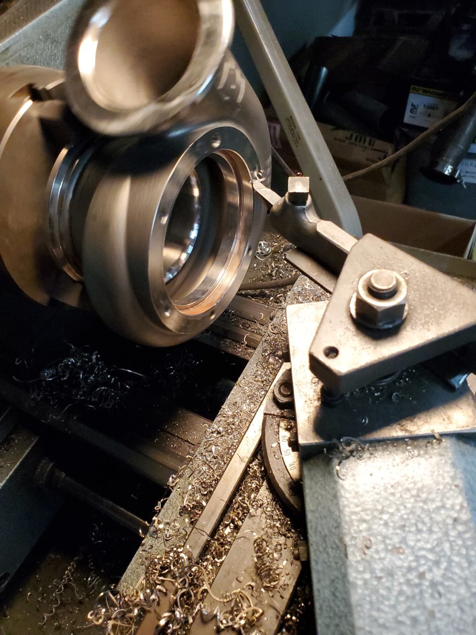

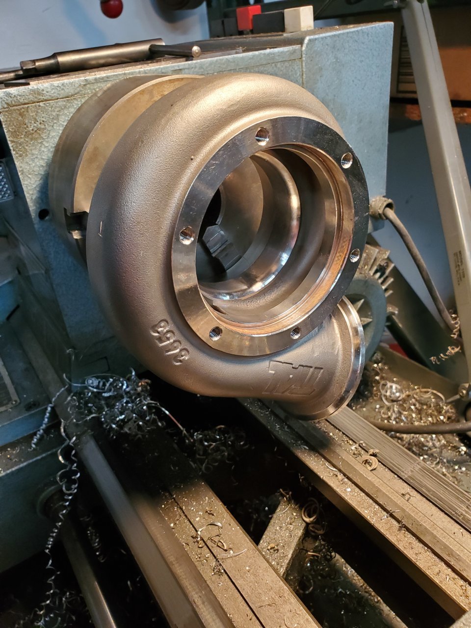

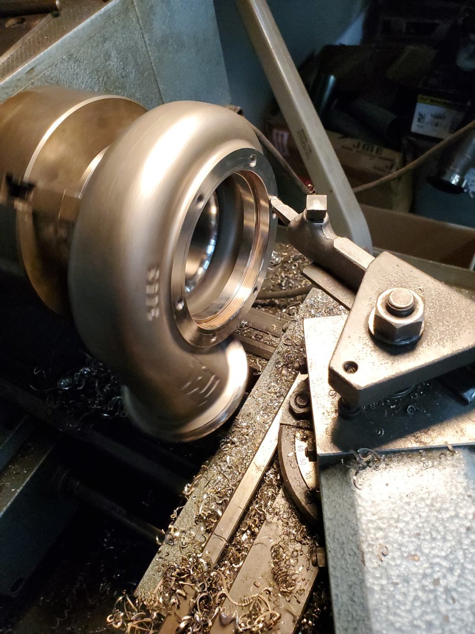

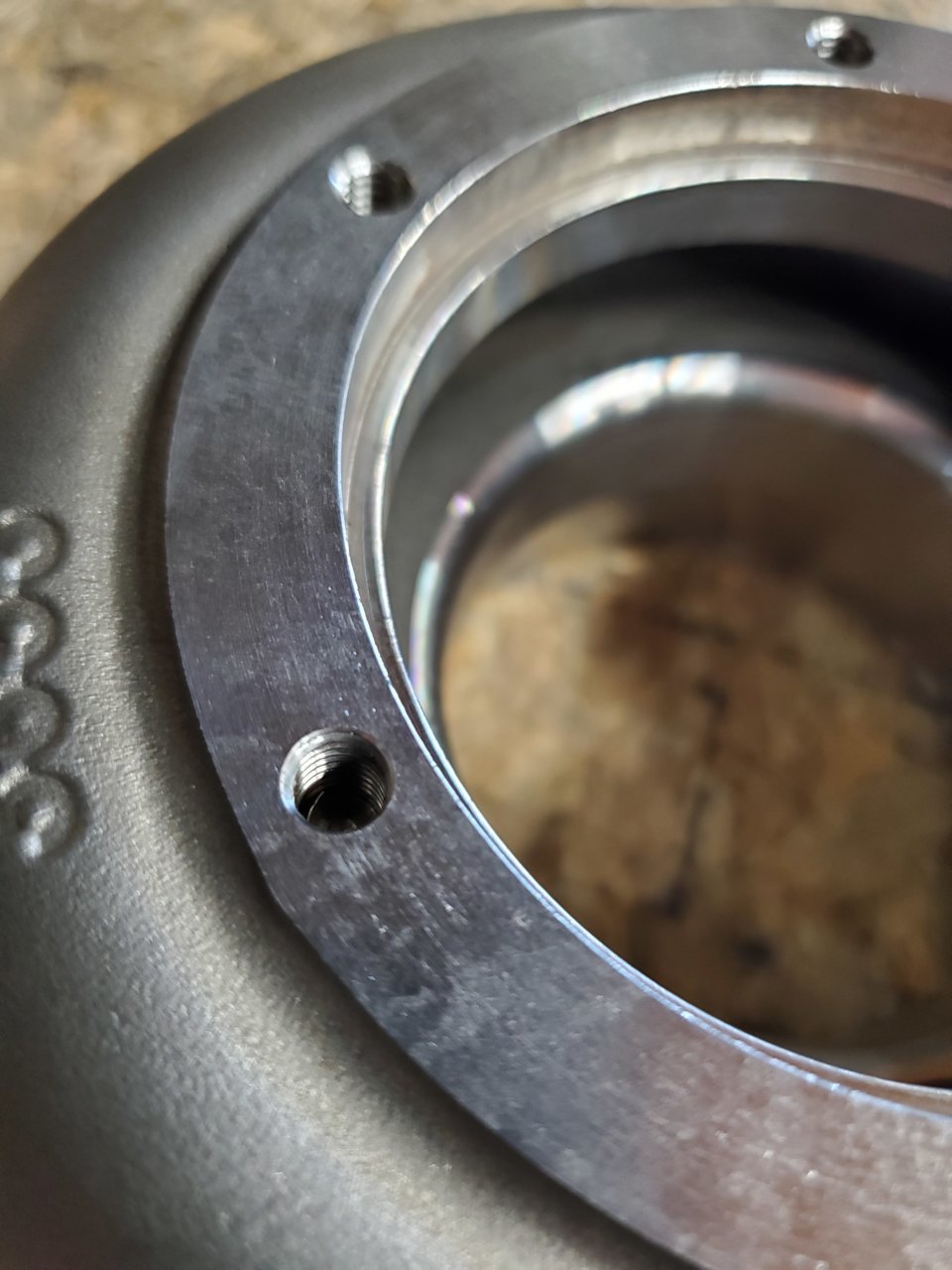

    I was able to machine the mounting surface on the housing this morning. We will see how assembly goes this evening. Pretty much maxed out my little lathe with the weird shape of this. Almost hit the ways and bed as it rotated.

    That must have been a little bit scary seeing that inlet flange flying around.

    Smoother downpipe mating surface as well. That shop did you a solid.

    Properly done! Must have been an intense moment or two, during first start of the lathe.

    She's all back together! Damn that housing looks tiny!
    Just went for a quick drive to the store, no lap top or such. Honestly feels pretty much the same. Wasn't standing on it, but I expected more.
    I think I have too much timing pulled before 3k so its nullified. I'll play with it more in the upcoming days, it's time to relax.
