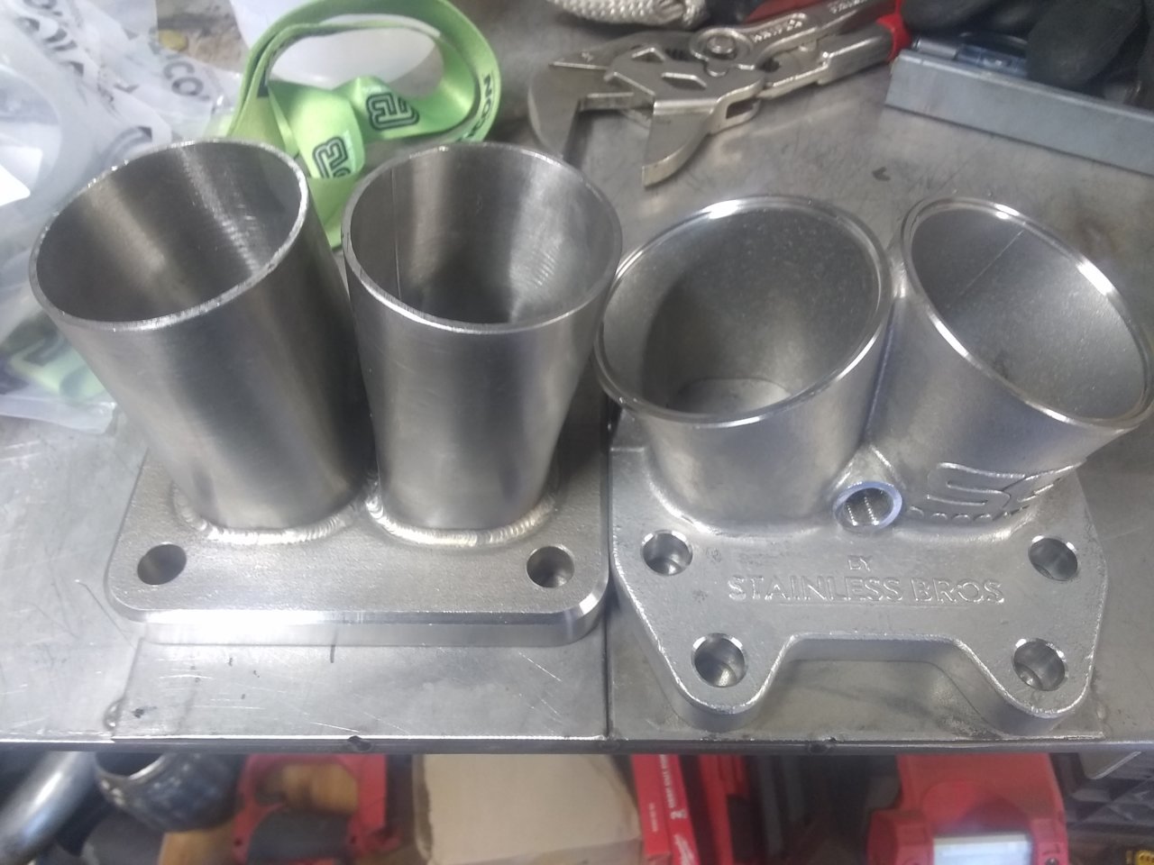

    Alright gents. Throwing the out for you guys. Which one should I do first. The twin scroll flange with 2"inlets, or the twin scroll with 2.25" inlets? Looking to drastically lower the boost threshold. Give you reason why.
    After I finish reworking a major portion of the Bimmer's exhaust, I'll start ordering the material to re-fabricate the header back into turbo inlet.

    Thats a great question. I would go 2 inch to increase the drive pressure if you're looking to lower your boost threshold.

    I vote for the dual 2". It's good up to 70lb/min.
    dual 2.25" is sized for 1000hp build.

    Hmmm. And my turbo is good for 1k, or ~90lb/minute + or minus.
    We could easily start with that.

    Are you doing a smaller housing too?

    Going from the 1.04 to . 90.

    Ok, that is still a good sized housing.

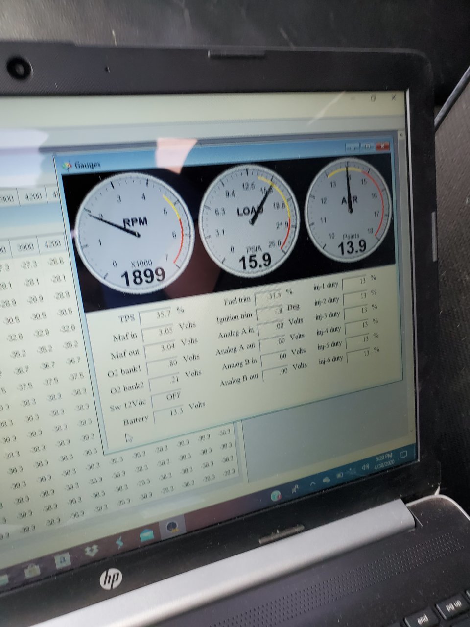

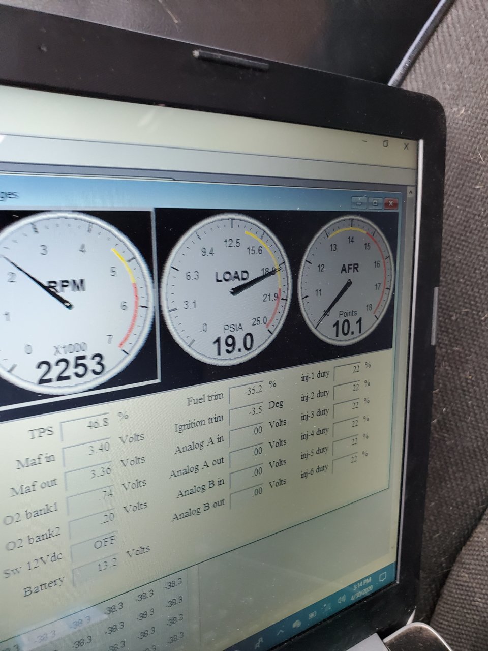

  15. Apr 30, 2020 at 6:12 PM
    Jon64l
    Jon64l Well-Known Member
    Jan 12, 2016
    #174799
    1,632
    Jon
    2000 4runner, 1996 Tacoma
    Finally making some boost before 2k. Fuel map is rich, but that's better than lean. 2 psi before 1900, 5 psi at 2250, give or take. Kinda depends how much skinny pedal at what rpm or it just drops a gear.

  17. Apr 30, 2020 at 6:18 PM
