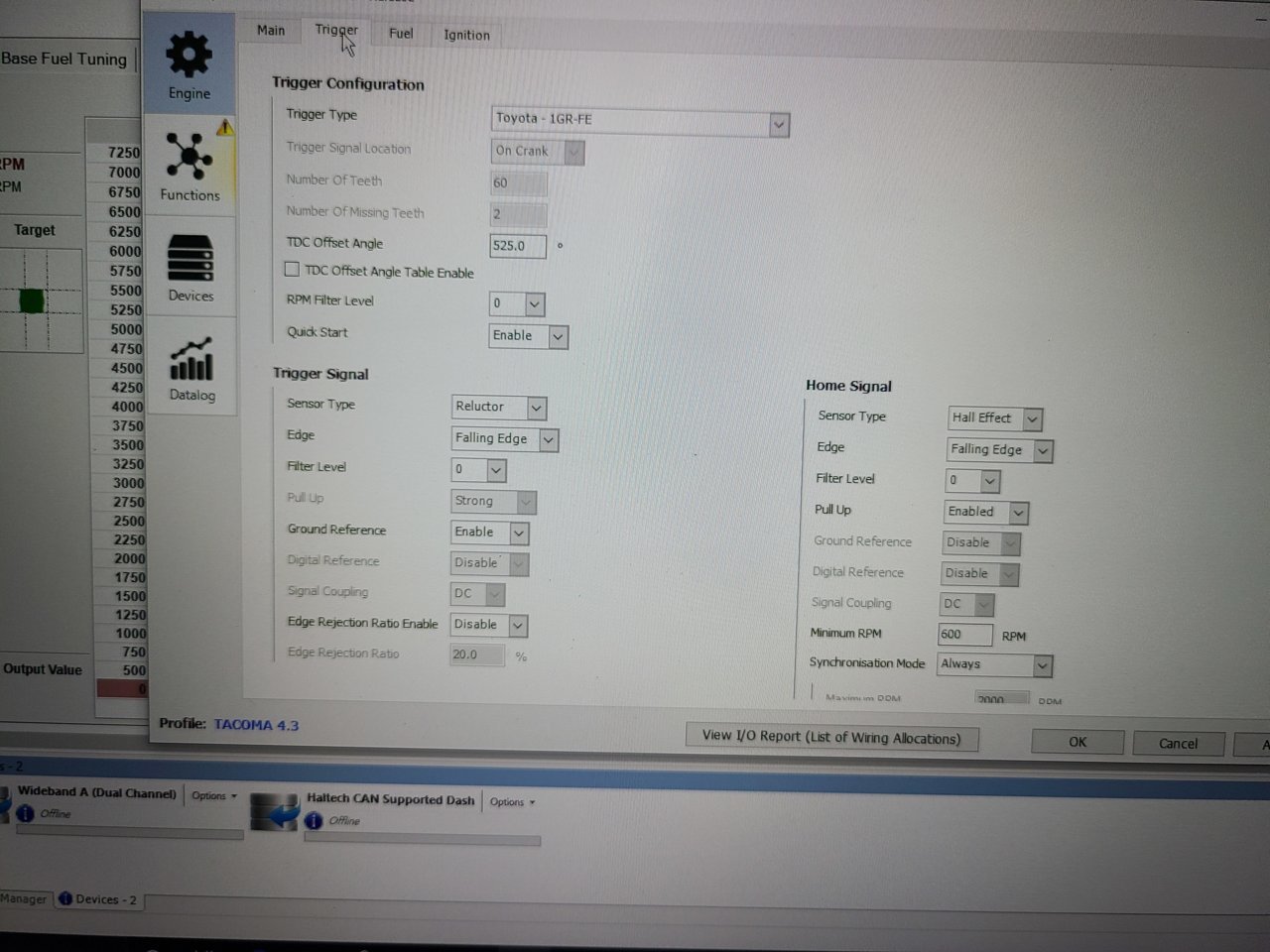

    I'll take a photo of the directions of my sensors, for your help.

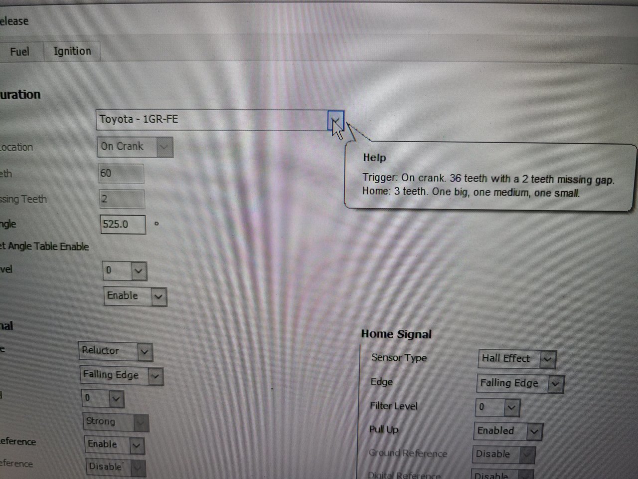

    These should help to reference against yours.

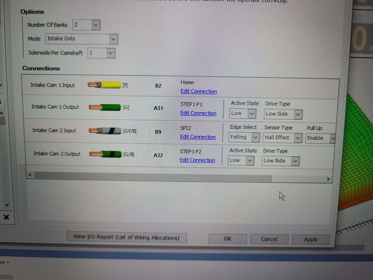

    I changed this value from 1 to 3. Then enabled sync cam count. Only thing I've changed so far. Had to jump over and finish a customer car last couple hours sorry for delay. I just dunno what I'm doing with this ecu so hopefully on the right track. Have a guy helping me earlier today that's tuned lots of high horse hptuners stuff but hes still learning about the aem ecu for me to hopefully road tune this thing if can get it running smooth

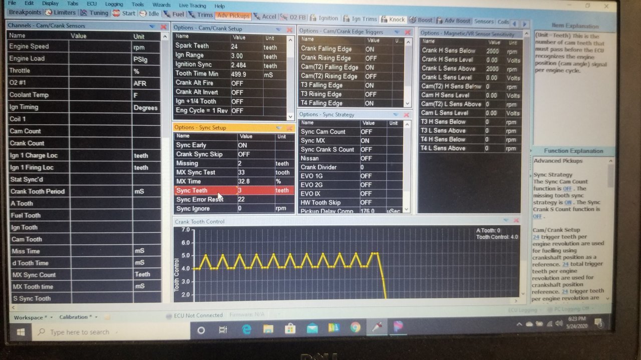

    Advanced options for this look correct also?
