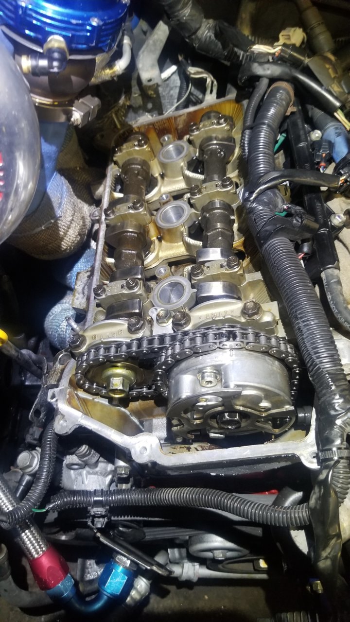

  7. May 27, 2020 at 5:10 PM
    Smittyxr1984
    Smittyxr1984 Well-Known Member
    Jul 1, 2019
    #298023
    109
    2007 XR

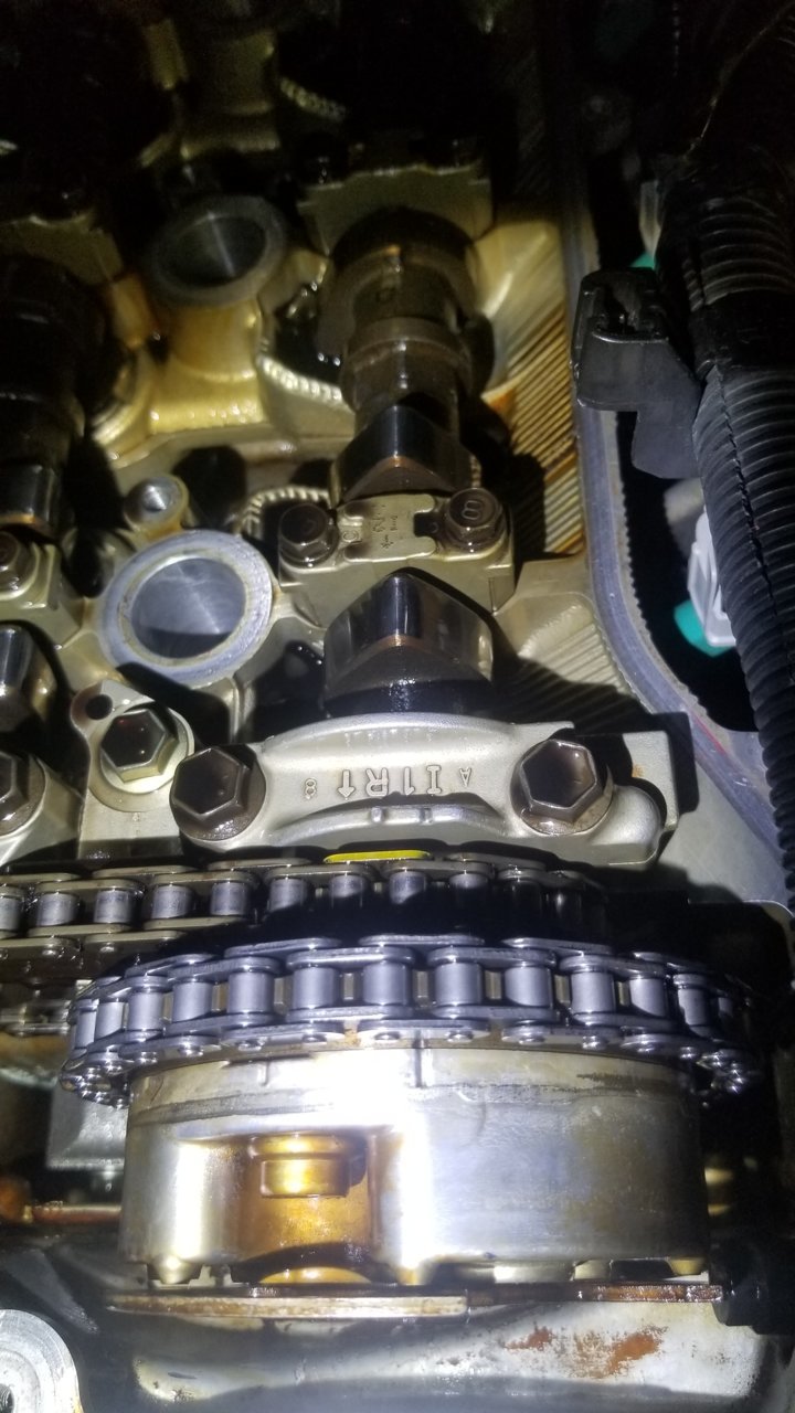

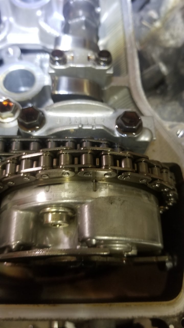

    First pic of dirtier engine is motor in truck, 2nd is old motor. Bank one at tdc. The intake cam position is different I'm noticing... turned old motor over several times and it seems to be in same position every time at tdc. I never had the cam chains off new motor tho so not sure how that intake cam could have been turned ahead if that is the case.
    Either way does that cam position look incorrect or what do you guys think?

    Second picture looks correct. The lobes of the intake and exhaust should point towards each other. On cylinder one. If I remember correctly. I know that there are pictures in my build thread.

    109
    2007 XR
    I agree cams are wrong why that engine not making any power on that entire bank, tore the old engine down to get a better look at everything. Going to start teardown on motor thats in there tonight hafta pull front cover back off again tonight. But going to use cams off my orginal engine. That cam is basically 3 teeth ahead wondering if cam phaser failed or the knock pin for it. I assume that's where to go. Is it possible to remove the cams without removing the front timing cover? That would speed things up otherwise hafta pull everything accessories back off time consuming for sure

    You can pull them. It'd be best, obviously, if you can get both intake chain links lined up properly.
    Loosen the 17 mm intake cam gear bolt.
    Then remove the tensioner behind the inspection cover. Then rotate the the crank juuuuuust enough to get all of the slack on the passenger side. Then remove the cam's bearing caps.
    Have some way to tie off the chain to keep tension on it while the cam is removed.
    Work chain off of the cam and cam out of the head.

    Pretty sure we pulled it off. Gonna torque sequence all the cam caps and roll it over make sure timing marks stay lined up. Knock pin was gone not in cam or phaser. Used cam from old motor

    Well that is freaking out of this world odd! Either way, I am happy that you were able to diagnose the problem. No here's to it purring like a kitten in a short while. :cheers:

    Buttoned up and purring. Time to take back apart and put 1000ccs back in and aem ecu.
