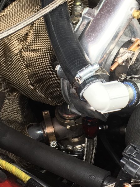

    What is your elevation?
    Most likely the byproduct of your wastegate priority.

    Well it is a high quality one, which is good. I believe a member mentioned that you might have boost related occurances with the location of your WG, in your build thread.
    The "priority" is that the flow should go intonthe WG first, then into the turbine housing. The better it can get to the WG first, the more precise your WG control will be.

    No one has ever mentioned this that I can remember but here is my wastegate mounted on the bottom of the exhaust manifold with the turbo on top I hope this is correct and I got rid of the plastic tubing it's all silicone and aluminum nowIMG_5586.jpg
