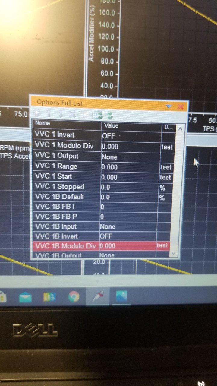

    Using that timing table you sent me last year torspd as a starting point. How much boost were you running with? Tuner thinks really conservative

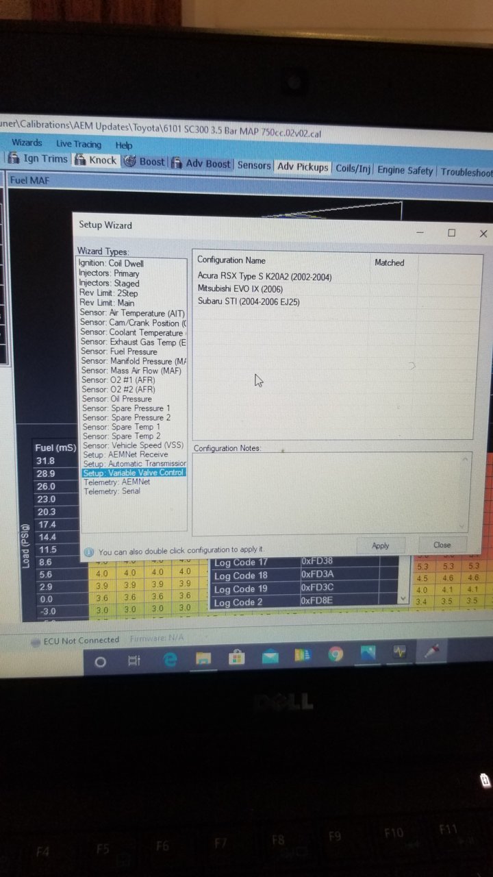

    You have any of the variable valve timing tables from your Haltech?

    If your AEM has any base maps of say the Lexus IS300 with VVTI or 2JZ with VVTI, then you could just copy that over. Very strange that the VVTI maps are identical in the IS300 and Tacoma. Never the less, it is.

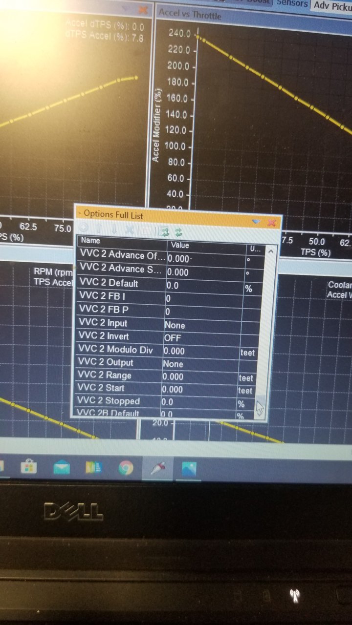

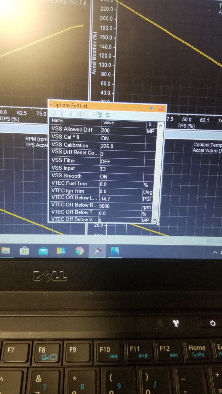

    107
    2007 XR
    Nothing in the wizard for variable timing for vvti. I scrolled those same ones as above in the sample sc300 map and settings are same not filled out

    Would not messing with the tables allow the OEM tune to keep running it like normal? I know that is how it on mine.

    Ran it to 8psi tonight road tuning until rain hit and ended the fun. Had to pull some timing out at first at 5psi but def smooth and more powerful than ever, coming right along. Going to add the meth kit to the mix tomorrow

    What did you end up doing about the VVTI?
    Use the timing map supplied by me as a reference?

    Vvti seems ok not messing with those tables. But hard to tell over exhaust drone with straight 3" to monster muffler. Going to try and get vibrant ultra quiet resonator welded in today. Youd hear the vvti before with my old jba exhaust. Used that timing map pretty exact them worked off that smoothing it. Methanol system kept shutting off giving an error so shut that back off gonna try sort that out today too. It would come on about 4psi for a second than shut off and flash 4 times pump voltage error.
