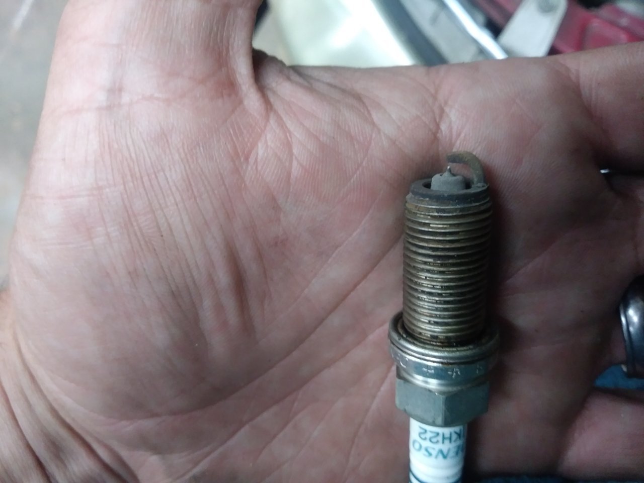

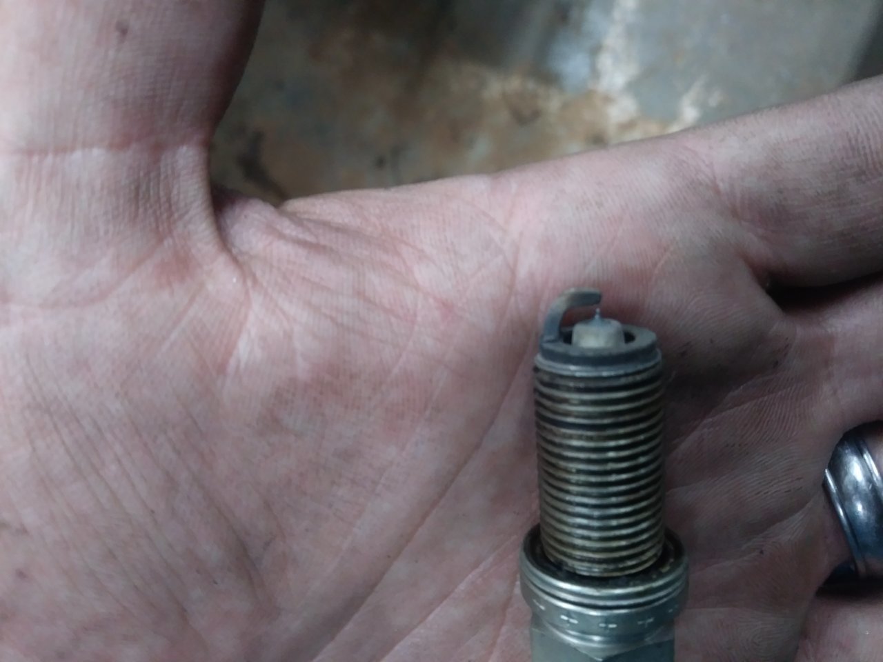

    Well pulled a couple plugs from each side tonight and stuck em right back. For 30k miles and an iffy tune at best for the all of that plus shooting oil in my intake who knows how long... I thought they looked pretty good. Swapped a couple coils from passenger side to driver side to see my bank 2 rich issue followed but at least after 5 miles it doesnt seem to have. Also I must of been trying to pull myself up to see over my phone and check my speed and laid on the horn a bit haha https://youtu.be/krjacX4ZDzc

    They've had a rough life and still keep working. How well might it run with a new set?

    Not sure... But they definitely werent causing my issue and that was the main point of this wellness visit... I guess my next option would be to swap injectors around and see if the issue follows... One of them could be spraying too much maybe? There is now way to tune independently around that either if I pull fuel to correct bank 2 then bank 1 goes lean.

    Having them cleaned and flow tested makes sure that they are as close to possible as can be, since you cannot individually cylinder tune.
