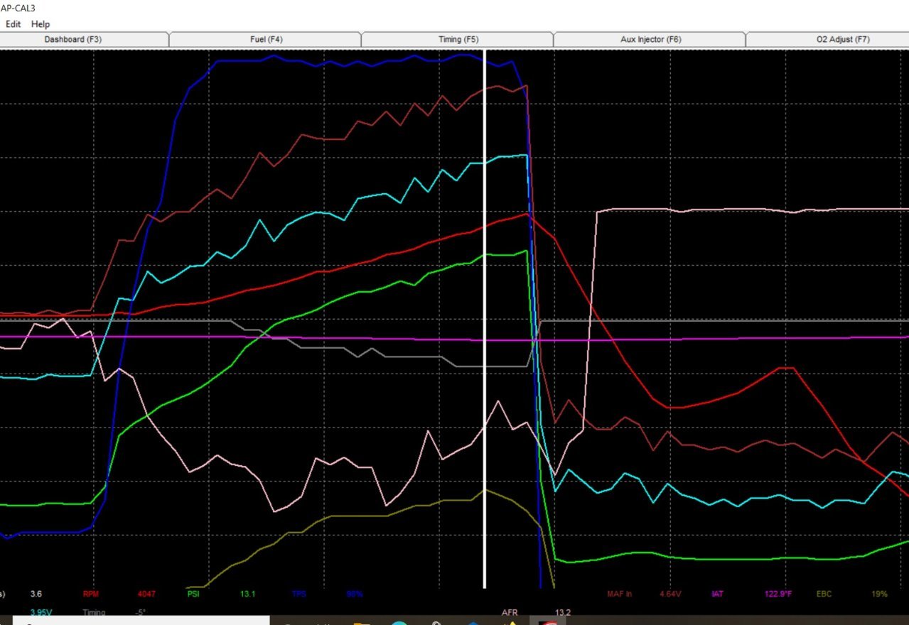

    10 or more pulls later and 10psi is dialed in. So I tried to up the boost to 12psi. Took me a while to figure out how to get the EBCS to work with this new wastegate. Did a quick test pull to see where I'm at. Man that was scary. Only did a 3k to 4k pull. Overshot to 13 psi and my afr's went very lean. Had a 14.0 spike at the end. Adding boost takes a whole bunch of fuel. Fattened up my fuel table like crazy and pulled some duty cycle from the EBCS. I need more gas, so I'll test it in a few more days. Mexico could use a break from me at the moment.
