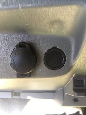

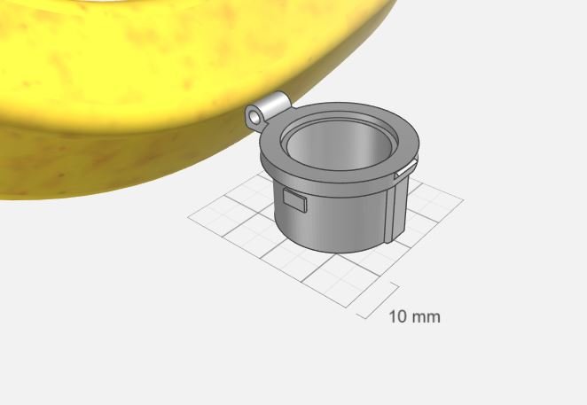

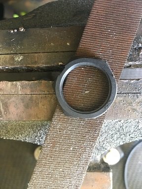

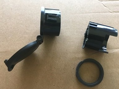

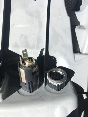

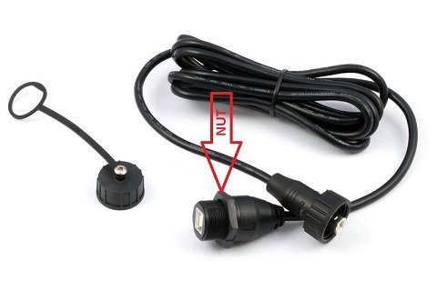

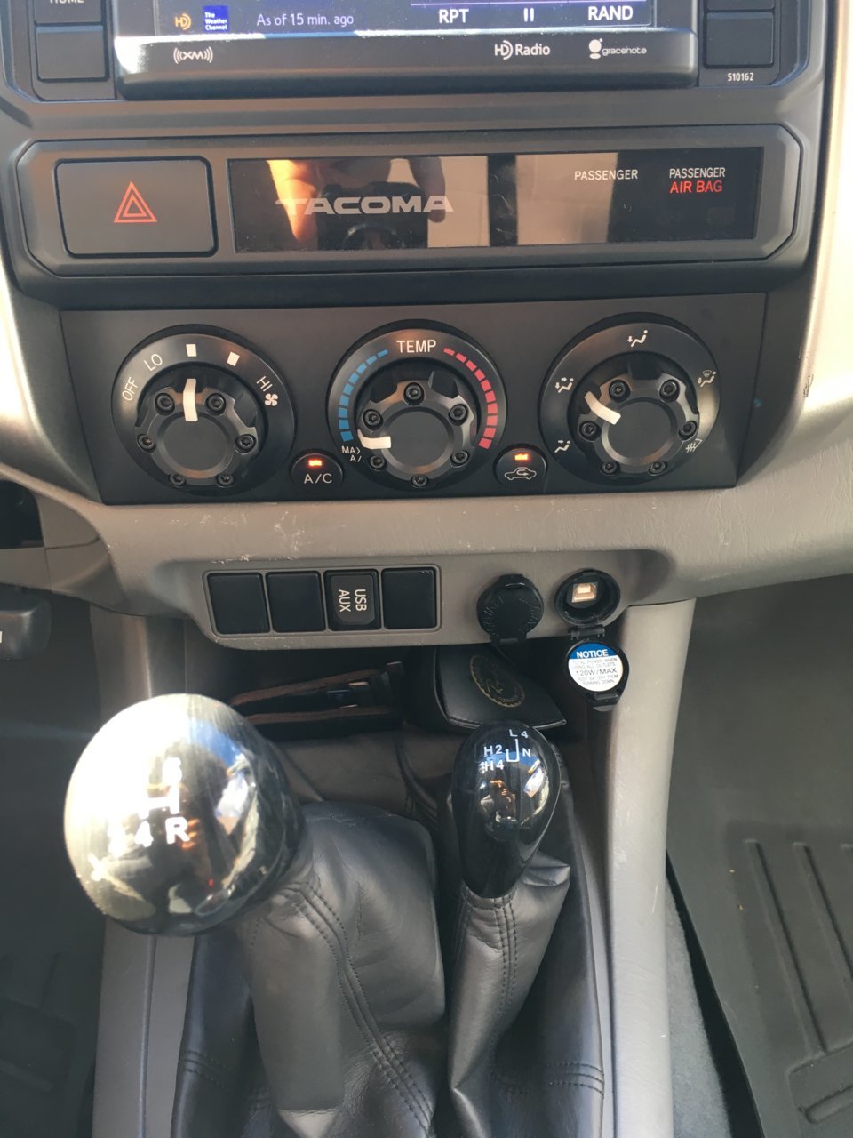

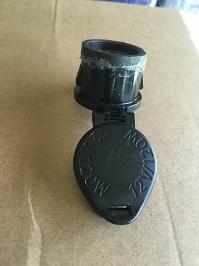

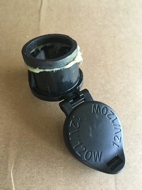

    So the epoxy gave and the wire that connects to the computer is dangling through the hole, if I pull it out I've lost it until I disassemble the dash so I'm leaving it as is haha
    Of course my solution is a custom machined piece.
    The threads will be machined directly into the hole so the cable simply screws in, I just have to transfer the door

    Got any pictures of the other end plugged into the Haltech? I am curious of this.
    I also am curious to see your finished product. 3D printing ABS plastic, or machining a metal piece?

    The second pic in the my old post quoted has it, I haven't taken a pic. I can't CAD threads, very difficult for noob like me, so I can't have it printed.

    Printing threads is hard. Post process threads is easier. I’ll print out the female minor diameter and just let the male side do a self tap. Sometimes you need to bore it out or even add a taper to the ID.

    Yeah I would think a tap and dye set would be easier

    I had thought about that but I don't have the tap I need and there's a minimum order amount so I'd have paid way too much for a $8 print, unfortunately I didn't have anything else to order at the time.
