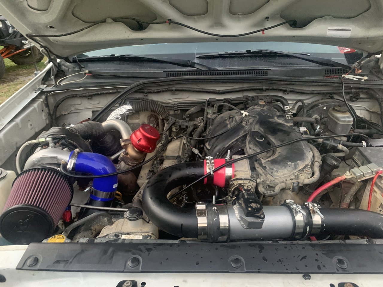

    Was told by torspd to share my turbo build here! T3/t4, 38 mm wastegate, running 6 psi, budget build. With everything I’m about $3000 deep into it. I know the welds are not pretty but only have a mig so it was the best I could do.

    I love budget builds! Nice job. You didn’t want to use a 3” 180° after the maf to the tb?
    What are you using for tuning?

    Got a good deal on 2.5 inter cooler piping so just used that, and bought reducer couplers. I am using HP Tuners for tuning, JustDSM flashed my ecu with s/c calibration and tuned it from there.

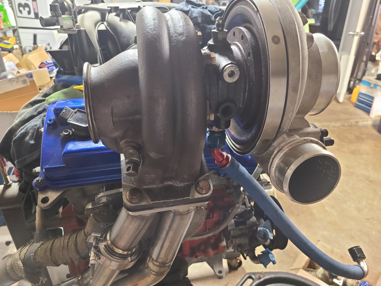

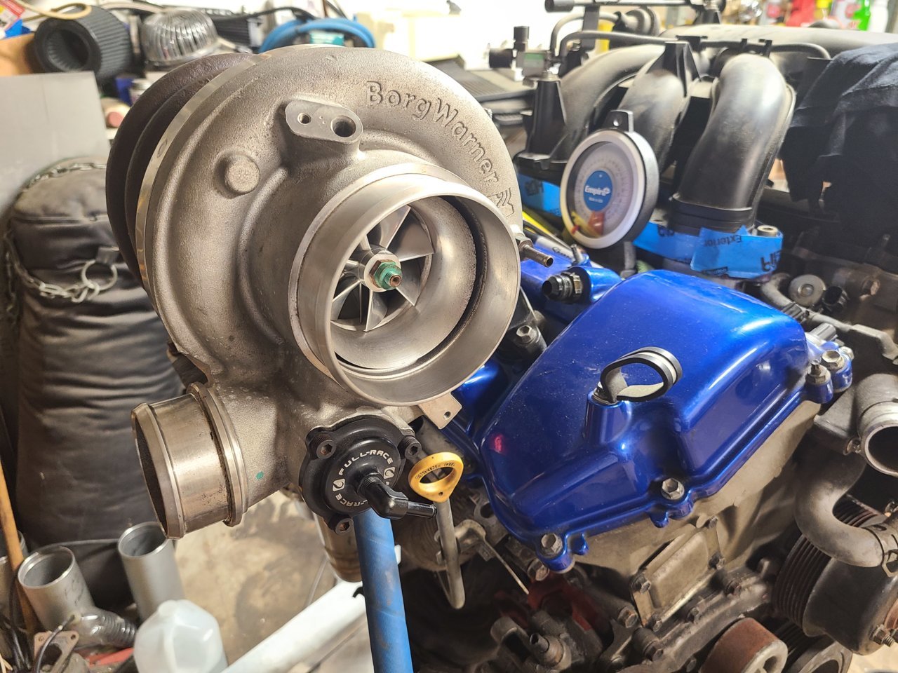

    Decided to start with the 2", @MadTaco461 . My last week's progress.

    Tighter A/R, than with the non wastegated housing, and now twin inlets. Should lower the boost threshold nicely. That is the hope.
    Yes, it is tight to get the dip stick out. It does come out without a fight though.

    I like it. You've come a long way. That is a really tight fit. How you do the 2" to the flange match?
