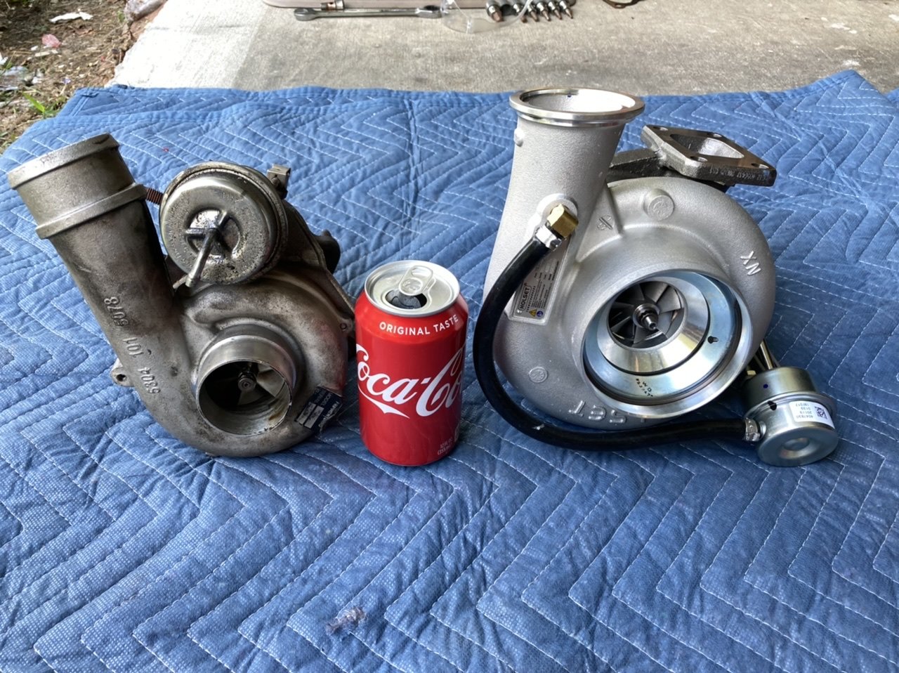

    Not Tacoma related, but....I finally got my new Holset "Super" HX30 on my VW 1.8t mounted, running, and downpipe made. It'll easily hold and carry 30psi to 7000rpm, too, and it's also seeing positive boost before 3000rpm. Super excited to get it dialed in but need a new o2 since the coolant and oil blowing out of the previous snail's death killed the sensor.

    What is a super 30 rated for?

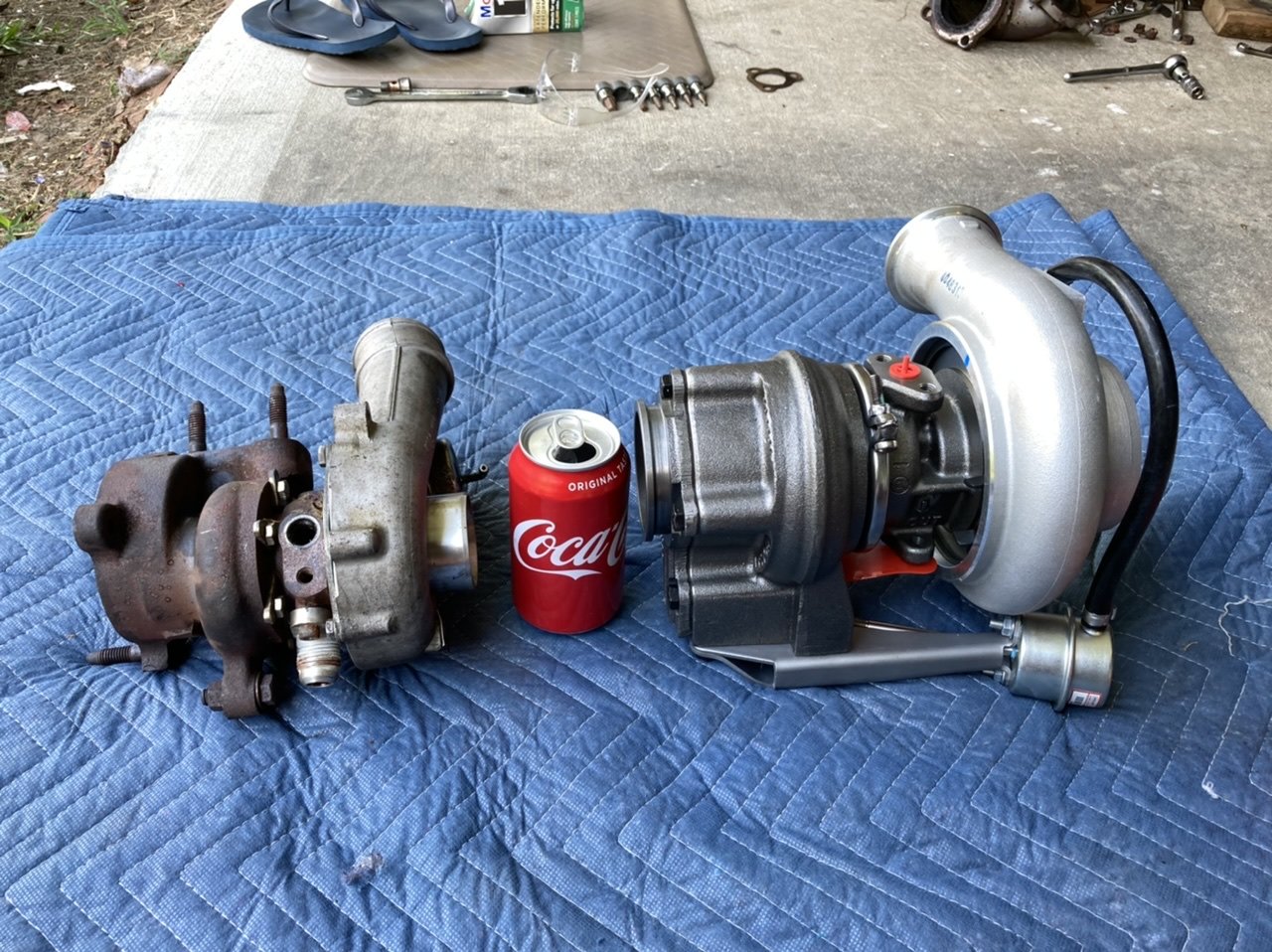

    Find a true graph on a HX30 and I'll tell you. Holset website says .35kg/sec. Which is about 46lb/min. But mine has a larger compressor. 78/46mm vs 71/44 for the regular. It may do a 2rz good but I wouldn't put it on anything bigger. HX35 or a 40 would do well on the 3rz, IMO. HX35s come in around 4700-5200 on the 1.8t. These Holsets are for high boost applications.

    Old one is an Audi sized k04 with hybrid turbine and compressor blades. It’d do about 18psi at 6800rpm. Wheezed out and blowing hot air. Having the bigger, more capable unit blowing cooler air is already a noticeable difference in the ass dyno.

    im happy with my 55mm turbo on the 2rz. It’s a bit late but I’m sure getting away from the piggyback will help with spool. It does make a grip of torque down low. That holset can push some air. Good medium turbo for your motor. I’m assuming you are running e85?
    I had a Mazdaspeed3 that k04 was a pile. Hit like a brick but dead at 5k.

    Stock was a k03s. My year model was factory 10psi. It would struggle to hold 10psi at 6500rpm. Then I got a tune and it’d spike 20 through the bottom/mid range but fall flat on top end. Then the hybrid set at 22psi and it would wheeze out around 18psi or so. Now this one which comes on slightly later but will hold all the way across.
