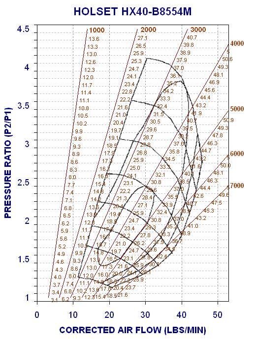

    Beating a dead horse on the Holsets but there’s a good thread I’ve read several times over on VWVortex. This guy mapped a 2.2l onto an HX40 graph. 95% VE is what he uses. 2164cc to be exact.

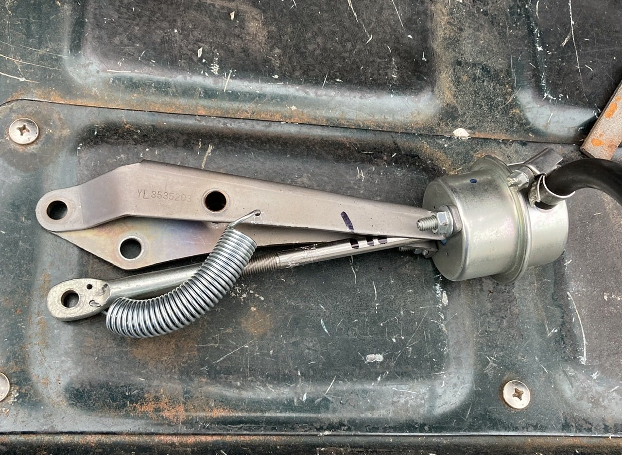

    Every gasser running high boost on a Holset has complained of boost creep. Mine loses boost the higher it goes. I have determined that the exhaust gas is pushing the internal WG open in the higher RPMs. Sort of like assisting the actuator. I could crank the actuator tighter but I’d suffer the boost creep by limiting the throw of the gate. So I went old school and did a spring mod. This spring has a “4.75# SWL”. WG set at 32psi wasn’t enough so I added this spring with little to no tension on it. It got me to 28psi and held to 24psi. Exact setup without spring it was 23 and 20psi.

    Bravo. Just needed a light spotter it seems.

    Good idea. I did the opposite when I ran an eBay turbo. I had a compression spring to bring 9psi to 5.

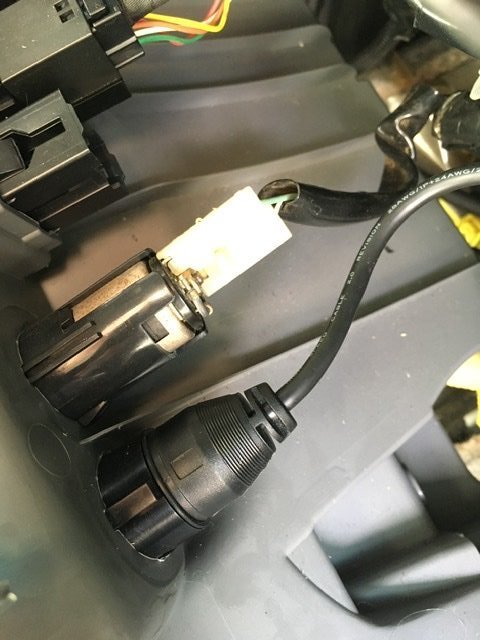

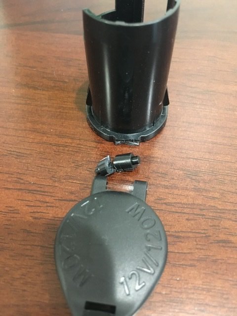

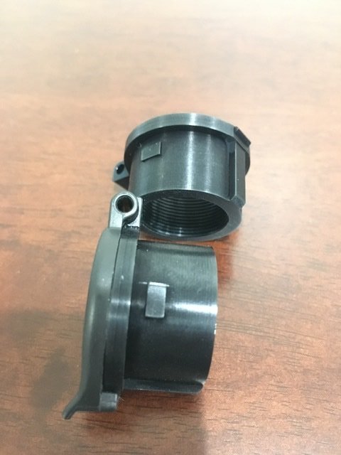

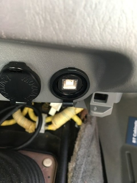

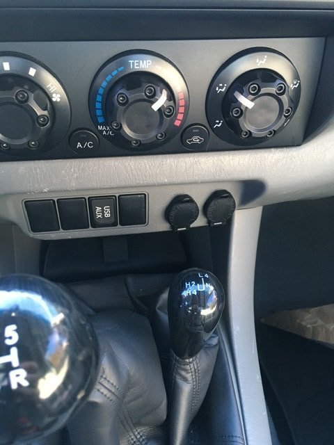

    This came in while I was away, couldn't be happier how it turned out

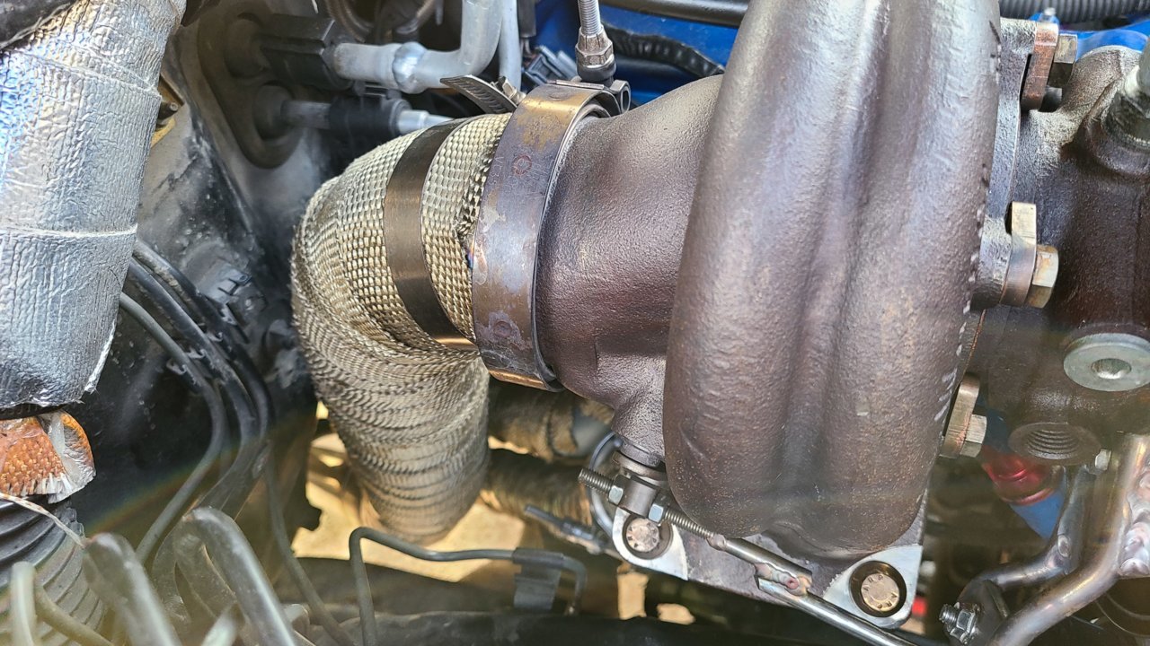

    Charge tube finally finished! One more piece to go.

    Ooh, I like that. I have to open my glove box like a Neanderthal.

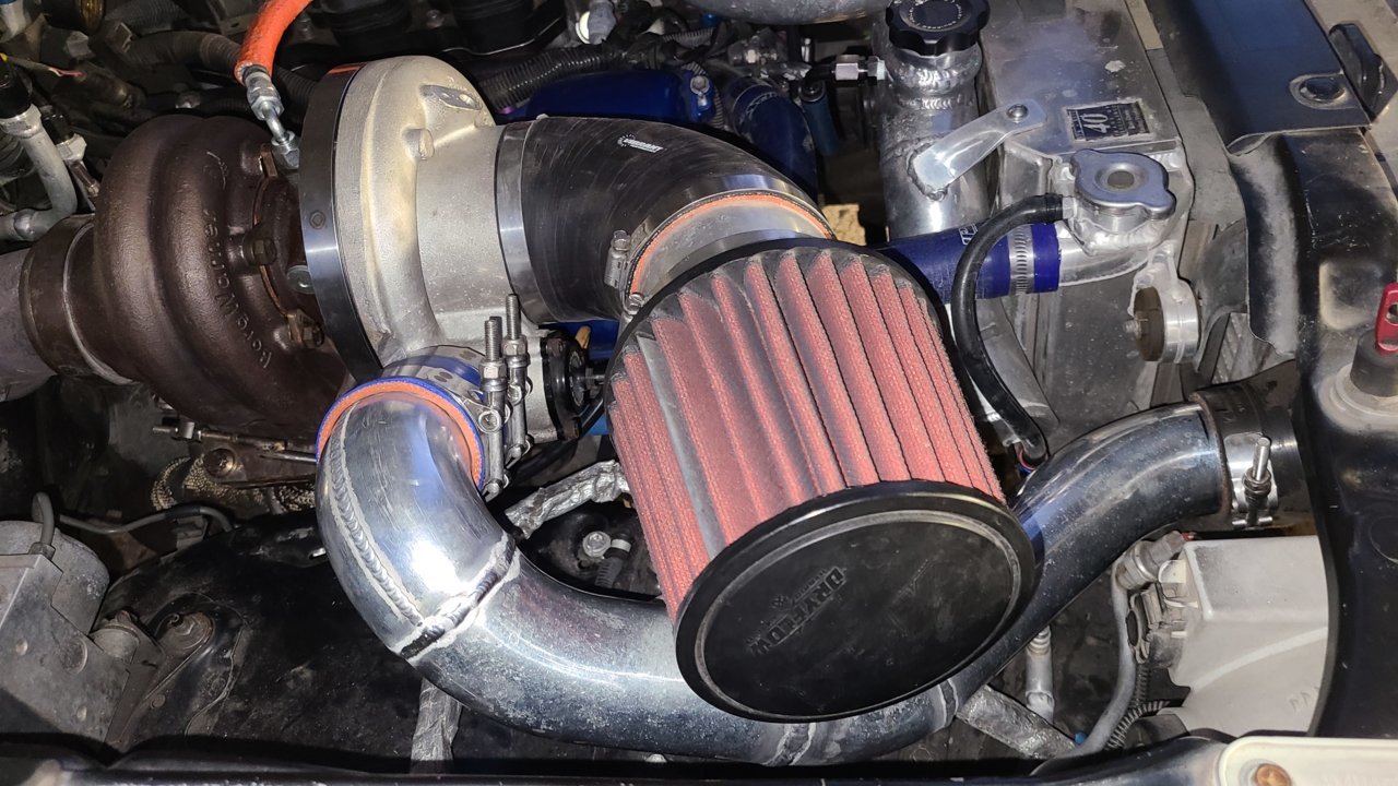

    All finished gents!

    Like complete complete???

    Except for the tuning, it certainly is. Love the way it performs now.

    This revision came together pretty quickly, considering what all was involved, in the free time that I had.
    This next week or so, I'll datalog and go through the tune, and fuel it up. Then I can get at least one video for you guys!
