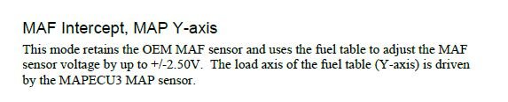

    Evening gents, i have a MAPECU3 question regarding MAF intercept, MAP Y-axis mode.
    I have been noticing in my datalogs that the MAF is pegged at 5.0v above around 5200rpms. While reading through the owner's manual it mentioned the ability to adjust the MAF voltage by up to +/- 2.5v. Does this mean it can provide additional fueling above the 5v mark up to the equivalent of 7.5v at the MAF but it continues to only shows 5v? it makes sense how the MAP sensor covers the load axis of the table but I am having a hard time wrapping my head around the voltage aspect of it.

    My interpretation is for the ECU to add or subtract 2.5v it would need to be able to control the supply voltage. If it won’t read any higher you’d need a larger housing and scale the fueling to match it.

    The software can add or subtract up to 2.5 volts from your input MAF. For example your input is 3 volts from your sensor. You can enter in the table any range of -2.5V to 2.5V. Your output to the ecu must still follow 0-5V. So 5.5V MAF out will not work. So 5V in and table +2.5V to make 7.5V will not work.
    I have large injectors. I rail out the MAF at 5V around 4600rpm at the sensor. Since my injectors are larger than stock all the table values are negative. For example one of my cells is at -0.7V assuming I'm at 5v maf input. The MAF out to the ecu only reads 4.3V and the motor is still happy.

    Okay i had to reread this several times, but i think that makes more sense. So this would be the reason why it's not recommended to go more than twice the size on your injectors with the MAPECU3 right? If you do then you risk the ECU not being able to pull enough fuel at idle bc of that -2.5 limit? If i'm off on a wrong tangent please let me know ha
    That was my understanding as well with a standard ECU. I wasnt sure how a piggyback ECU with a MAP sensor too would be affected though. I really would like to avoid going up an intake tube size if at all possible.

    There a few holes in the instructions that assumes you know tuning. The 2x size limit is mostly because as you increase the size of injectors your fuel trims will have larger oscillations in closed loop. Mine holds pretty clean for going 2x larger, but it feels like this is all it can take.
