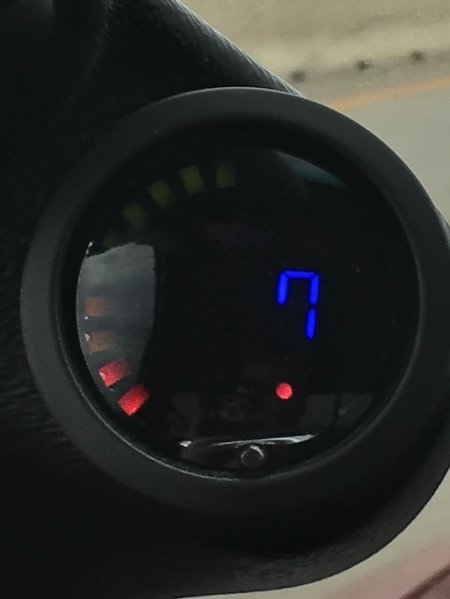

    I've been putting this question without any response maybe I haven't really asked directly but here goes a spring in your wastegate rated at 5.8 let's average at 6psi is there anything that would increase the psi with no boost control

    Thats only a 3% difference can u really even tell that on ur boost gauge?

    What I mean is the spring is 6 and the gauge is at 7-8 :)

    Is it a tial spring or are u still using an ebay spring?

    Its a tial I finally spent the $265

    It must be the gauge :notsure: so when it was hitting 11-12 psi it was really 10

    When the truck is off is the gauge at 0? Or does it sit at 1-2 that might be a good indication that its not calibrated correctly

    Sure. If your vacuum hose to the waste gate is pinched or clogged or has a leak or fell off, the WG won't open or at least not as its supposed too.
    But neither of the two will be %100 exact either way so I think you're good. I bet that gauge rounds up.
