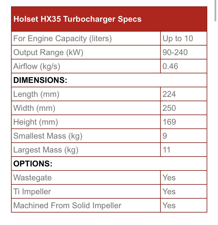

    I've got the 2.7, aiming for 25 lbs and ~500 hp.
    I'm not sure how a turbo designed/aimed at the 4bt would react to the gas engine in terms of spool response. They also seem a bit on the small side for what I'm looking at trying to do I think. But I haven't had time to research them that much so I could be wrong.

    The hx35 and he351 are both more than capable of moving enough air for that.
    05Taco4x4 likes this.

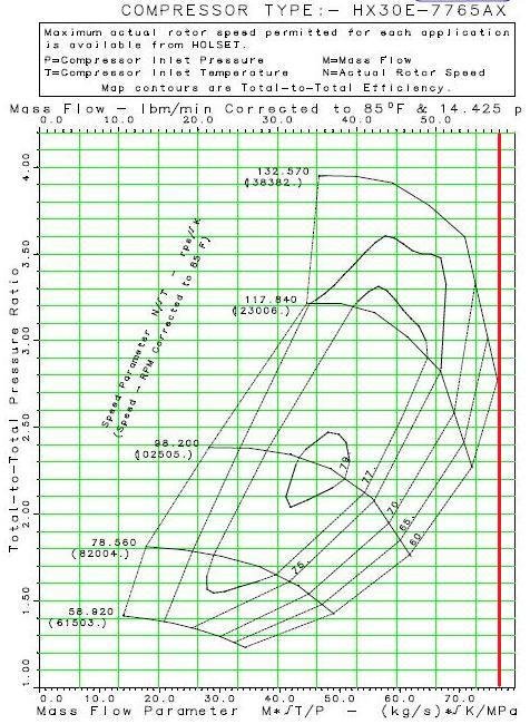

    The top measurement is lb/min. The left side is a ratio. 2.5 is equal to 2.5x bar minus bar. 2.5x14.5=36.25psi then take away an atmosphere of bar for a boost reading of 21.75psi. So for 25psi and 500hp you want to be flowing at 2.72 and 50to55lb/min. Just on the edge of the efficiency island of this map. The key is finding out what your motor and head can flow. If it can’t flow 55lb/min then you can’t make the power but you’ll make a lot of boost. If it can flow that much or more then you can make the power but not the boost.
