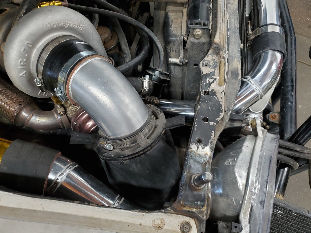

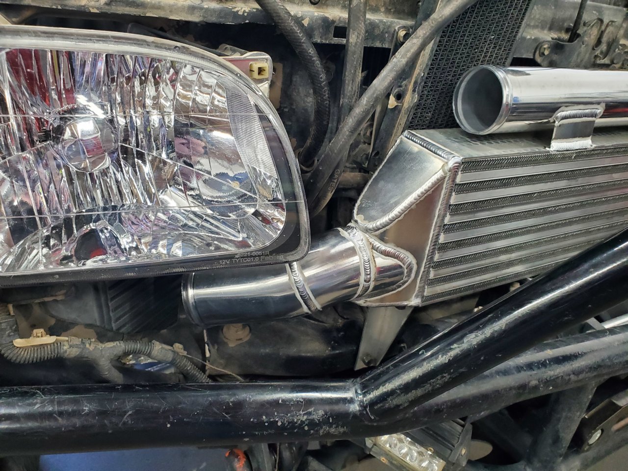

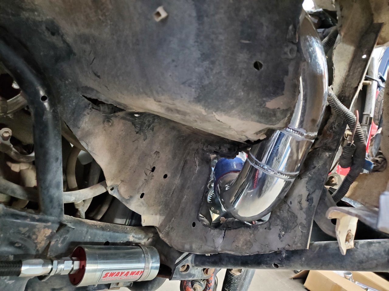

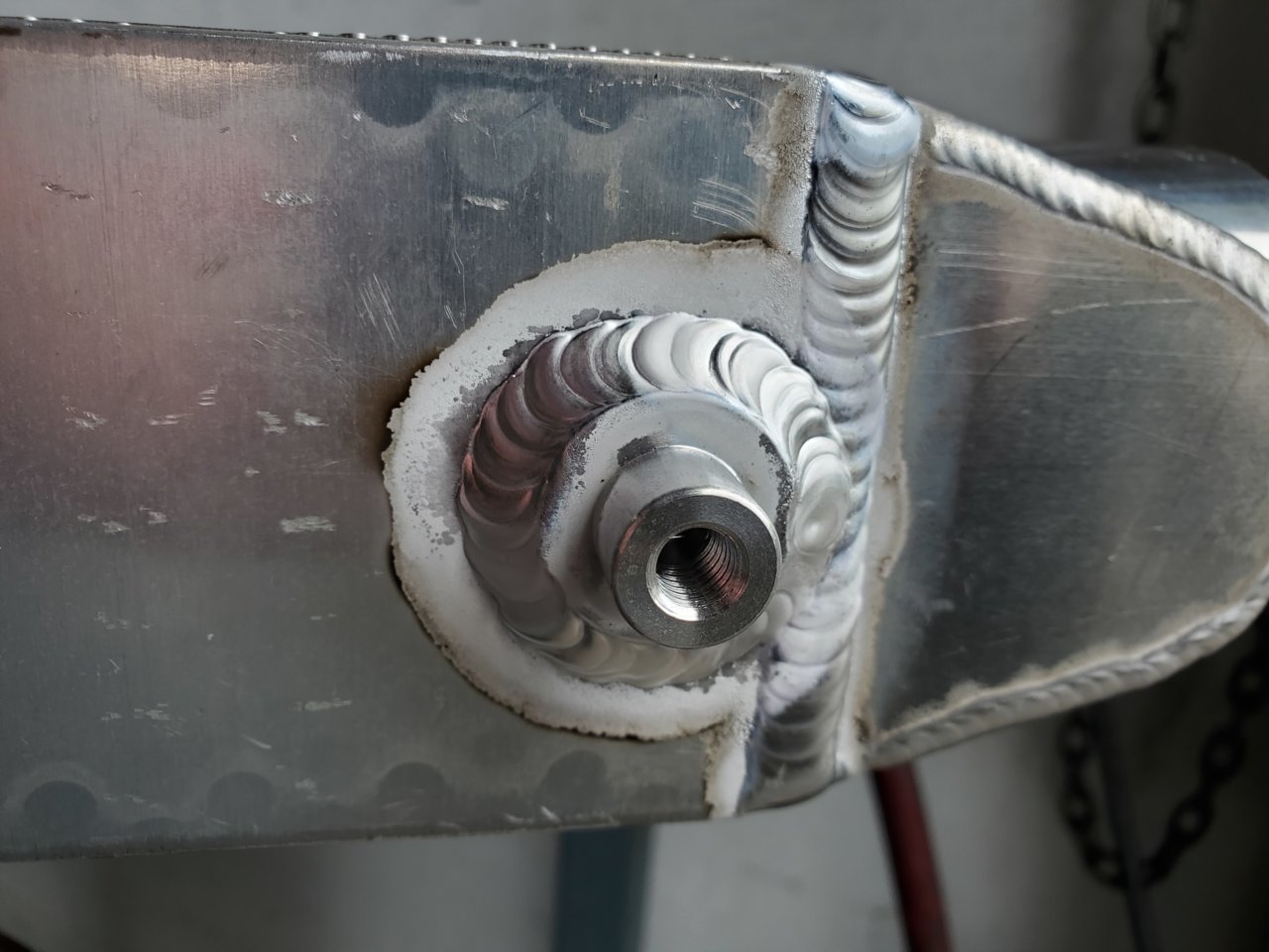

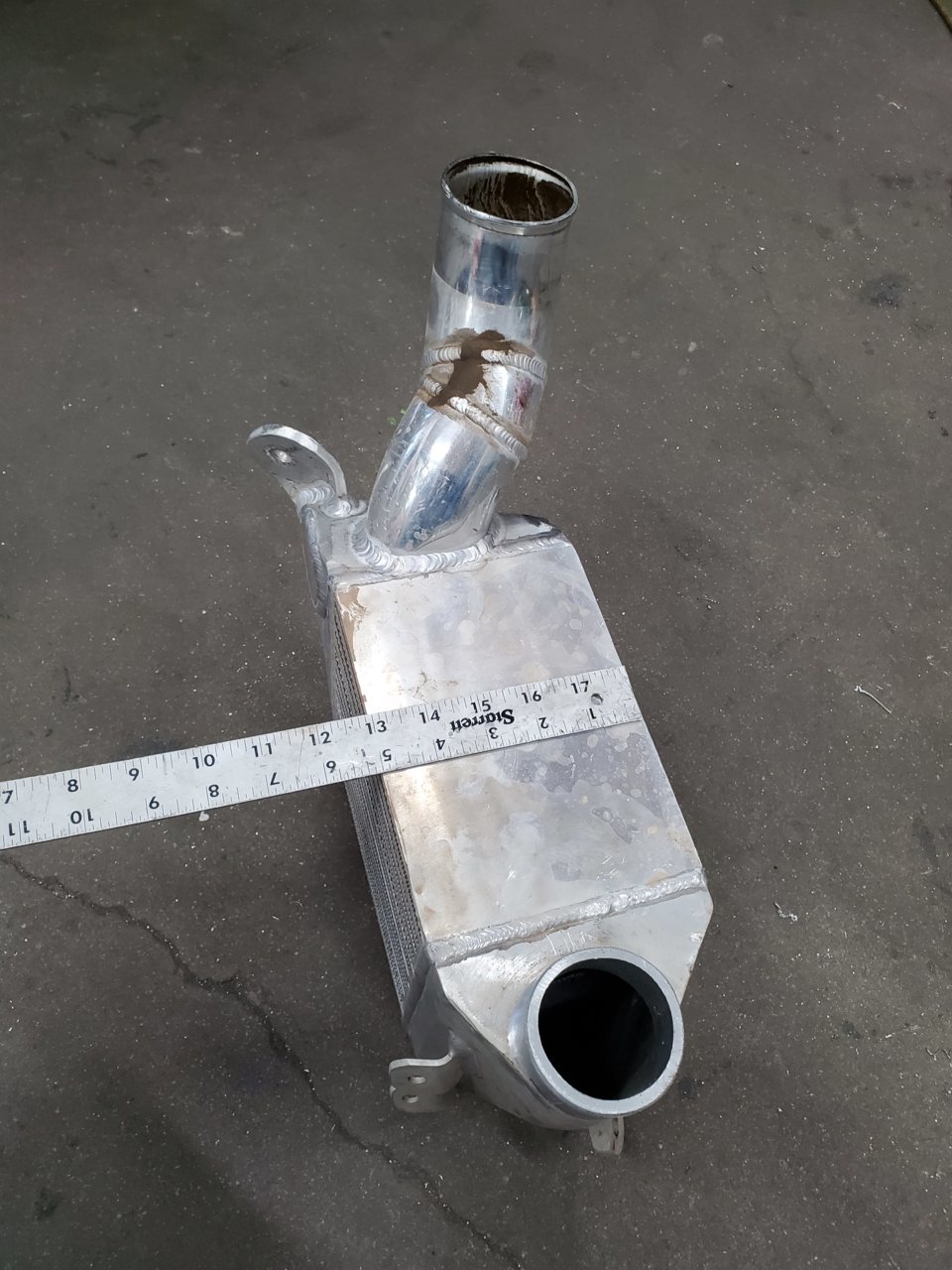

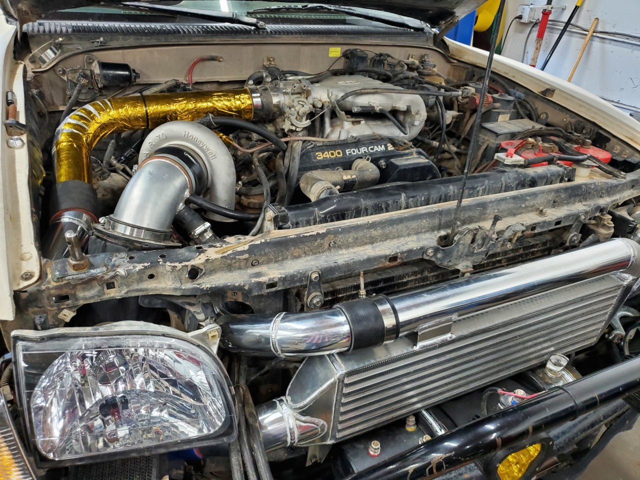

    20201231_144700.jpg 20201231_155114.jpg 20210102_145707.jpg 20210102_170512.jpg 20210102_170522.jpg 20210102_170528.jpg 20210102_170458.jpg
    not_nick, sd619, Brake Weight and 5 others like this.

    I'm really curious to see what your IAT is going to look like... that filter looks really close to the header imo

    The header is all under the turbine and back from there. Soon to be ceramic coated. There is not much room to put the filter anywhere else.

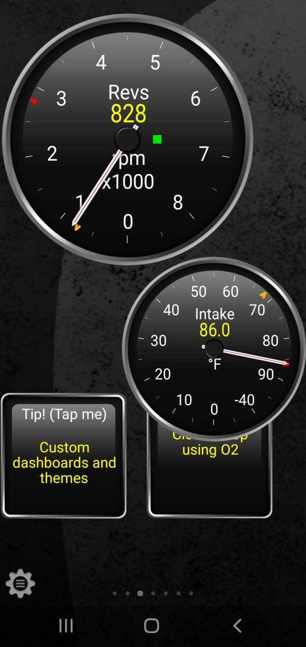

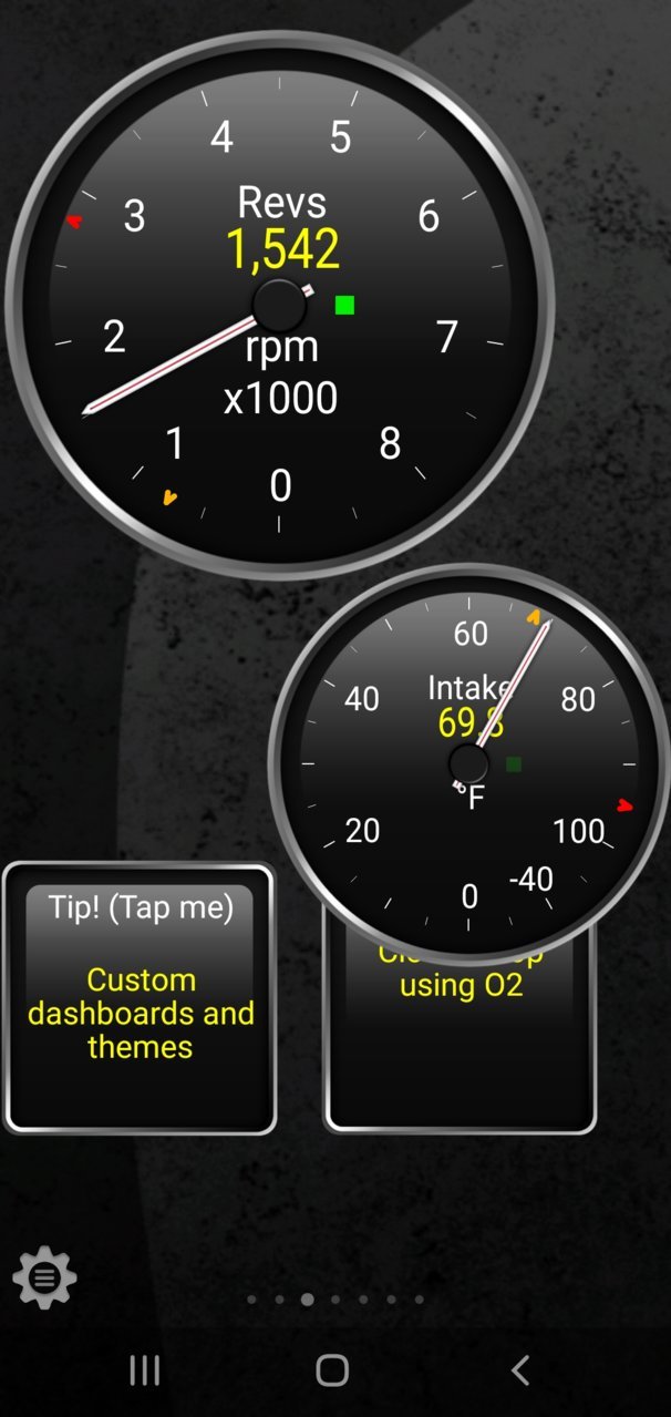

    I have some screen shots of Iac temps with the side mount on a cloudy 60° day. 20210102_170729.jpg
    This one was a 2nd gear pull to 5k, peak temp was 105°
    This one was sitting in the drive thru, no airflow thru Ic so temps got up to 85°
    This is after a few minutes driving normally after sitting in the drive thru. Temps got down to about 67°
    Should be interesting to see what temps are with the Fmic. Bigger better core, fresh air, and a fan pulling behind it at idle speeds. Can only get better from here.

    You run cooler than me. I'm sitting around 100f and heat up to about 120f. A bit cooler in the winter

    Not much left of your inner fender either at this point! I'm looking at a couple options and hoping to avoid cuttin holes in fenders, but if it has to happen, so be it.

    Is the direction of flow going to be turbo > top tube > intercooler > intake manifold?
    Regardless, it will be very appreciative of the added airflow, and less dirt/debris from the tire.

    That's the way it looks to me, and I agree with it being happier out in front and away from the mud slinging
