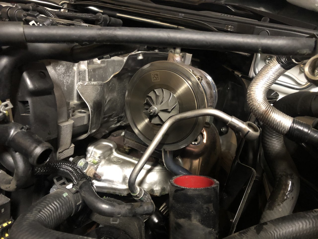

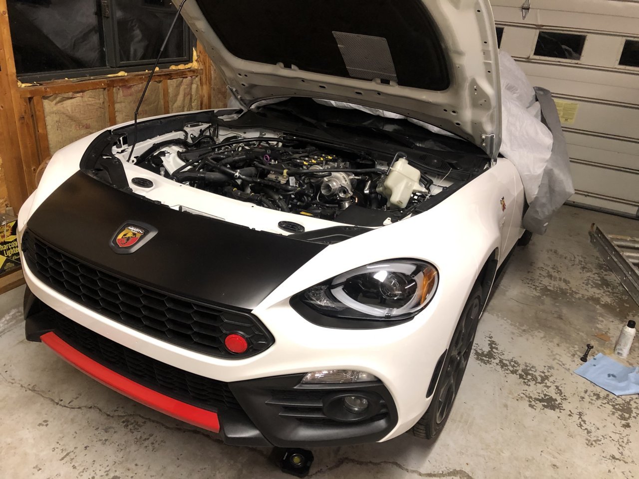

    Doing the big turbo upgrade on my roommates fiata tonight. Going well so far.
    C5F8FDF3-AEAF-4543-970B-BFB1EDE7CE0D.jpg 50150360-B1BF-4928-8A3E-F789F8F42BA8.jpg

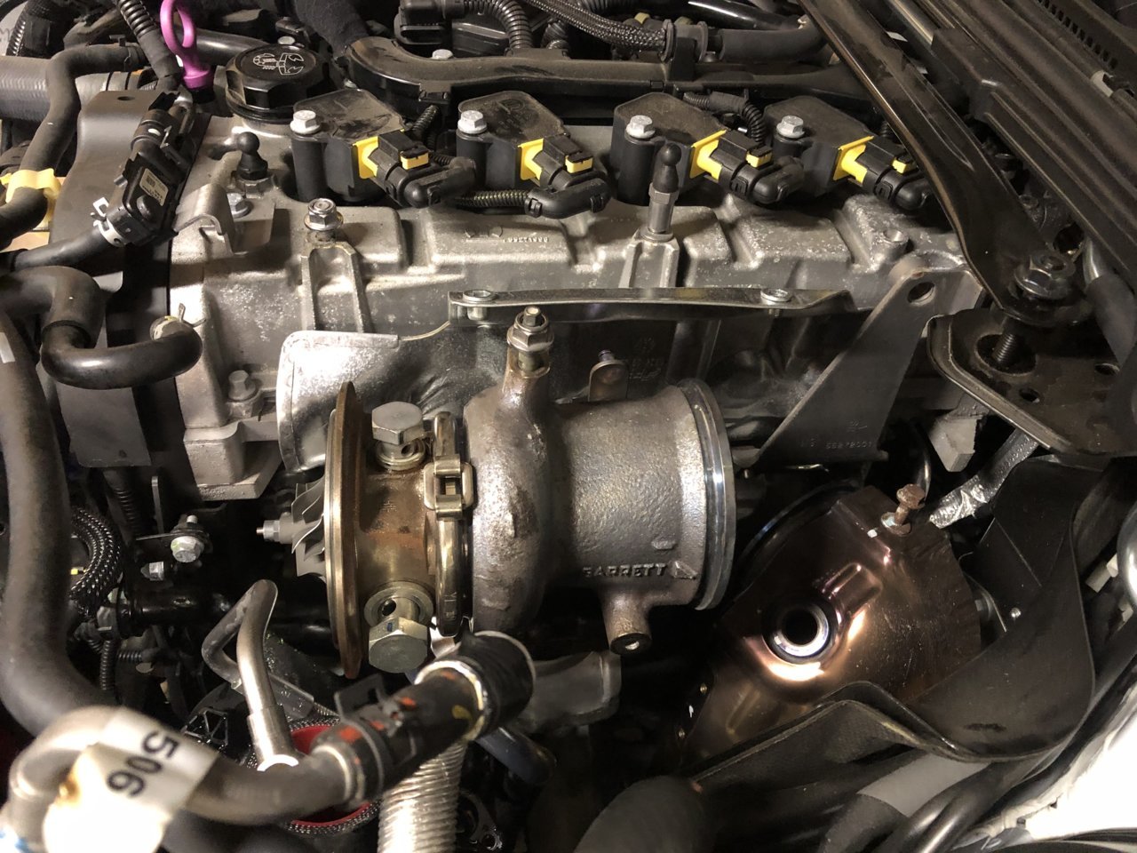

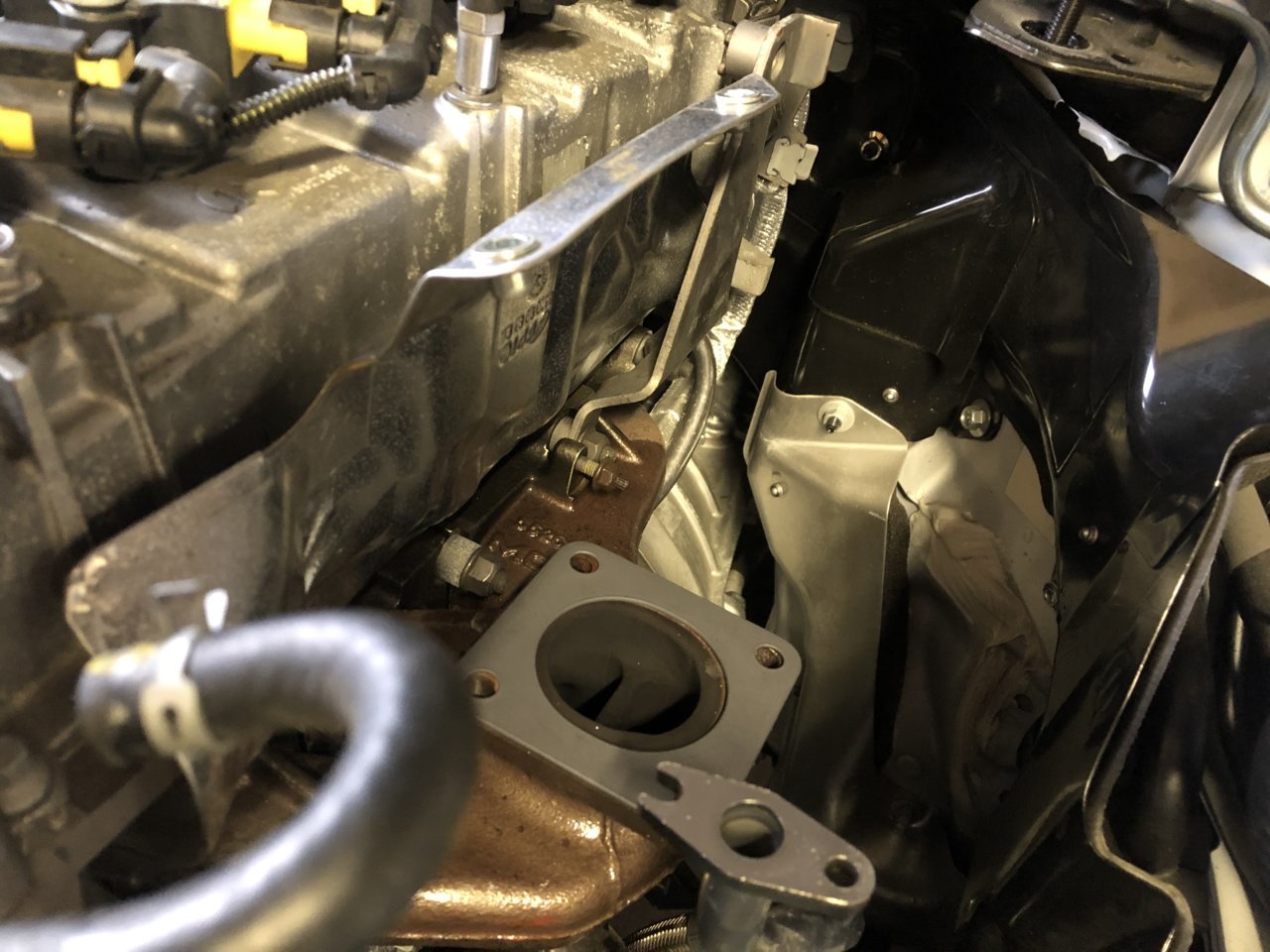

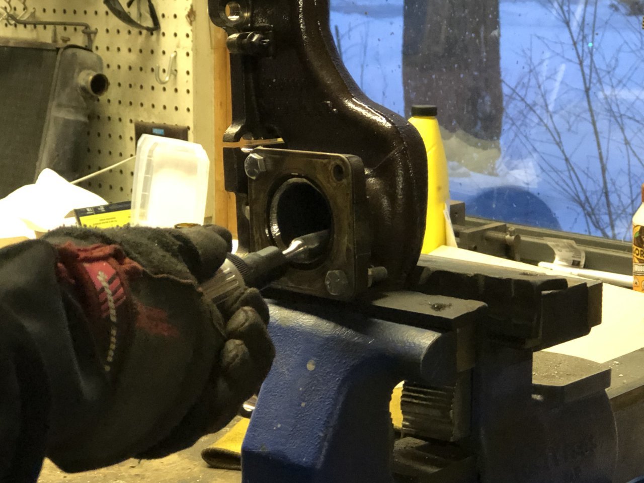

    Remember kids, if you're doing an upgraded turbo that has been "port matched" you should always check what it was port matched to. In this case not the stock header on the car, as the port matched gasket here shows. So we ordered the upgraded header and will be putting this back together in two weeks.
    Edit: rather than spend 500 on the header, we're giving it a go with a die grinder to hog out the factory one to port match.20B2517C-13BB-4DBC-AA10-E18568202BAD.jpg
