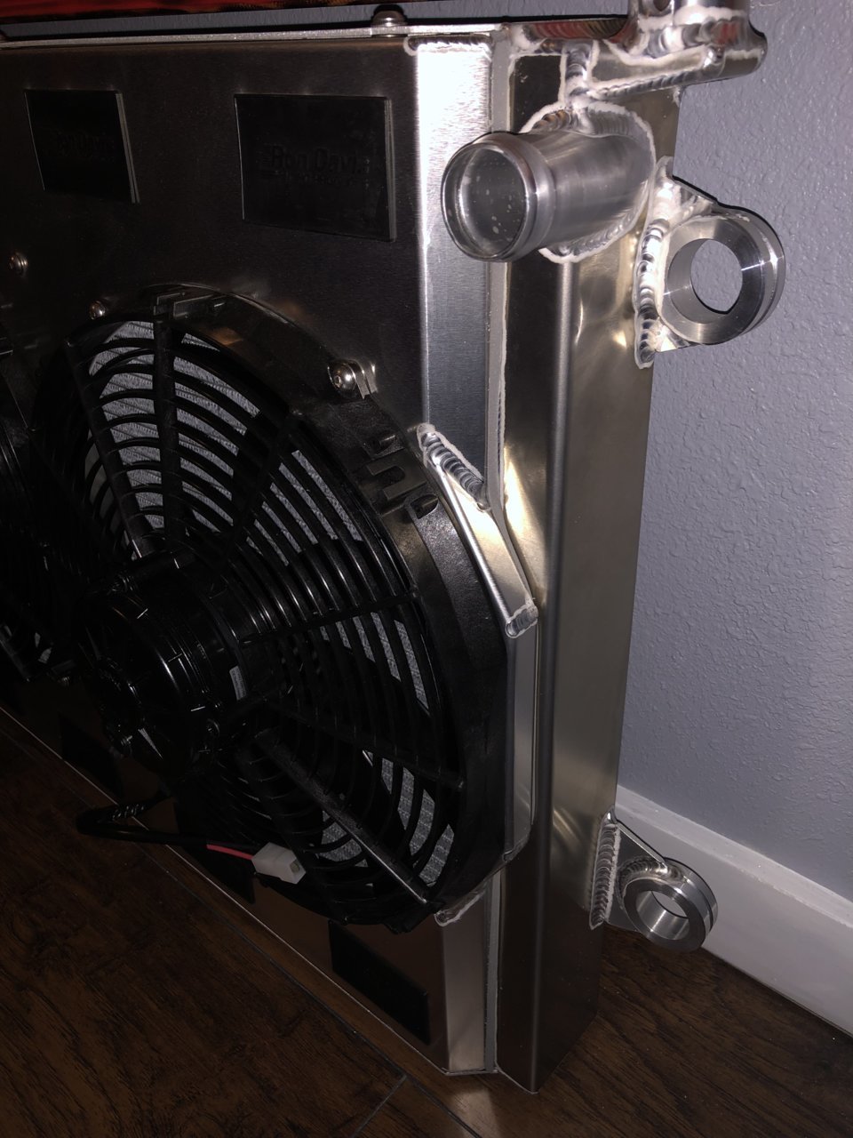

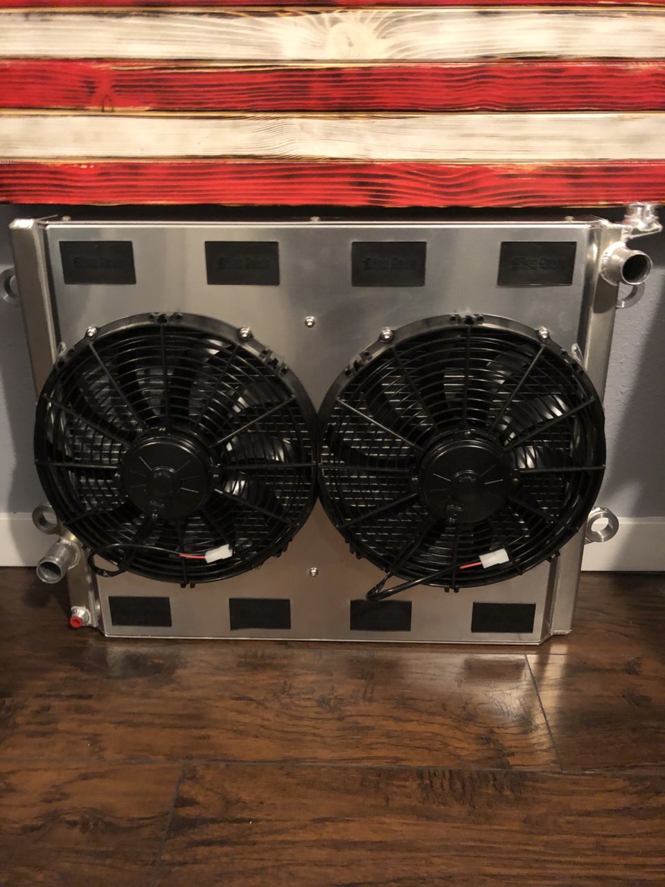

    Would someone be interested in a radiator? COVID hot hard and I have to sell some parts to get by. Ron Davis racing radiator with dual 16” spal fans with shroud. This is the same on that was built for @Torspd.

    I wonder if I could make that work for my 2.7... @Torspd any thoughts?

    2.7 and 4.0 are the same radiator.
  14. Jan 22, 2021 at 9:02 PM
    BananaMan
    BananaMan Well-Known Member
    Sep 4, 2019
    #304247
    8,273
    Bumfrick nowhere Maine
    06 2.7 RC 2wd manual "squattytruck"
    Really? That's surprising. Nothing has ever swapped over from a v6/6lug to my 4 bangin 5lug.

    They're the same on 6 lug. Don't know why they'd change it for the 5 lug.

    It's more the v6 -> i4 that I'm surprised at. I figured the v6 radiator would've been thicker, different inlet/outlet, different mounting points, any of that.

    This is accurate. We did a variety of referencing while figuring out the list of workable vehicles.
