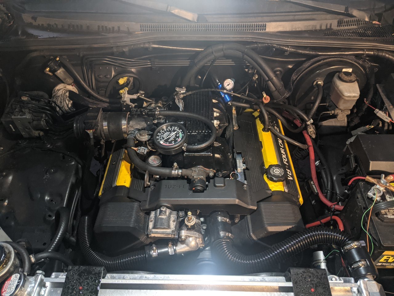

    Well boys I went through the wiring and didn't see any thing that really stood out. I then decided to yolo an ebay fpr because I had suspicion that the stock one wasn't keeping up with my dw200. I now have a different engine, its no longer boggy and running super rich. I found out my tps sensor was broken as well so I have another one inbound. Even with the tps sensor remove it revs like a normal v8 now.
    Yes the engine bay is a bit of a mess and I've already cleaned it back up for now.

    Honestly it feels nice to get out of that rut. It was really hard because I rebuilt the engine so I've touched literally everything which makes you question literally everything. Also with some of the components being as old as they are it just adds to it. I was giggling the entire time on the test run just like when I did my first tests with the old 4cyl turbo set up. I definitely found the motivation again to finish it in a timely manner.
