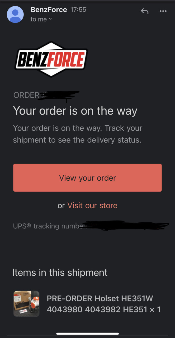

    Holy crap it's finally on its way. I can't wait to set this thing in the engine bay and just drool. 2F5F041C-223C-4729-B9FD-BE999AB9BD3D.jpg

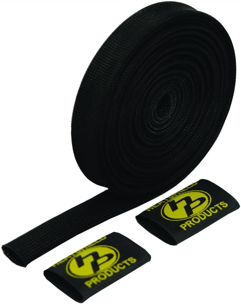

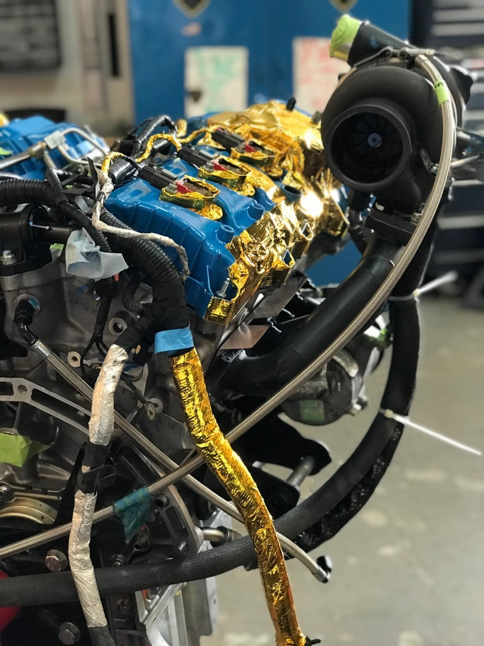

    Heatshield Products .

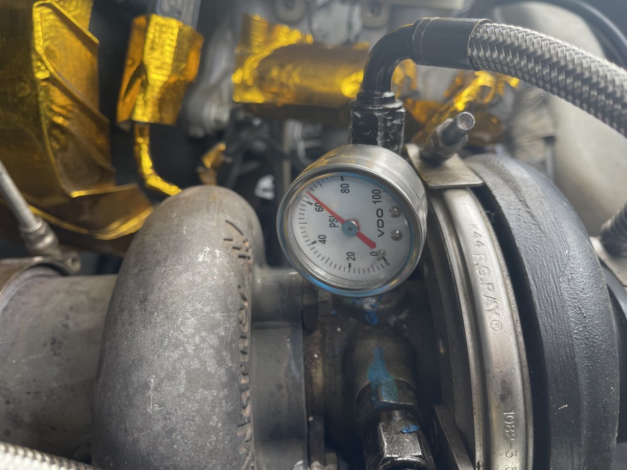

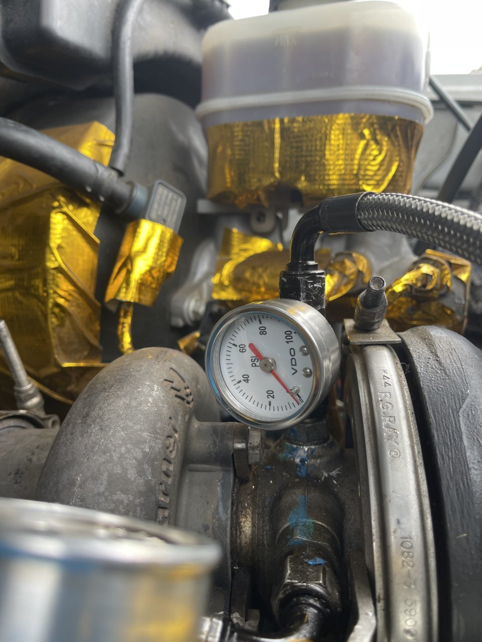

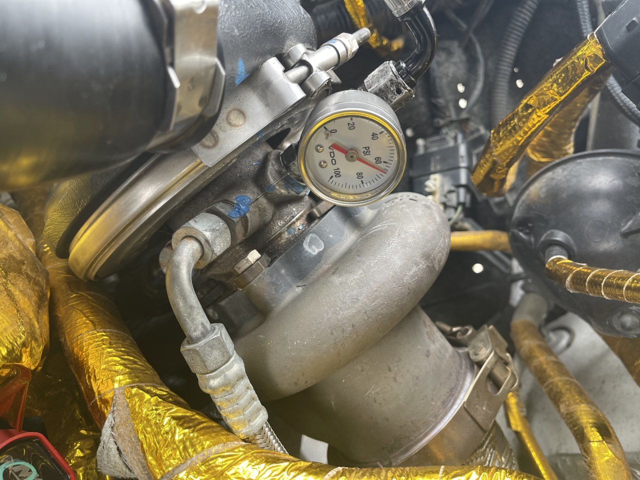

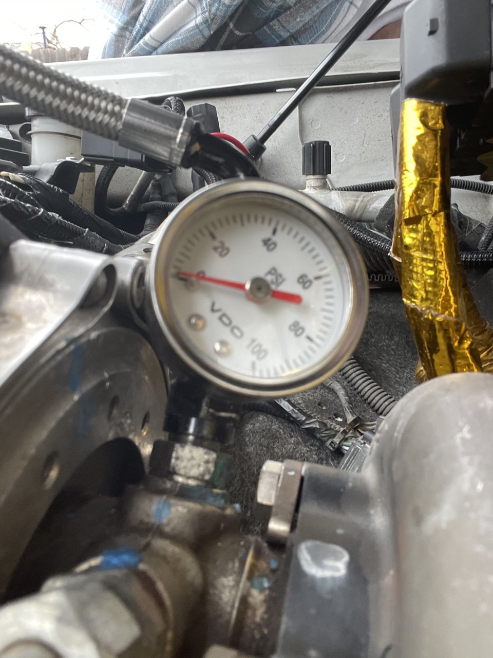

    Well I think I finally figured out the smoking issue after 2 years. Installed those gauges on my oil feel and the turbos were reading 60 psi cold! Took it for a spin to get it to temp and at idle the truck was sitting at 20psi. It was hitting 60psi on 3k and then spiked to 80psi when we took it to 4k for a sec. I am installing the Turbosmart Oil Pressure Regulator tomorrow and that should finally fix the smoking issue. The high oil pressure was acting as a brake on the turbos too so spool time should increase too.
    I'm drilling the pan and putting in the bulk head tonight. This way the jbweld can cure.
    https://youtu.be/5EWuLNZI0TI
    https://youtu.be/JFq5refiKyM

    I'm hoping for your sake that the seals aren't completely fubar...

    There's maybe 8k miles on the motor and the turbos were knew. They haven't been pushed hard so here's to hoping :fingerscrossed:

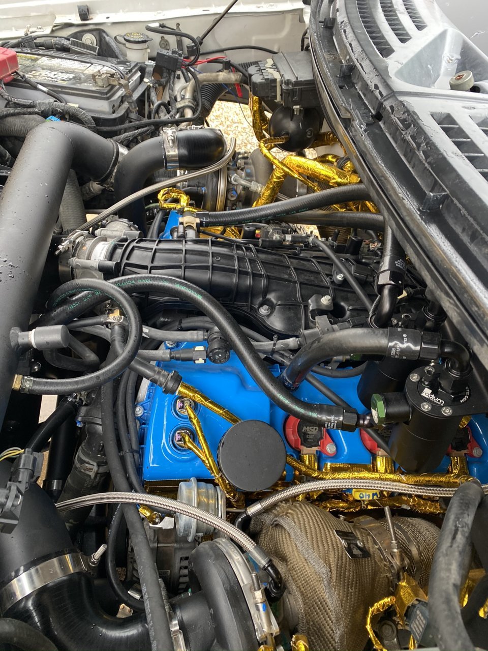

    More shots of how the setup will look

    They should very well be fine, unless they were dry started for too long.
    As a point of reference, my engine cold starts are at ~80 psi. There are no leaking seals.
