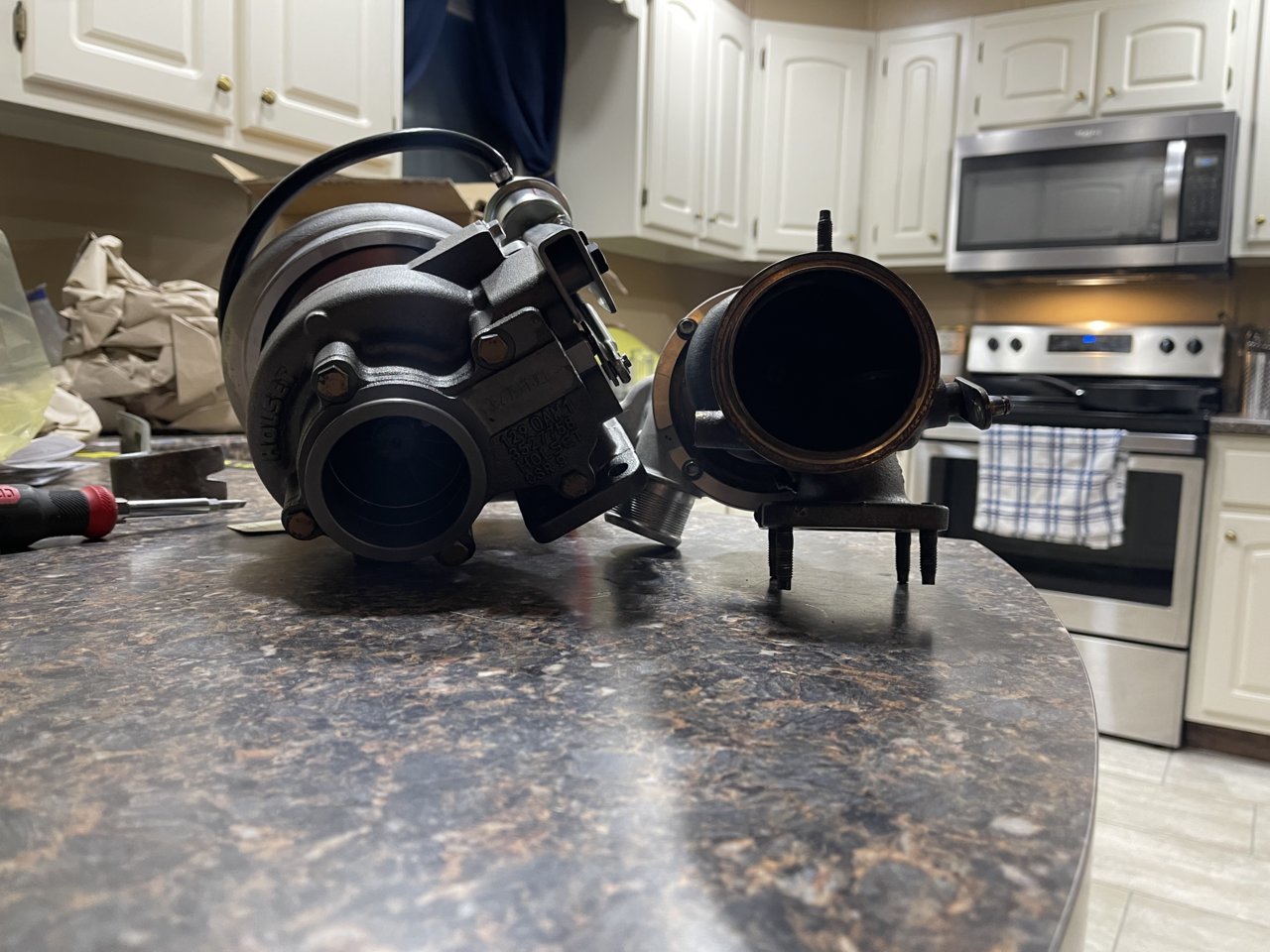

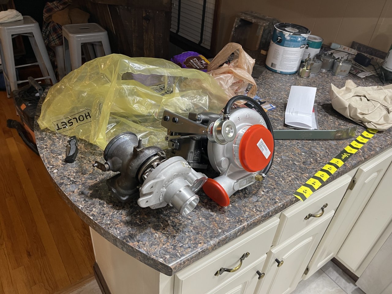

    2019 fiat spyder turbo comparison. 6DC4CB0C-FB8E-458C-8C96-9B2B674D2754.jpg0D5AE530-0404-4BC5-B42E-2FDDE4D1E2D8.jpg

    Yea each turbo manufacturer is different on pressure. Mine is 40psi. I bet your sweet spot would be 40 too and just remember that when you're smoking and need an opr like me :D

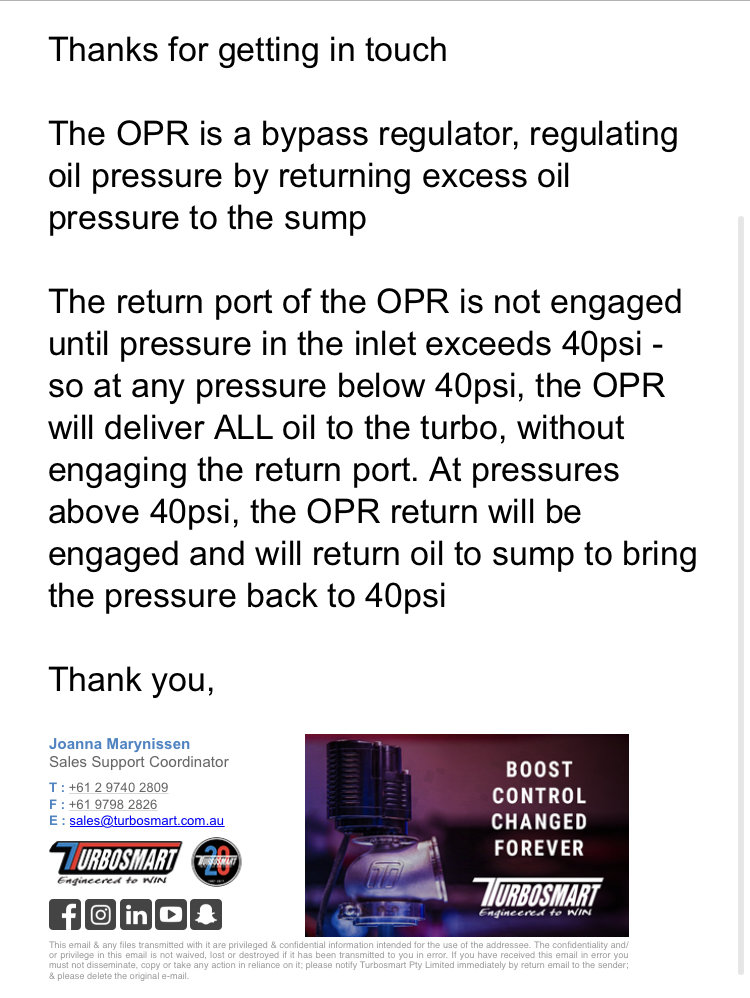

    @Sleipnir and anyone else considering one of these handy units. No guesswork for restrictor jets or continuing to burn bypassed oil from over pressuring seals.
    tech@turbosmart.com.au

    My distribution block acts as a T so putting the opr before the block will still distribute 40psi to each of turbo. I already confirmed with Turbosmart :thumbsup:

    I wouldn't put all my eggs in that basket. With the suggested tiny 6an lines once you split that 2ways doesn't seem like enough oil volume to feed twins. At least in my head anyway. There's a little thing called frictional pressure loss that I deal with at work. I've never crunched numbers this small but it compounds with smaller IDs.

    Already put a gauge on the oil feeds on both turbos and they make 65psi each. The distribution block does nothing to the pressure. My 6an should be more than enough since full race recommends 4 an and 6an for anything over 18"

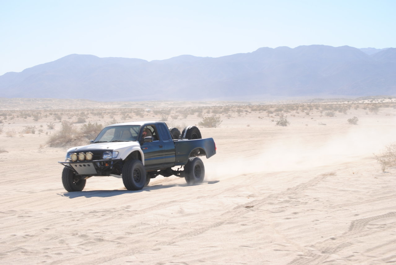

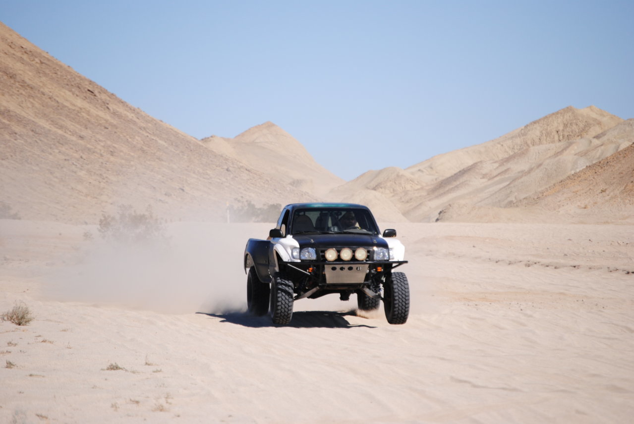

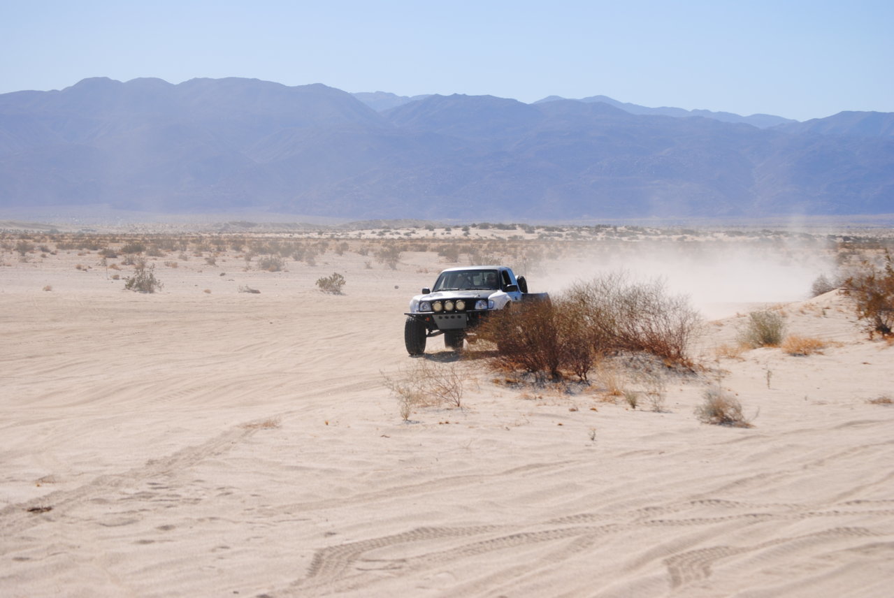

    The gf got a few pics from a few weeks ago making a 3rd gear pass. She missed the section where the truck gets off the ground for a second. I'll take pics when I can get them. Truck still running great.
