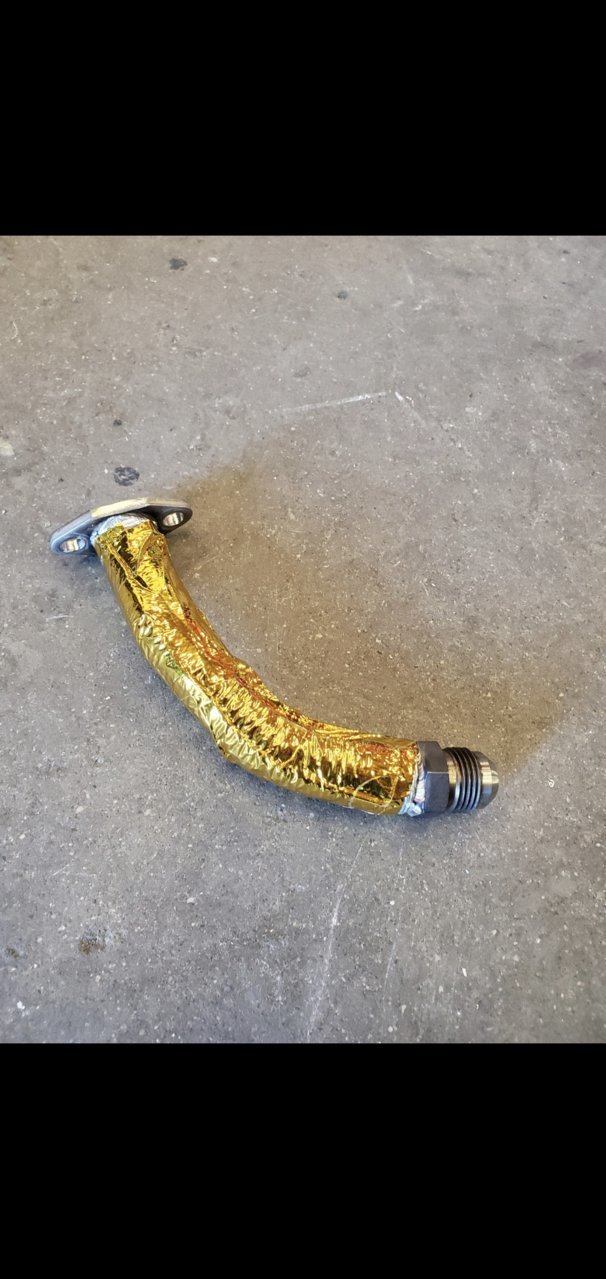

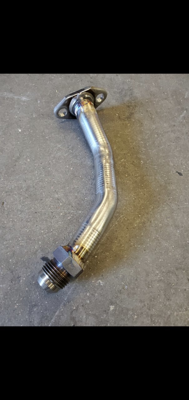

    I used a dremel to taper the flange hole on mine. Doesn't look as clean as that, but it can't be seen when installed.

    My current drains are screw-in NPT threads so no way to dremel them out. Would be a cool idea if these billet ones weren’t so dang nice

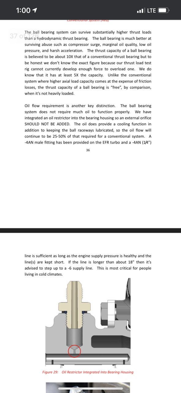

    -6 AN feeds??? Where did you read that? I had only heard -4.

    I think right now, these current conversations are going to solve your feed/drain problems.

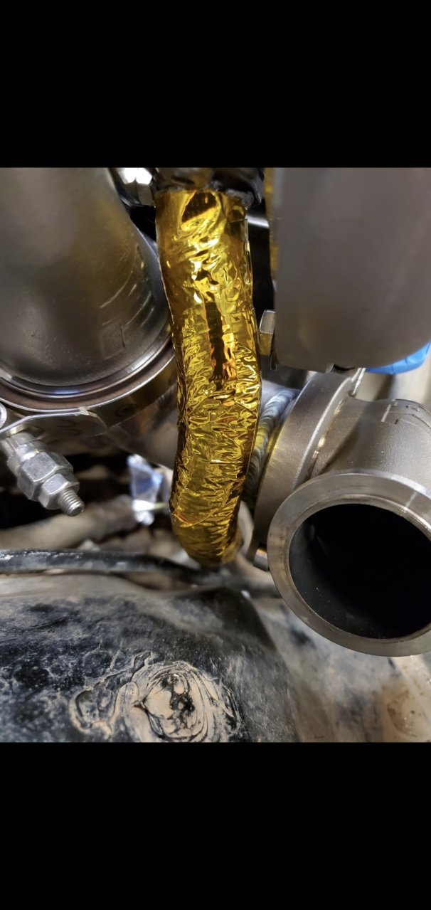

    Spoke with Turbosmart at 2K too and the way the BOV was installed it's fighting the vaccum source. I have a throttle body spacer I will install and use as a source for the BOV. That'll fix the bleeding BOV issue

    Exactly. Under pressure it may be fine but as a drain it’s backing up.

    Exactly my thoughts too. Can’t believe this was professionally installed like this :facepalm:

    Is it close to the OEM size? Maybe they thought they could get away with it with near stock specs.

    nah completely different I think and has 0 elbows in it. It’s a straight flex tube flange

    Well I changed my vacuum routing last night. Someone had hooked the wastegates to the boost solenoids that are typically mounted on the turbos for the CRV. Then they had the compressor housings t'd into the front boost solenoid. This is not how the routing or the solenoids work and there was a feed side (compressor housings) feeding into the outlet on the boost solenoid and the exact opposite for the wastegates. They go on the outlet side of the solenoids because it's supposed to pull boost from the hot pipe. Which by the way isn't where the solenoid is pulling from. It's pulling from the intake so I'll need to see if I need to tap the hot pipe so the wastegates have a reliable boost reference.
    Truck feels better and I can feel the boost and wastegates better. It's a weird feeling but it's moving the right way now. Next thing to tackle is the BOV and throttle plate. I'll do that all at once when I get my flanges and fittings for the drains.

    Didn't realize that they had called for a -6AN, for over 18" of feed line.
