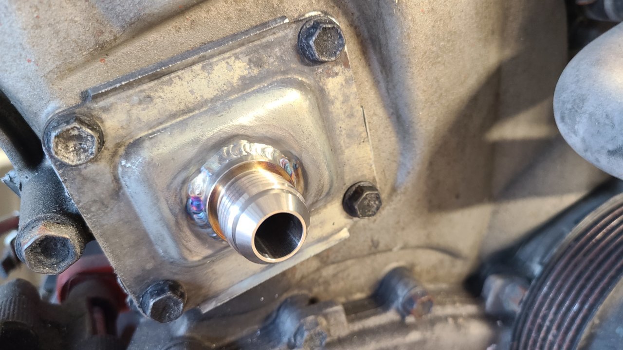

    Of all things, I never installed an oil pressure regulator. I always had plans to install a pressure sensor but never got to it, sad really. I ordered the Turbosmart OPR and that'll go on sooner than later. I'm trying to think of a way to have it drain into the valve cover, I've used all my space on the upper oil pan. I'm thinking use the PCV port I plugged.

    Weld a bung on?

    I've already welded on two bungs, not really a good spot for a third.

    What about using a y fitting to tie together the reg and turbo drain.

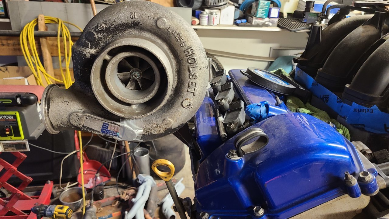

    I am working on a turbo project as well. Called it quits for the evening.

    On the valve cover?

    It is a thought. When going custom, imagination is the only limiting factor.

    I've seen where people have a custom oil fill cap that accepts the OPR organs, dumps excess right in

    Which sounds like a horrible idea now when I think I'll have to remove it every time I do an oil change haha

    So the oil filter housing has the two plugs, which I use one to feed the turbo. I'm thinking, is it possible to use the other for oil return?
