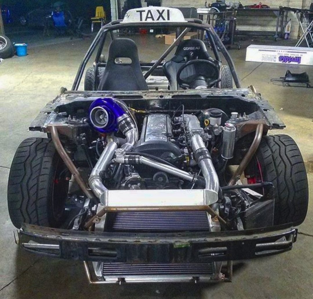

    Just found an old pic of my car. Compound 1jz vvti on 40psi.
    New owner bought it for the swap/parts to go in another car.
    Oh the times we had.
    buyobuyo, yota243, MadTaco461 and 5 others like this.

    That looks fucking wild. I want to see proof that this thing burned rubber as fast as it looks like it did.
    Sleipnir and Jon64l[QUOTED] like this.

    I'd totally pay for a Lyft in that cabbie!
    My project is way simpler in scope, than that magnificent chassis.
