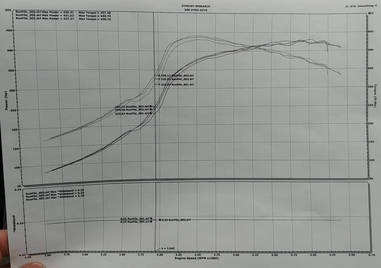

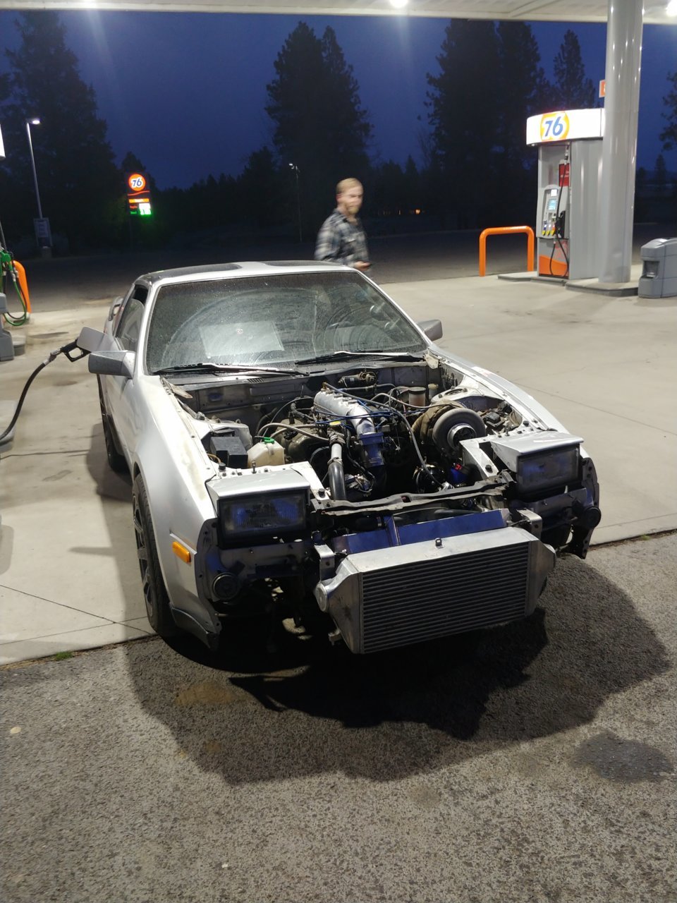

    Thought you fine folks in here would like to see/hear the dyno run from an engine my buddy and I just finished frankensteining together. It's a SOHC VG30 Nissan engine bored out to a 3.3L. We threw it together in a week and then street tuned it in three days to get it to the dyno. Made 431HP and 455tq on a really conservative pump gas tune (very fat and timing not aggressive). 20psi of boost fed by a 69mm Borg Warner S369SXE. Shooting for over 600 on E85 (when we can finally get it again), the last version of this engine (as a low compression 3.0) ran 563HP on E85 so hopefully the bump from 8.2:1 to 8.9:1 and the extra 10% displacement will get us there.
    https://youtu.be/av__yTJiTpQ
    I don't think I have the graph anymore, but here is the 563hp run on the old, smaller, lower compression engine
    https://youtu.be/nQI-zjC_kfA

    My kind of build!

    That's a fun little toy. What's the plan for it?

    Just a fun build because it was wanted, or a drift car?

    Just a low buck drag car. We're not really slidey bois haha. It's been a pet project for a long time between truck nonsense and the more expensive cars. Its a good bit higher power than my BMW, but it isn't as fast. I think it's the gear spread, trans isn't very close ratio and we haven't gotten no lift to shift setup yet
