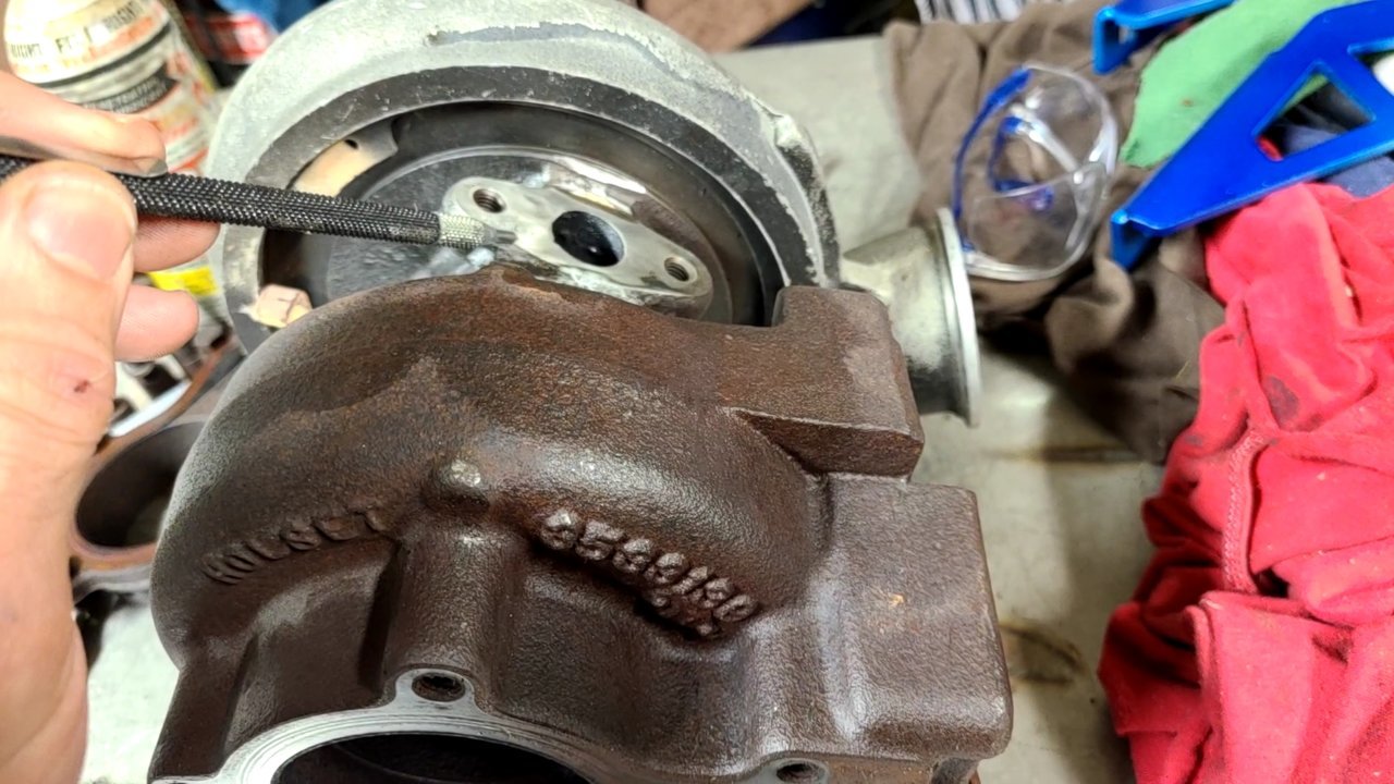

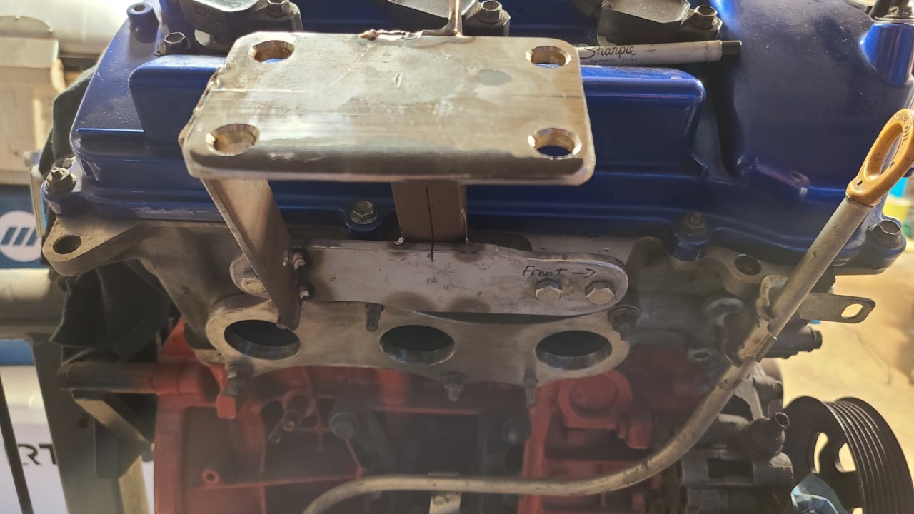

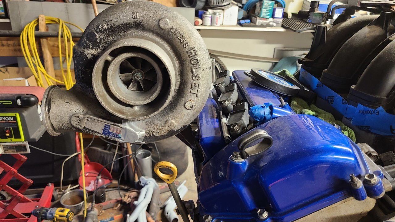

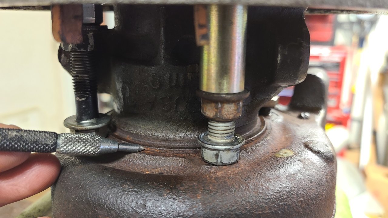

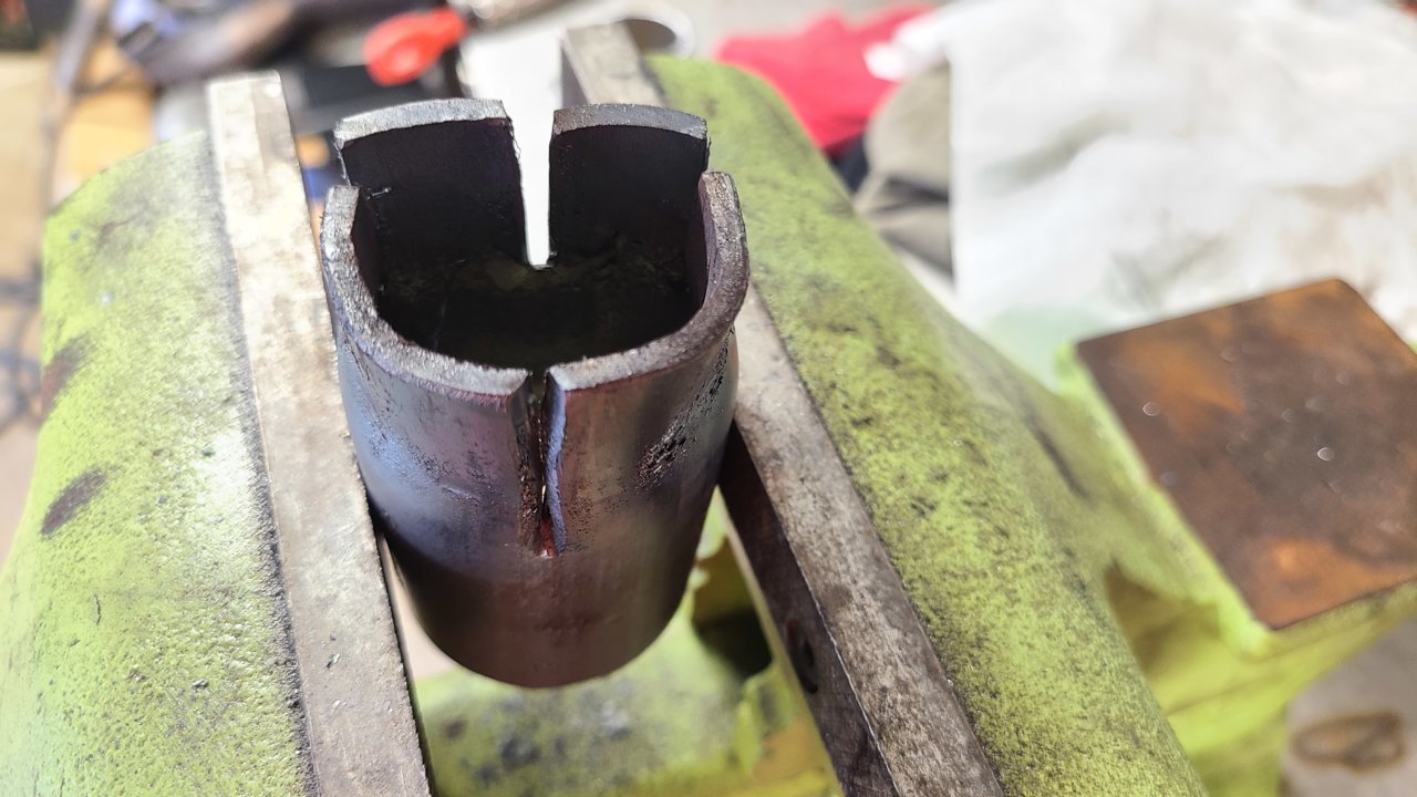

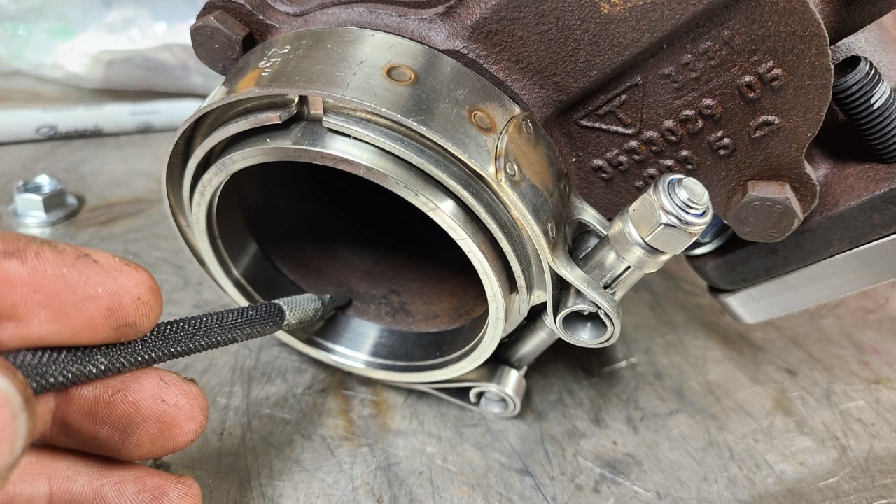

    While you guys have been busy, I have as well. I am always of the mind that you should only have one project at a time, but I feel like the universe wants to test me. Been working on this truck's turbo exhaust, on and off, as much as possible, trying to finish it. Here we go.
    Some of you may recognize this turbo. Mocked up a jig of sorts for the location, and T3 flange. Since my previous was T4.

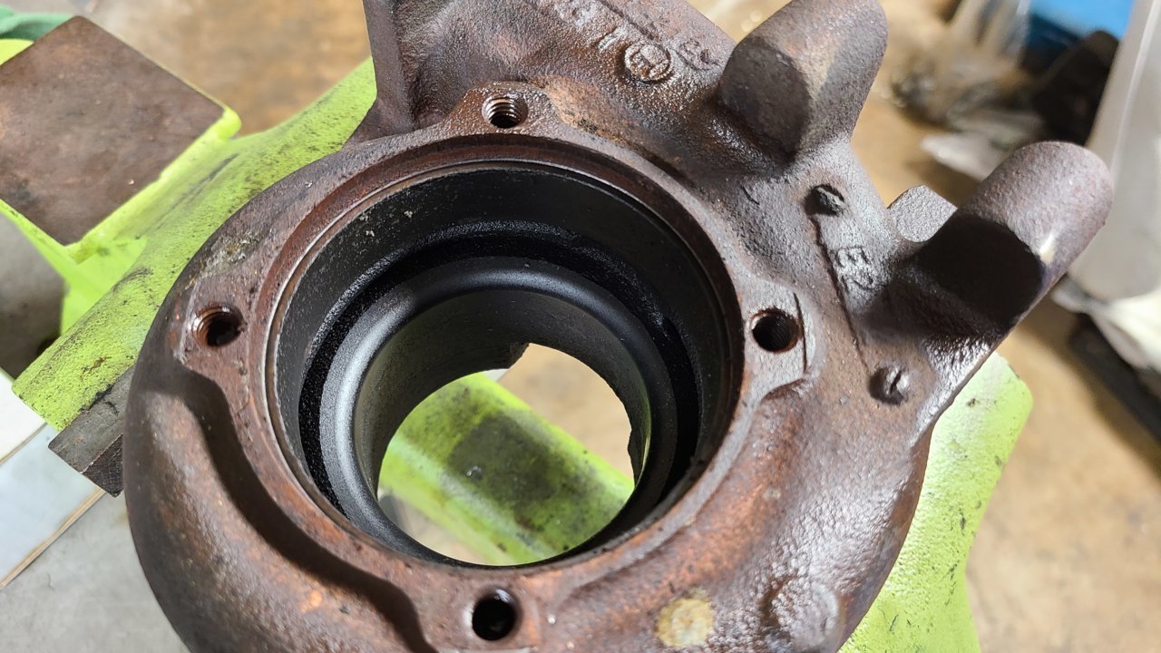

    The turbo was used, and thus needed to be re-clocked. Used a bolt press to push it apart.

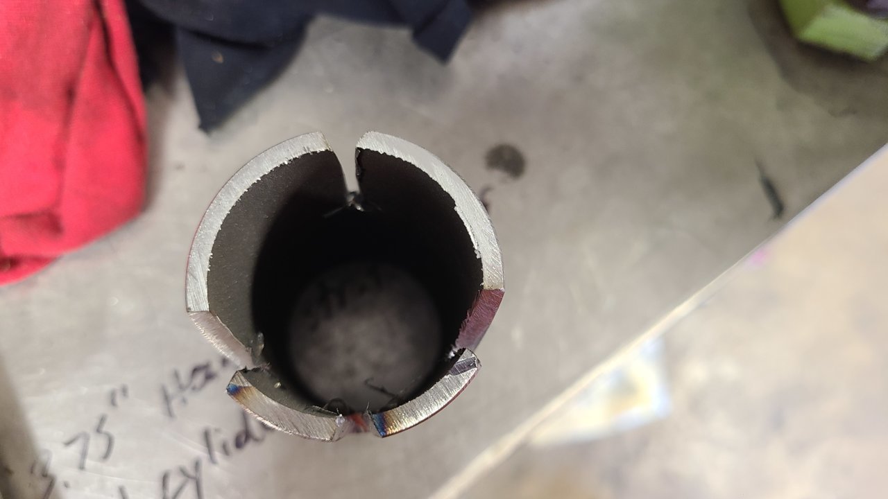

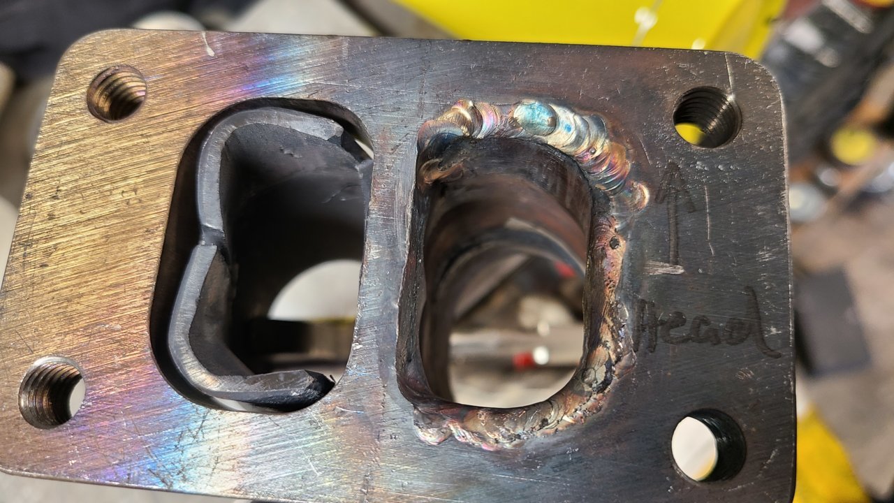

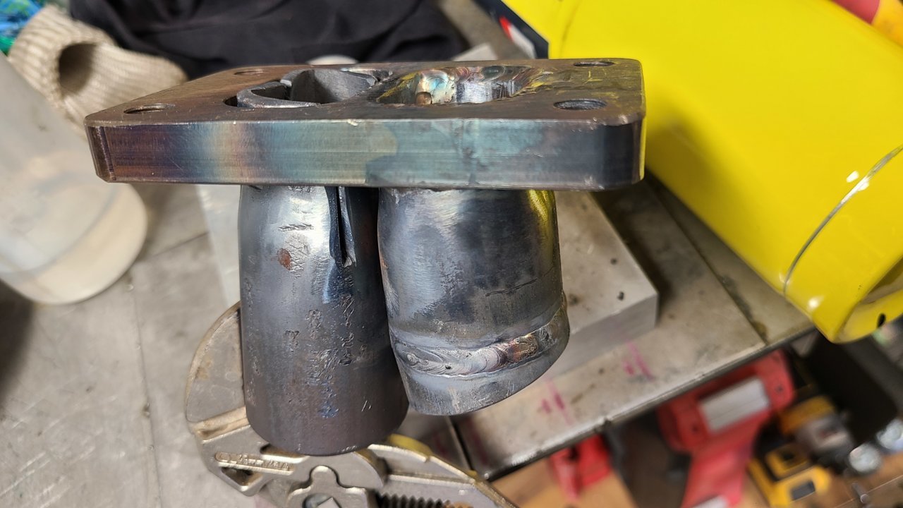

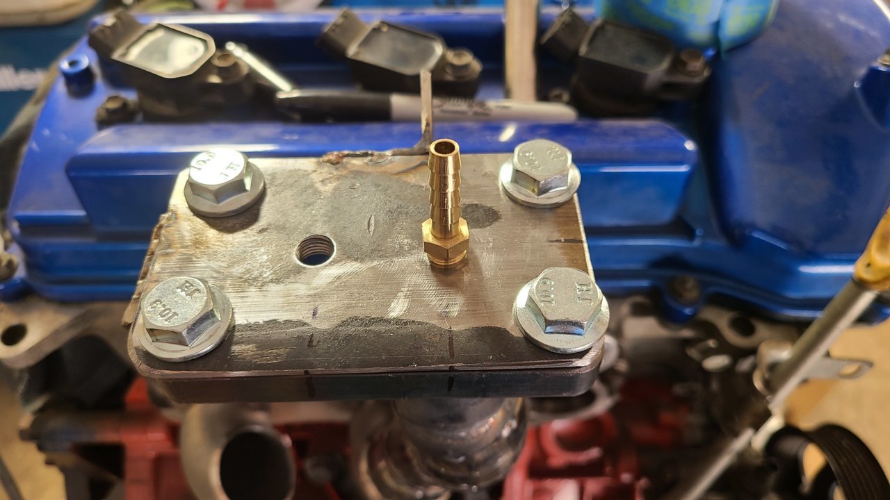

    Making the inlets into the flanges.
    Mocked up.

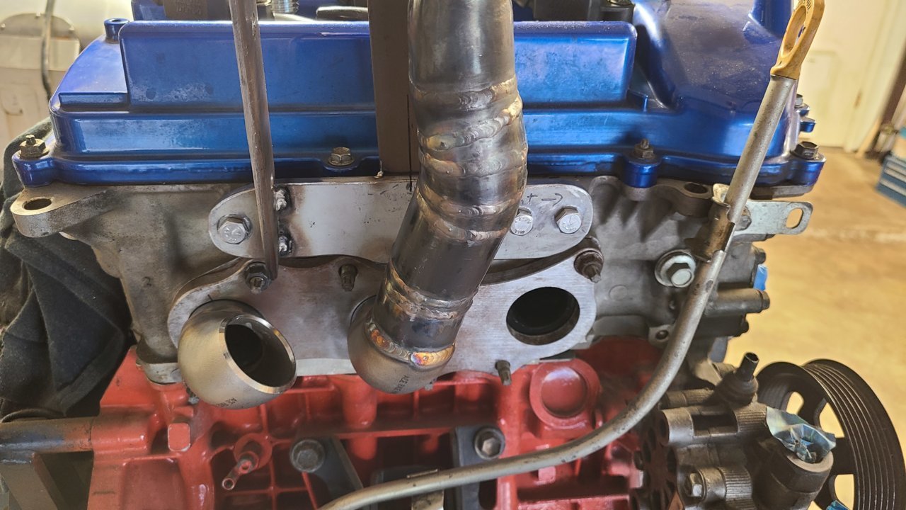

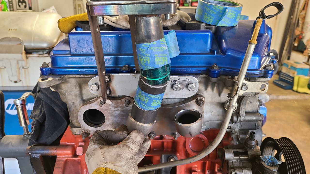

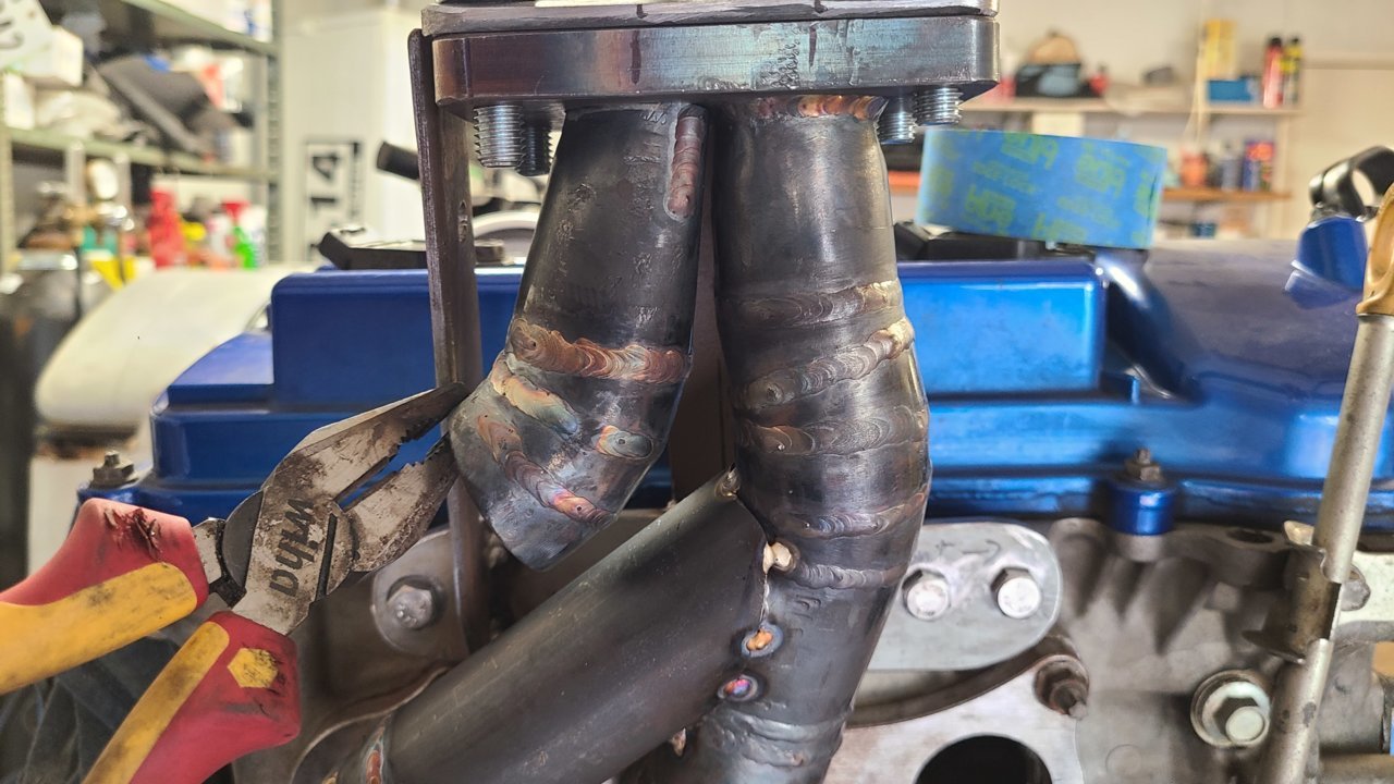

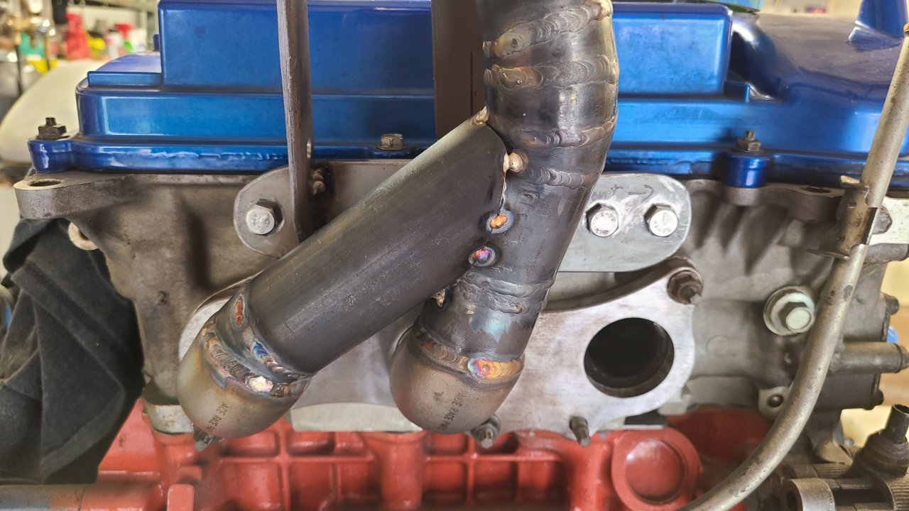

    Back purged and welded up.
    Rear primary tacked on. Now the other flange inlet could be located.

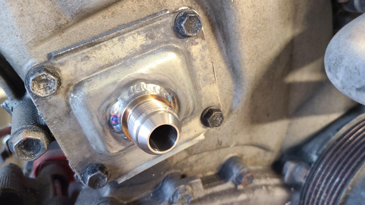

    Torspd Custom Turbo kit [] Borg Warner 9180EFR Turbo [] Haltech Elite 2500 [] TiAL Q BOV [] TiAL V44 Wastegate @ 15psi [] CP Pistons [] CP Carrillo Rods [] ARP Head studs [] ARP Main Studs [] ARP Header - Head Studs [] Ported Heads w/ 1mm oversized valves intake/exhaust [] Brian Crower Forged Stroker Crank [] Darton M.I.D. Sleeved Block [] Kelford Camshafts [] Torspd 160* T-stat mod [] APR Large Fuel Rail [] Walbro 460 LPH E85 Fuel Pump [] FueLab FPR [] APR T56 Conversion Kit [] KP RACING Built T56 [] McLeod Racing Custom Twin Disk Clutch [] One Piece Aluminum Driveshaft [] MGW Shifter [] Custom lowering kit [] Ohlins Front Coilovers [] QA1rear shocks [] Custom Ron Davis Radiator [] Dual SPAL Electric Fans []
    Drain return is finished. Unless we decide to lower it later.
    Just need to finish the front primary, and cross-over. Woot!

    Kinda stock
    that thing is a super spooler. What are the specs on that holset?
    All I know is that it is an HX35W. Maybe one of these photos will also help?
