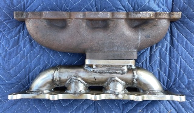

    Log mani in question.
    Poor 1st gen to get abused.

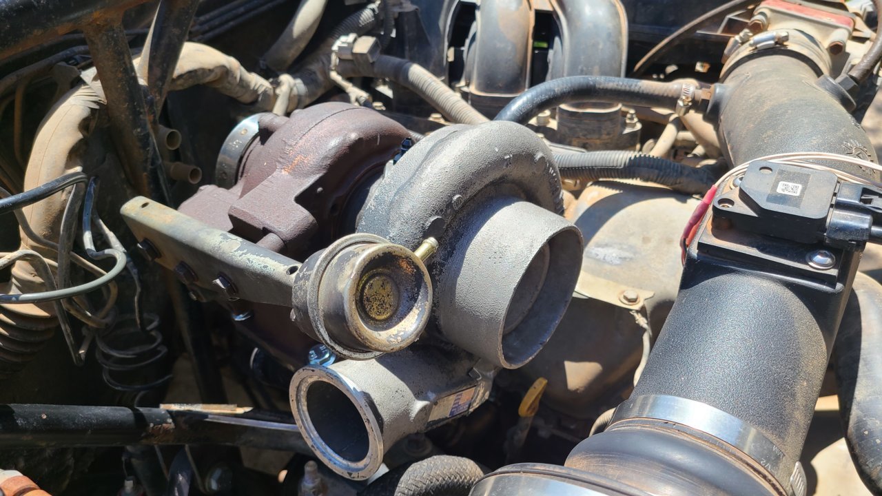

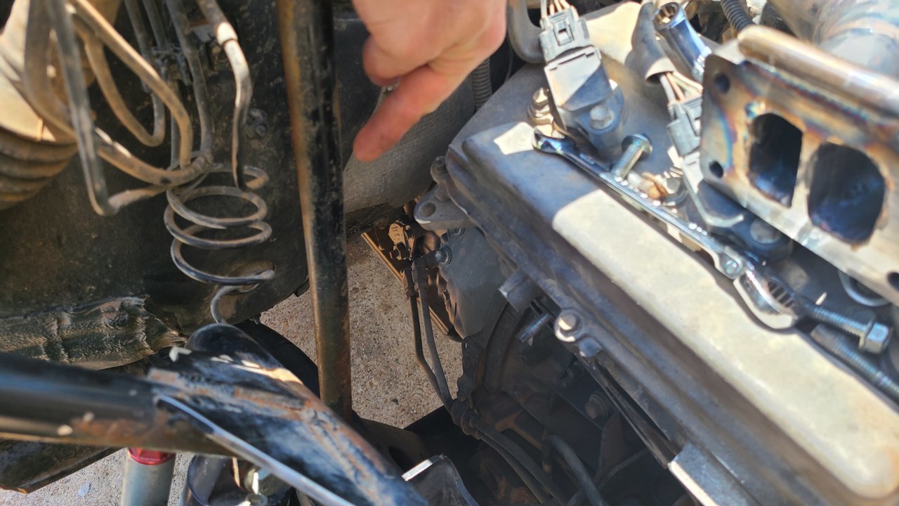

    Just spent a few minutes under the hood with one in hand and it won’t really fit anywhere easily. Behind the grille I can fit a 22x7x2.5 IC with same side in/outlets comfortably. If I could find one just the right size.
    Hmm. Log mani with turbo situated as far back as possible, hot side facing forward for ease of downpipe, using factory air box/MAF straight back to a 180 into turbo inlet, compressor clocked upwards (should come from underneath configured this way) about 45* from vertical away from block. Then to a 90* across to a 3x6 hole cut beside passenger headlight, into lower side of same side intercooler. AC line by air box must be bent up or down to pass without contact. Coming off of top outlet of IC back through 3x5 hole, extend about 4” into engine bay and then 45* up to TB where another 45* coupling makes up there.
    Behind the grille all hardlines and horns need to be moved as well as lower brace for hood latch. Grille can be trimmed for a fatter IC up to 4” thick. Or...or possibly go with a water to air setup. I found some really cool looking and easily tuckable w2a ones on the fleaBay as well.

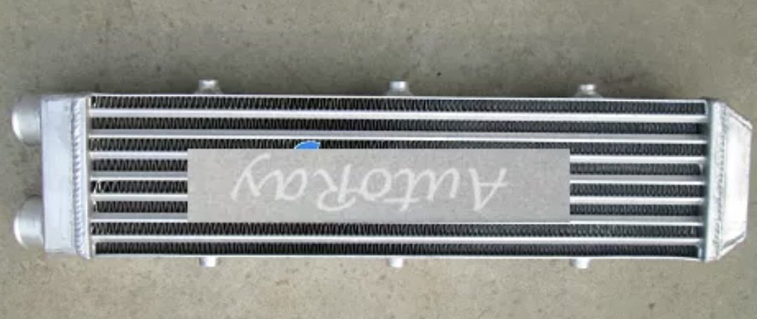

    Small FMIC. 21x5.5x3”. No major hacking or cutting required. I’d hope that at low boost, cooling wouldn’t be a big issue.
    Tubular w2a with a core size of 4x10”. 2.5” in/outlets. Two of these should suffice. But you’d need a reservoir and pump. Long trips would warrant a spare or redundant pump, too. 5 gallon bucket in the bed with a junkyard tranny radiator inline on the return side and big 12v computer fan mounted to it.

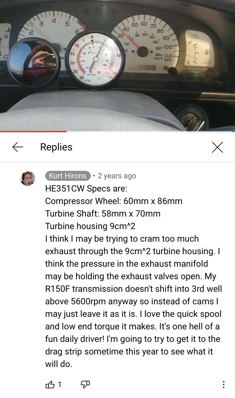

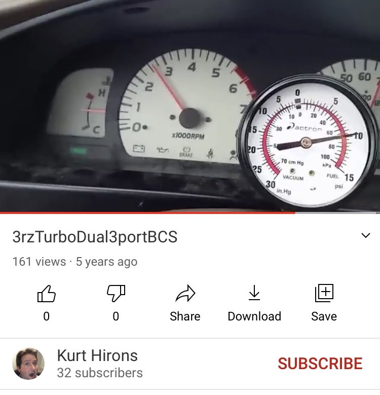

    I found this guy running an he351 on YouTube.
    5psi just shy of 2500rpm. Likely single scroll as well.
    And 10psi in a later video just north of 2500. So the spool up is quick. He has other videos after going megasquirt and running over 20psi on a built bottom end and cams making sub 12sec passes with horrible driving.
    Build thread at CustomTacoms dating back to 2012 that I’m skimming over morning coffee. Headed for an alignment in a little while and do some more looking.
    https://www.customtacos.com/threads/2002-tacoma-3rz-turbo-build.163041/
    Edit: made it to the end of that thread and ol’ boy is pushing the he351 to 30psi on a built bottom end, valve springs, and cams. With stock valvetrain it would come off vacuum around 2100rpm and with improved valvetrain he revs it out to 8000. He also swapped hot side housing and turbine out towards the end of the build. Bigger housing and bigger turbine. Interesting.
    http://turbolabofamerica.com/he351-exhaust-housing-upgrade/
    Here is a decent pull he revs out and still holding maybe 15psi.
    https://youtu.be/_Q2Yi7JwT5s

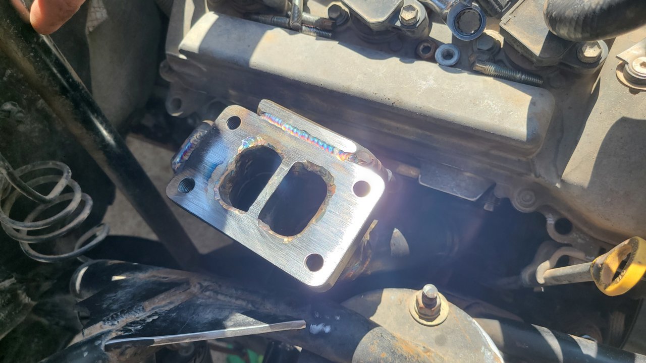

    Ran into a minor issue. A re-clocking was necessary, to route around this cage support. The exhaust outlet was in the center of that support.
    Easy fix. Cut, clock 30 degrees, weld.
    Cross-over nearly completed. Then onto intake.
