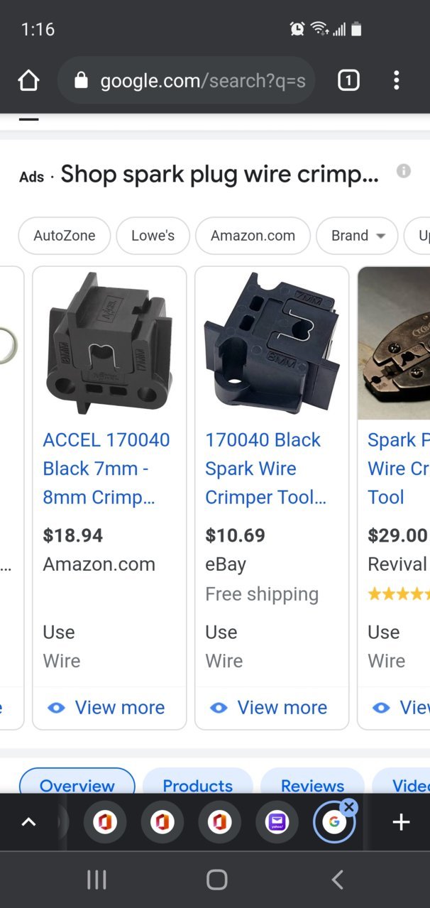

    There we go. Sounds like it might be easier than I thought. Probably can just chop up a 2rz plug and crimp on a chevy connector.
