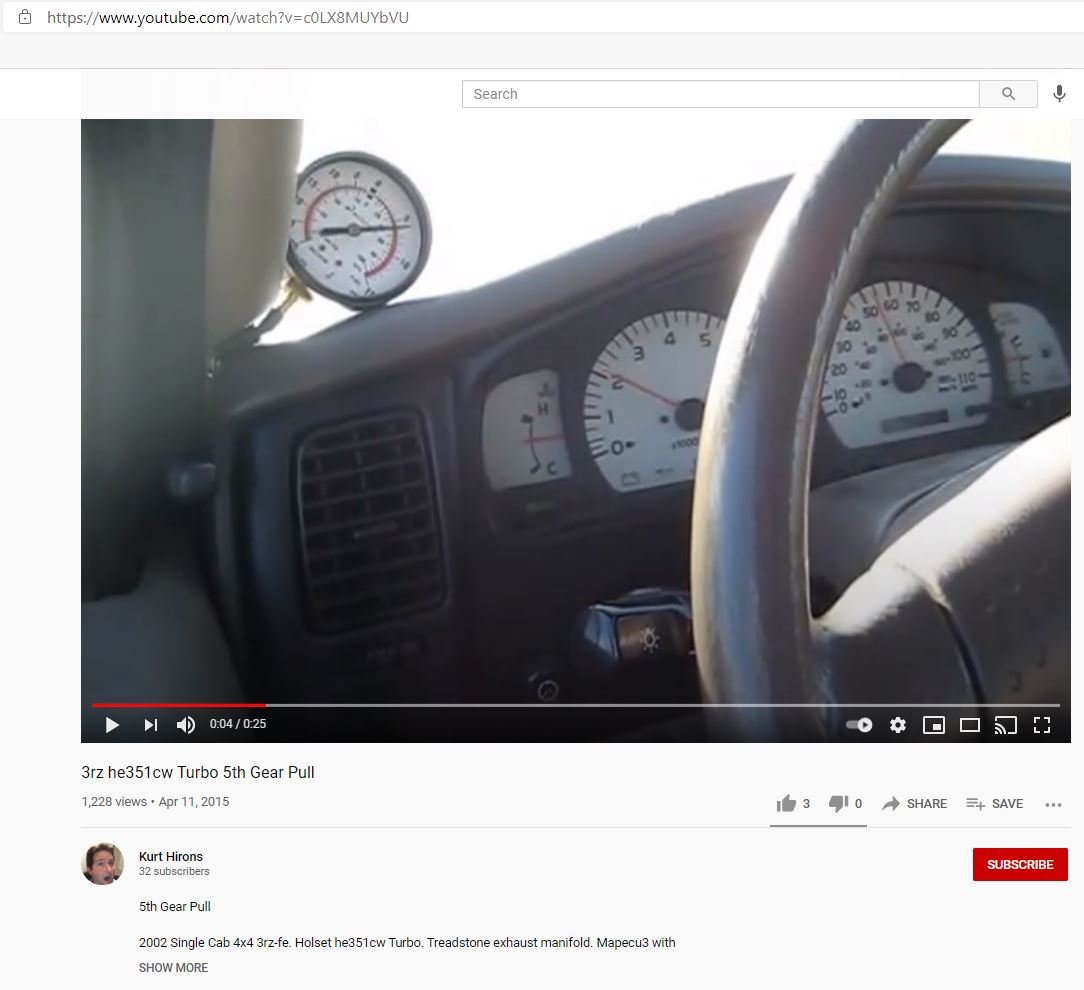

    How does the HE351 compare?
  5. May 4, 2021 at 7:43 AM
    Brake Weight
    Brake Weight But it hasn't rained in weeks...I'll make it.
    Jan 27, 2015
    #147363
    2,879
    Deep South near the Third Coast
    Taco pulling 33s and a B6 pushing 33psi
    Weld on sliders, fiberglass shell, 12k winch in an Elite Offroad bumper, front Aussie Lunchbox

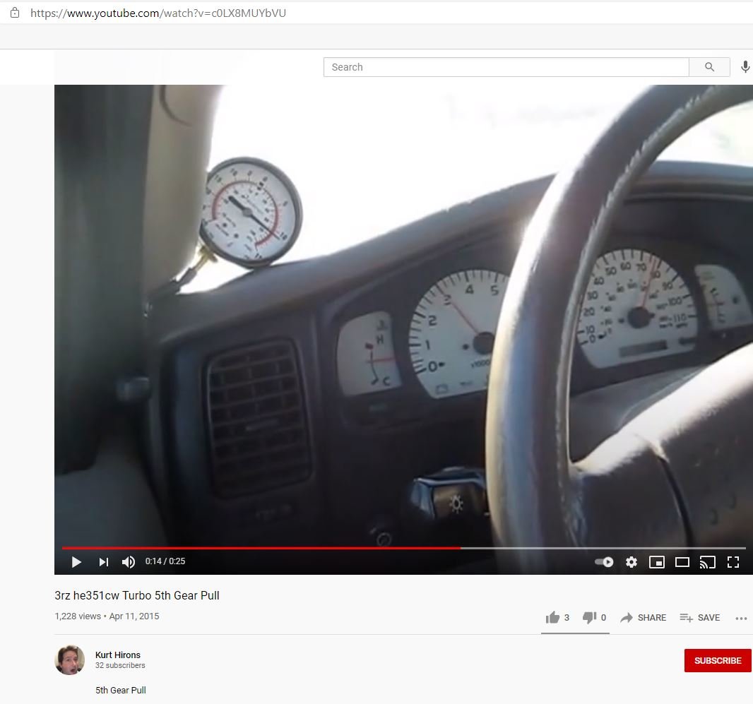

    I haven’t found a specific compressor map for the he351 but I made a couple of snipits from the YouTube video of one on a 3rz. He made a 5th lugged pull and this is the result.
    Starts building
    Full boost he had it set to at that time.

    That is early. Plenty of range left.

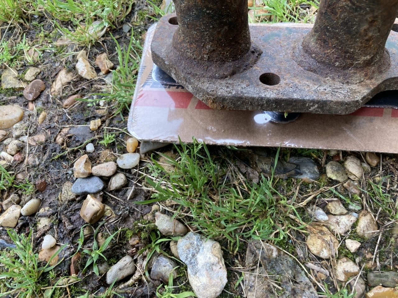

    A side quest was for a prebuilt t3 manifold. I stumbled across some strange similarities between various Toyota 2.xL inline fours. I’ve yet to find any pics with dimensions but they are very similar. The MR2 and a Celica ran the latter engines and some were factory boosted. The NA versions have some aftermarket and turbo manifolds are available. I may just break down and order a set of gaskets to match up to what I have for the 3rz.
    The bolt pattern is 180* upside down though.
    I believe this is a 2nd gen MR2 manifold, either a 3SGTE or the NA 3SGE. Eerily familiar.

    Let's say the turbo manifold flange is 180° off. Clean cut and weld, and it will be good. Space for fitment is another variable.

    If it’s spot on there are some cast manifolds floating about that would work since the t3 flange faces straight out. The tubular ones may need rotating if you don’t want a top mount or if the head contacts the compressor housing. Next time I’m by a parts house I’ll order those two gaskets.
    Edit: If the gaskets show the ports are very close to being the same then a tubular mani could be fitted to a 3rz flange relatively easy. According to O’Reillys they cross reference for these mid ‘90s engines. Bonus is they show in stock at my closest store. All I need to do is get a 3rz on the counter along with one of these.
    2.0 3S-FE
    2.2 5S-FE

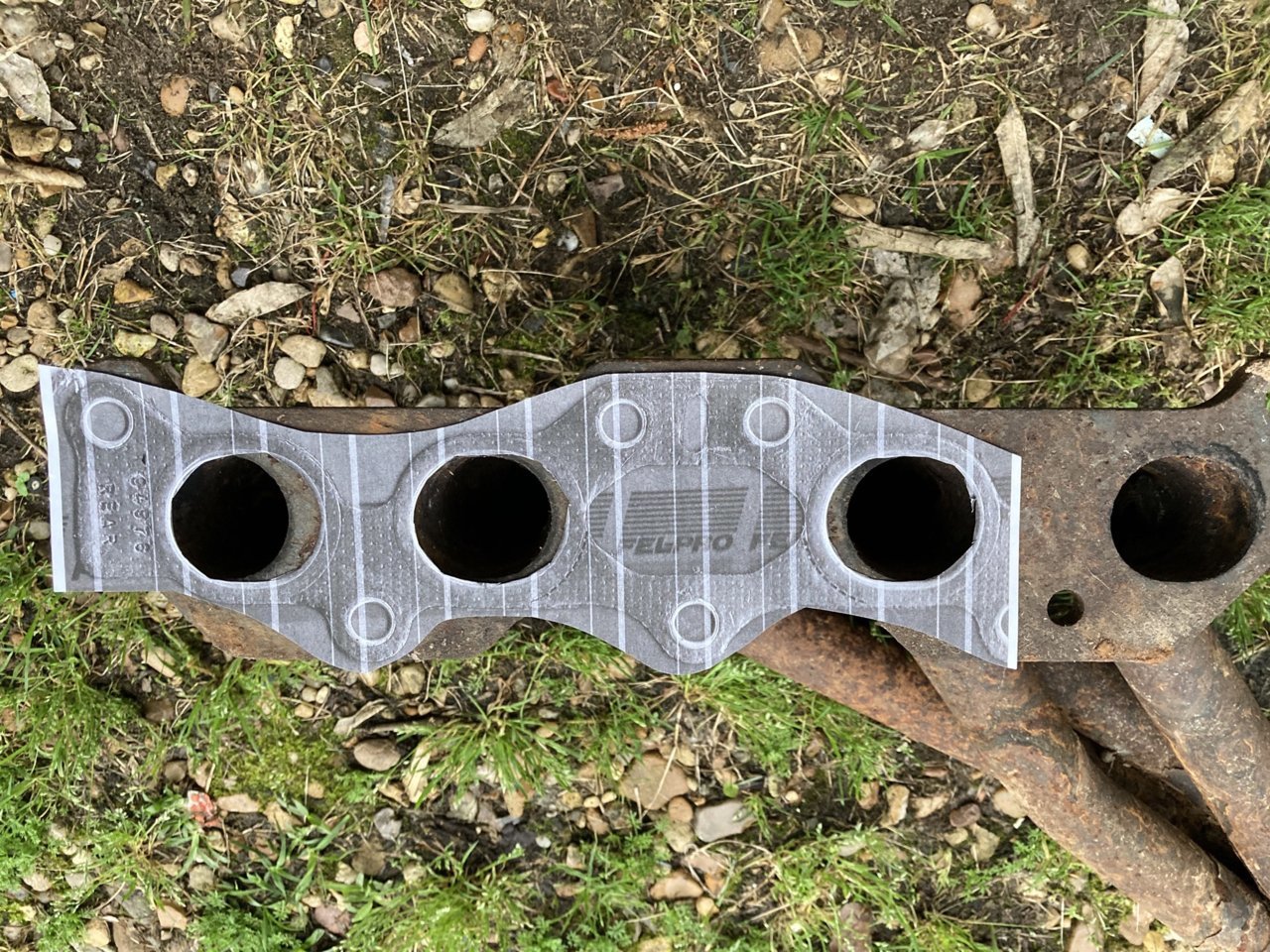

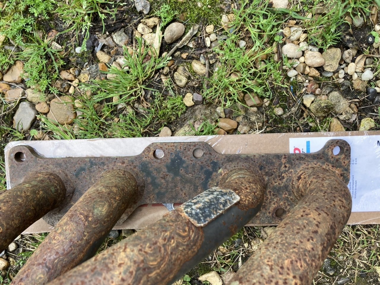

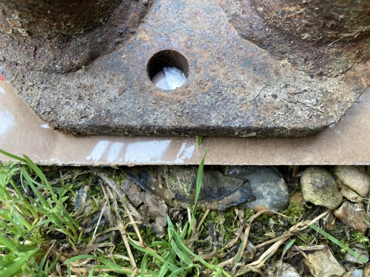

    The parts house didn’t have the 3rz gasket like it claimed. They did have the 3SGTE gasket. So I bought it for $27. I get home and I can’t find my spare 3rz gasket I thought I had. What I do have is a spare VW 1.8t. So I dug the 10 year old PaceSetter header literally out of the bushes and line them up. All the upper bolt holes are spot on. The lower holes are not. They are centered on the 3SGTE mani and not on the 3rz. I never realized this. So they will not directly swap but the ports are nearly identical. I hate to open the $27 gasket just for runner comparisons but I’ll see what I can do in a little bit. Got some online work isht to do right now.

    Well, very melodramatic in the end. It was close but not close enough. If it was a direct fit turbo manifold it’d be an awesome find. But being it isn’t, it isn’t. A tubular mani for the 3SGTE could be retrofitted to a 3rz flange but then you’d have to deal with the placement. Looks like all those mani’s are tucked in tight and to the rear.
    Some old school template tech.

    Could you flip the gasket over to the other side? The left and right lowers are different spacing.

    I just returned for my $27 back. The lower two on the 3rz aren’t centered up on the ports like those on the 3SGTE. The 3rz is slightly offset towards the outer port.
