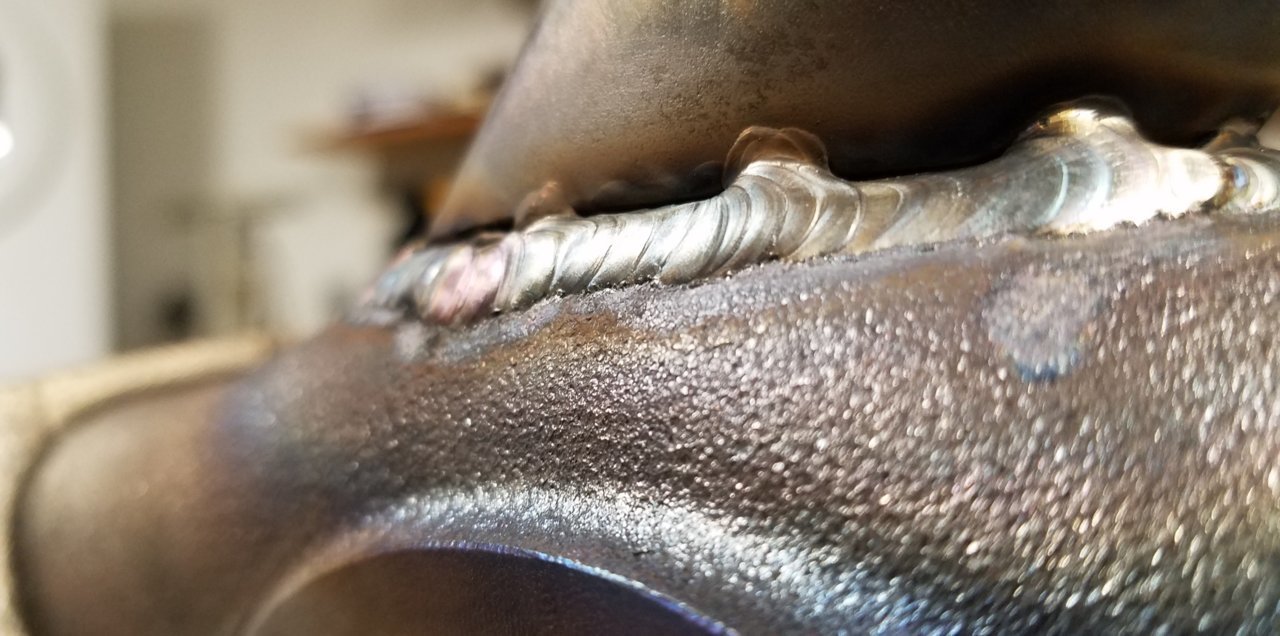

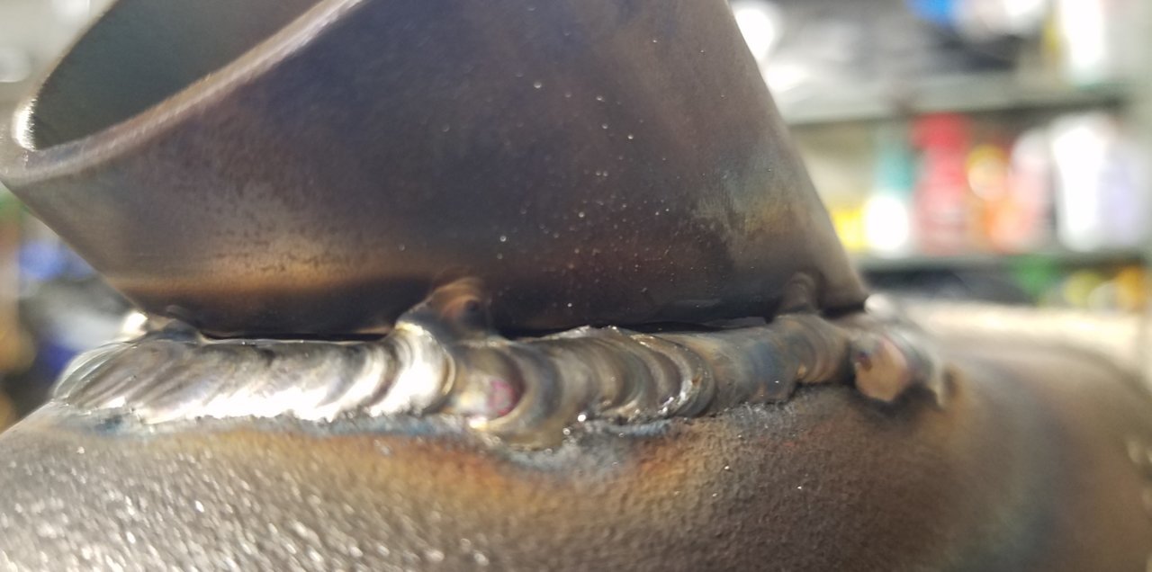

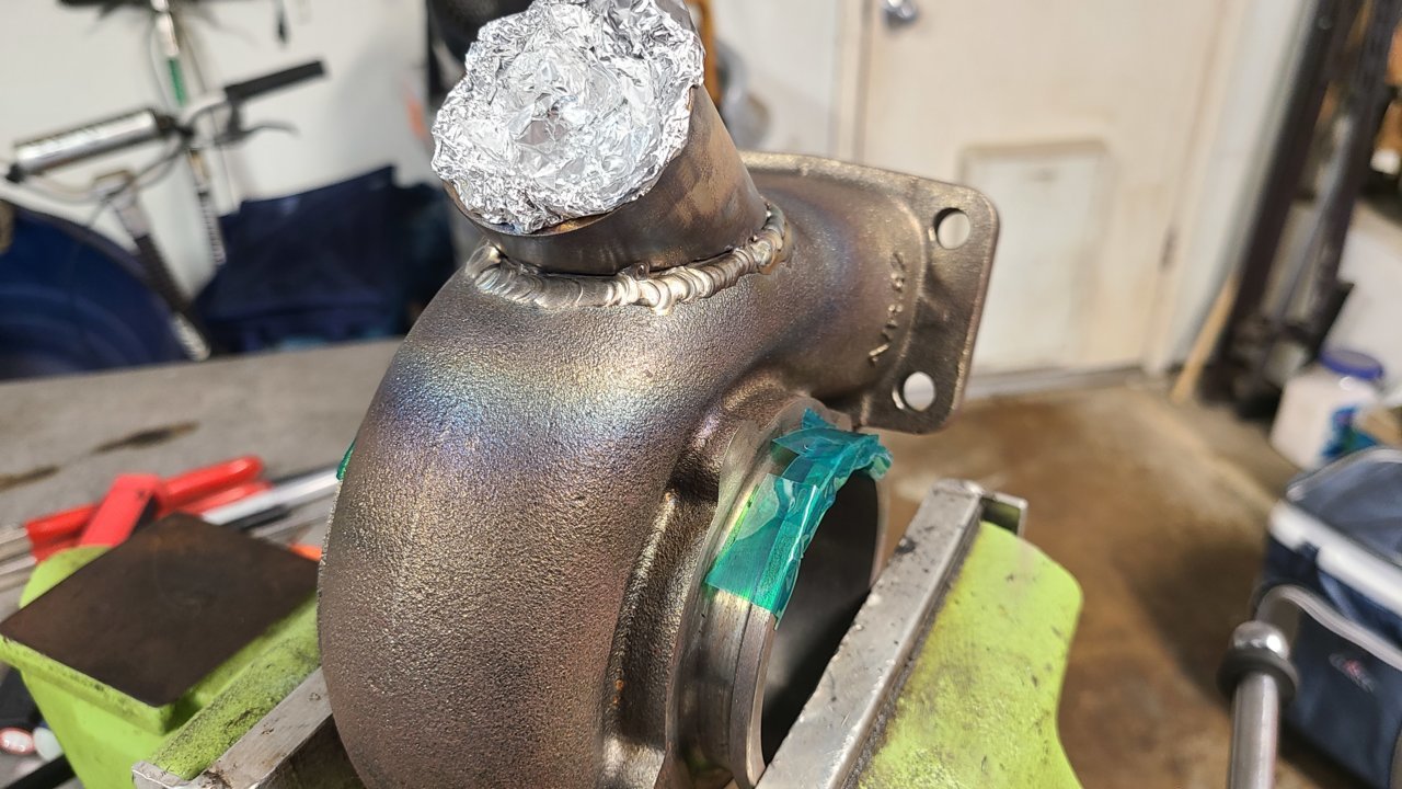

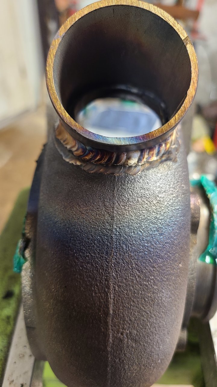

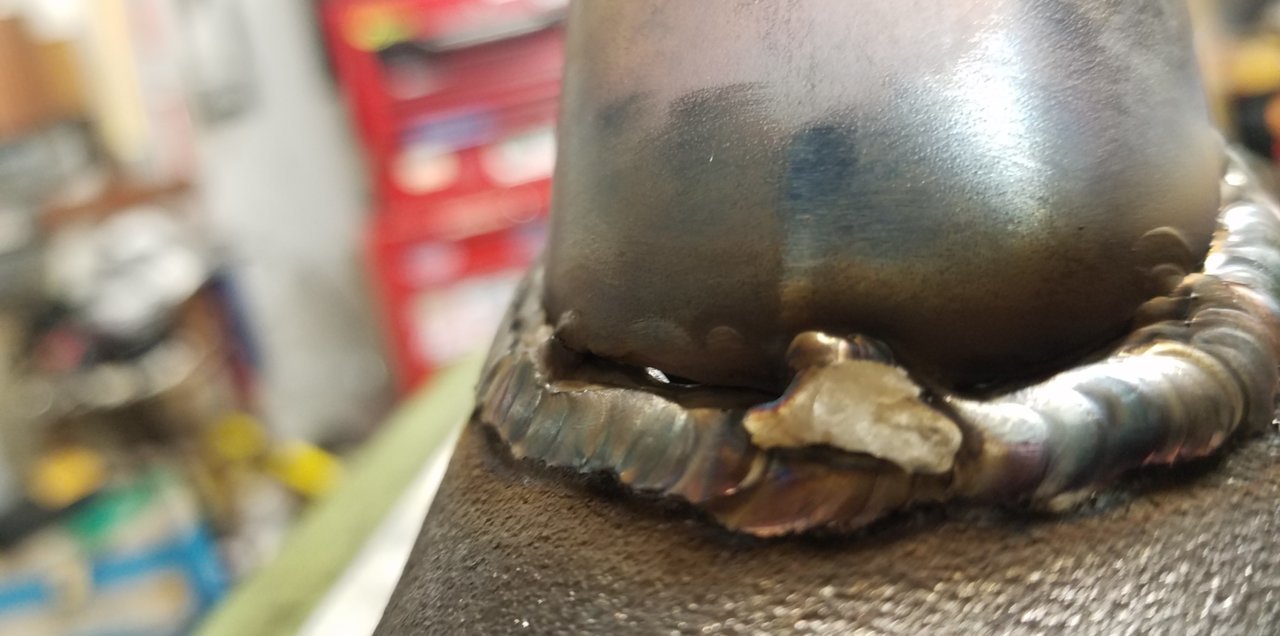

    I've made three circumferential passes with filler rod. Pressing it deep into the puddle, to impregnate the casting.
    Minus making six star like legs or tails emanating from the circumference outward, I am feeling good about the strength of what I have done here. I can now weld the tube to the filler wall that I have created.

    What size filler rod are you using?

    For the circumference, ~.035".

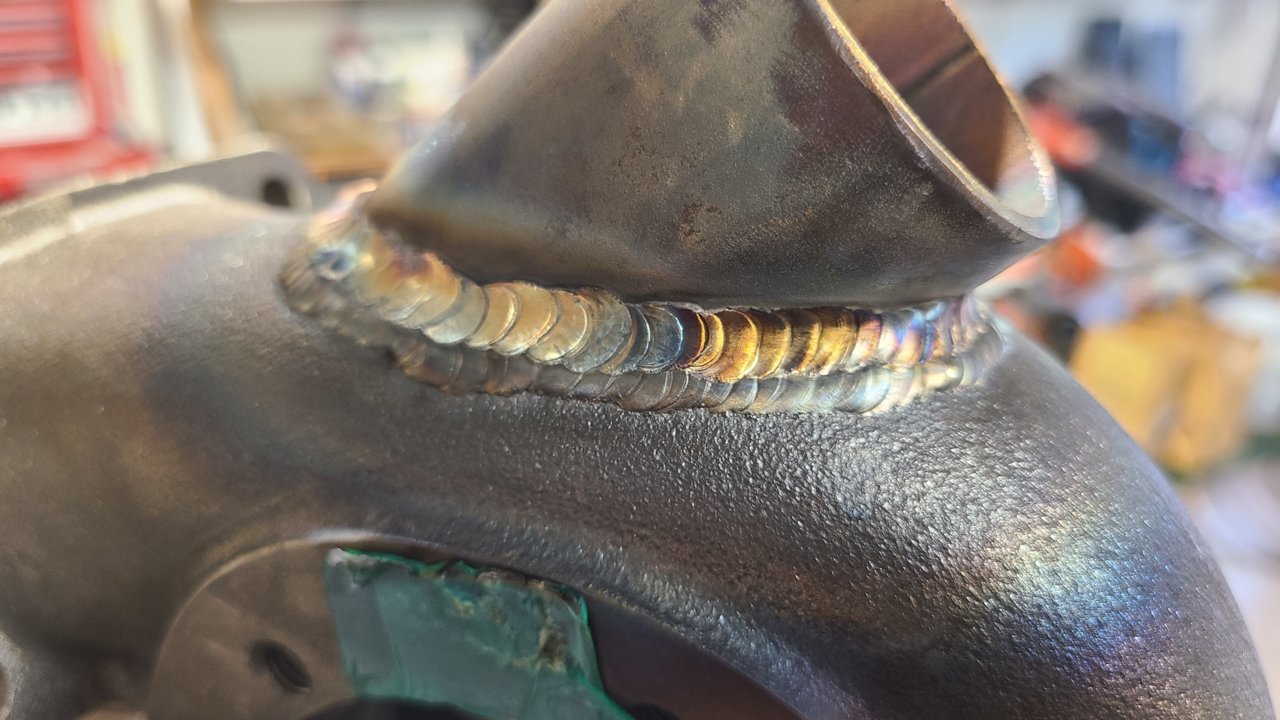

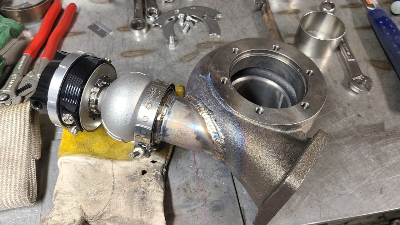

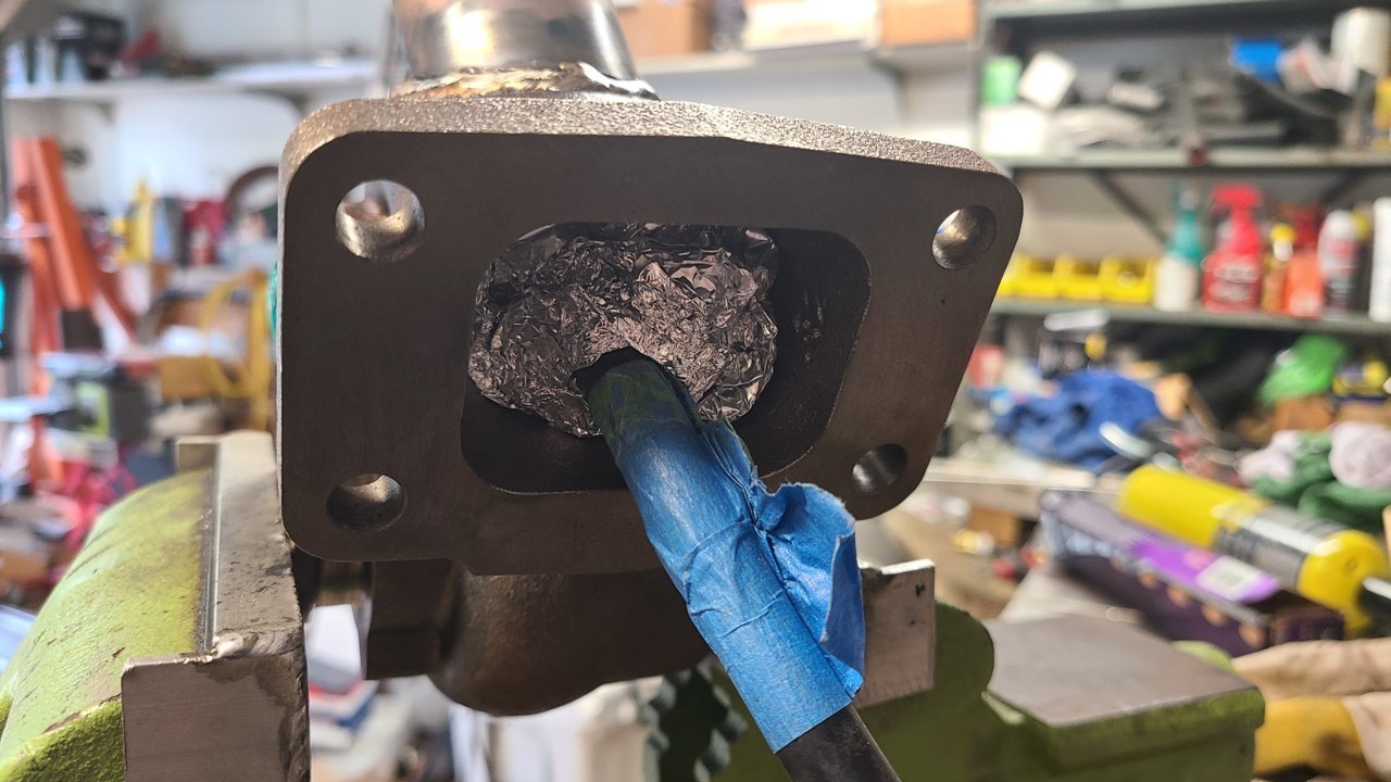

    Came together quite swell.

    @BassAckwards, the larger "dimes" were made with 3/32" filler rod.
