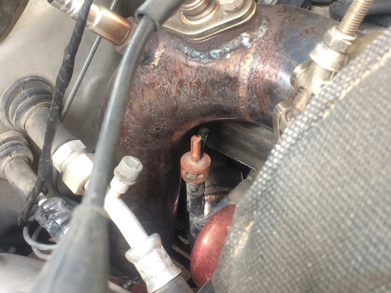

    Neat, what is it?

    I cut the top horizontal thiny off mine. It's just a little vertical stub now. Fits fine, hasn't melted or warped in any way.

    the orange horizontal handle thing? Or the mount for the block?

    Yeah the handle for the trans dipstick.

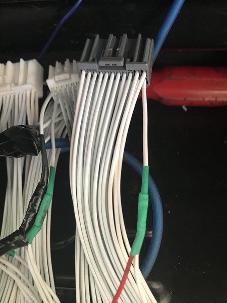

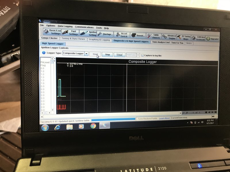

    So I've been messing with trying to get this Megasquirt 3 installed the last week or so. For some reason I cannot get it RPM synced. I originally had the VR wires connected usin splice connectors so i switched that to butt connector with heat shrink thinking it was just not getting a secure connection. It is still not RPM syncing though. Anyone have any ideas?
    This is how i have it wired up using a URD PNP harness:
    Megasquirt = Tacoma wire naming system
    **Red-12V+ = B+ E5 Pin 12 White/Red
    Light Blue-TPS = VTA E7 Pin 10 Yellow
    Gray-VREF = VC E7 Pin 1 Green/Yellow
    **White-VR+ = NE+ E6 Pin 6 Green (VR+, VR-, are in a shielded cable)
    **Black-VR- = NE- E6 Pin 12 Red
    Shielded ground = not connected
    Coolant temp = THW E7 Pin 4 Green/Red
    Air Temp = THA E7 Pin 3 Yellow/Green
    **Runs to both MS and Stock ECU
    MS3X Harness = Tacoma wire naming system
    Injector A = #10 E8 Pin 12 White/Red
    Injector B = #20 E8 Pin 11 White
    Injector C = #30 E8 Pin 10 Red
    Injector D = #40 E8 Pin 9 Red/Blue
    Pin 9 Idle valve = RSO E8 Pin 7 Black/Red
    Pin 27 VVT = RSC E8 Pin 6 Black
    Spark A = IGT1 Cyl 1&4 E8 pin 23 Black/Blue
    Spark B = IGT2 Cyl 2&3 E8 Pin 22 Brown/Yellow
    A couple pics:

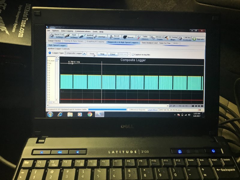

    Here's what the logger should look like:

    Is your crank setup correctly? Think that where you read rpm at.

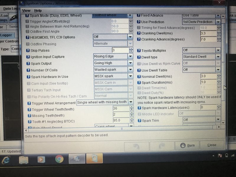

    Here are my ignition settings:
  12. Jun 5, 2017 at 1:58 PM
    #1412
    MadTaco461
    MadTaco461 BRO runner
    Dec 30, 2009
    #28470
    13,436
    CA
    99 turbo 5 lug long travel
    Kinda stock
    "spark hardware" might need to be an area you need to look into.
    Just going off a guess. Haven't dug too deep into an MS3 in my free time. Crank, spark is always a tough one to figure out when dealing with something that is universal.
    boostedka likes this.

    How many wires does your crank position sensor have? Two, or three?

    3 wires. Positive, negative and shielded ground. Most people connect the Megasquirt to the positive and negative and leave the shielded ground as is.
    I went over my wiring schematic again earlier and realized I flip flopped the VR+ and VR- pins :facepalm: I rewired them a little earlier so I'm going to go put the harness back in and test it out here in a bit after dinner
    Hopefully it was something that stupid :der:

    So it is a Hall Effect sensor.
    Hopefully that wiring change fixes it.

    I got the truck to start up! Turned out it was just the two wires were switched. Now I just need to figure out a few others things.
    It idles, but rough. Fluctuations from about 800-1200 rpm. If I try to rev it some it dies

    Needs more fuel and/or ignition timing at idle perhaps?
