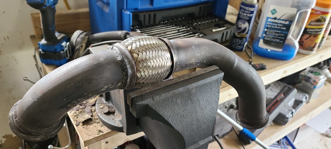

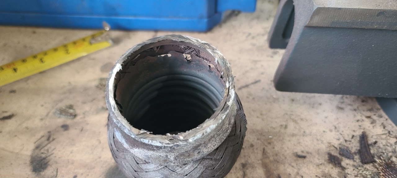

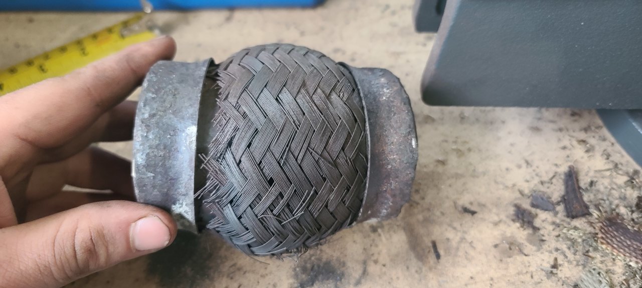

    was getting an exhaust leak and massive amounts of turbo lag. found the flex joint on the crossover pipe failed. 4 years in one of the worst places in world for rust. wrapped with heat wrap. and this is the only issue with the cx manifolds so far. everything else looked fine. even the original vband clamps came off without issues. i happened to have a spare flex pipe in the garage that i replaced with. its a 2.5x4" if anybodys curious.

    Two possible reasons that flex coupling failed. One, it doesn't seem to be stainless. Two, it isn't a "turbo lined" version. Certainly got your money's worth.
    Regardless, good find, and problem solved, yes?

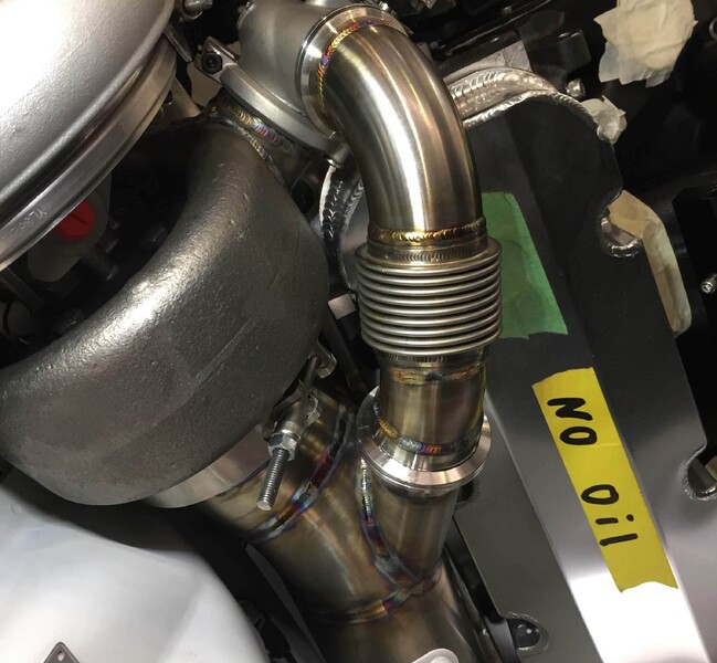

    I used this style of bellow for my wastegate to downpipe. I wish I can weld like this.

    the inside of it doesn't appear to be stainless. or atleast not a very corrosion resistant blend. I did a test fit and it lines up fine still. got it back off and im going to rewrap it before putting it on permanent. the 1" body lift i added makes this job 1000x easier. crossover just slips over the trans without removing headers or dropping trans crossmember

    @Jon64l sure can weld like that.
    Also what I used on the cross-over for the turbo kit I recently built. Might use that or a stainless flex coupling, on the new w/g routing. When that time comes.

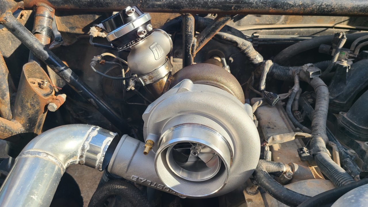

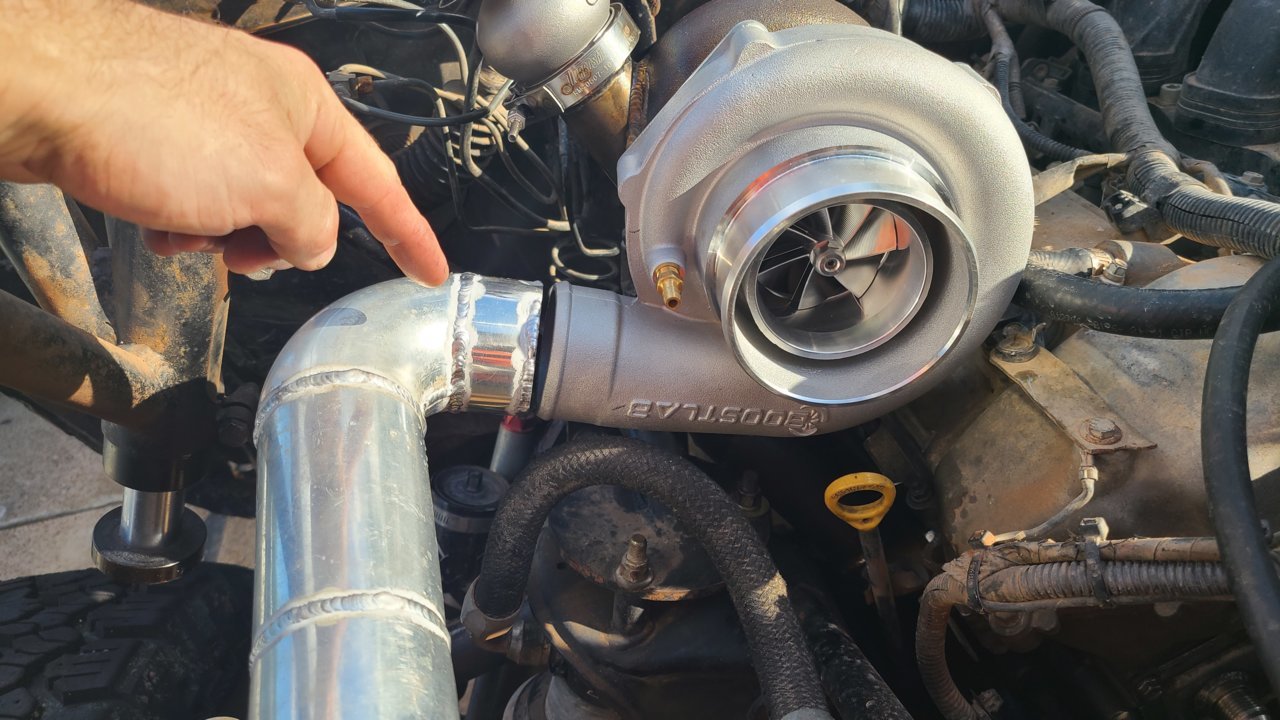

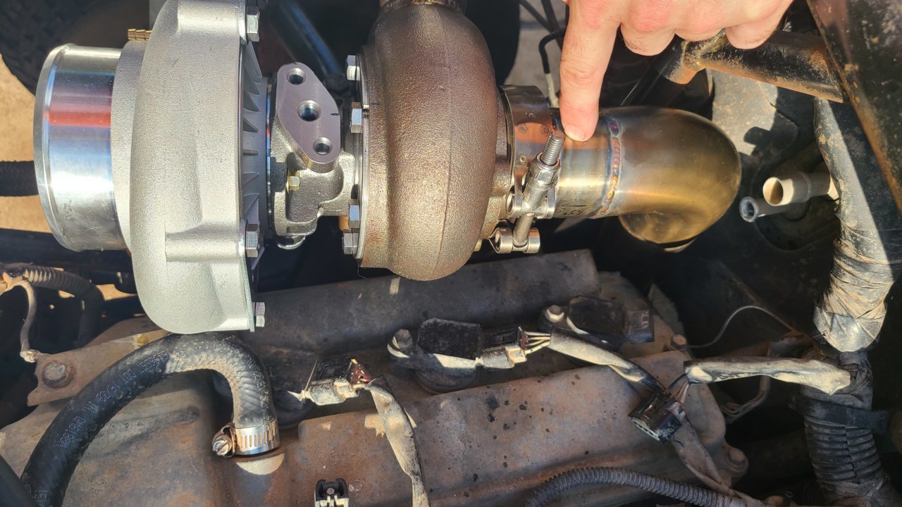

    Been a while since I have made any update to the PreRunner. Knocked these two changes out, to adapt the newer turbo.
    Changed out the v-band end of the tube to regular with a weld on bead roll.
    The extension for the downpipe.
    Wastegate fits under the hood properly.

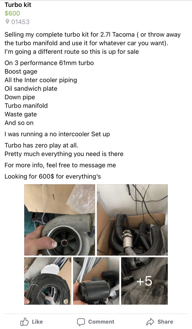

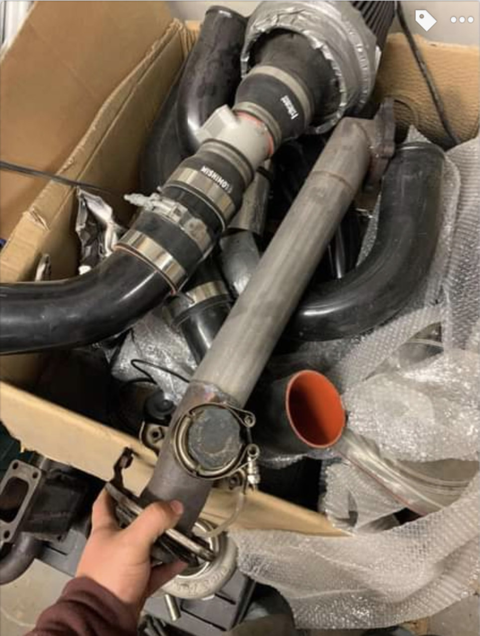

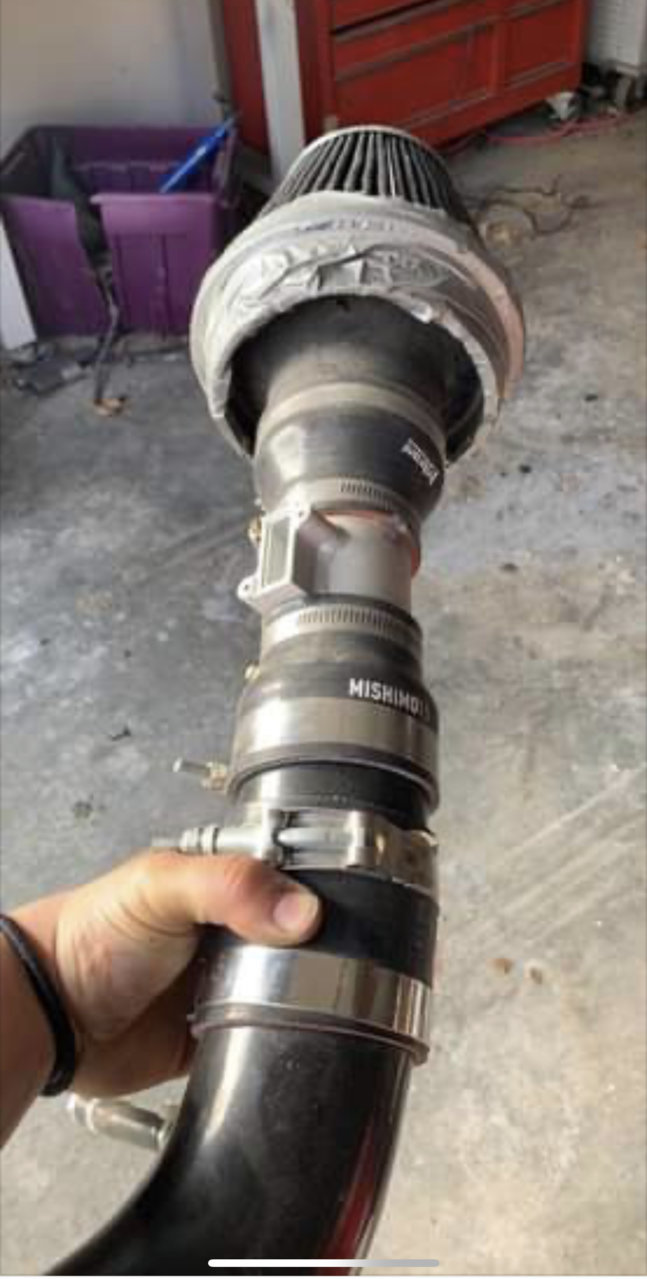

    Well... came across a listing for a turbo kit for a 2nd gen 2.7 Tacoma for $600. Took some screenshots of the listing pictures because I think you'll enjoy them. AE478EE9-76C6-4A90-95BA-868885B54988.jpg1A25E75F-2262-4720-A3B4-2C9B17F155EB.jpg0AEEF6D5-9B4B-4019-929E-2307EC0F8972.jpg
