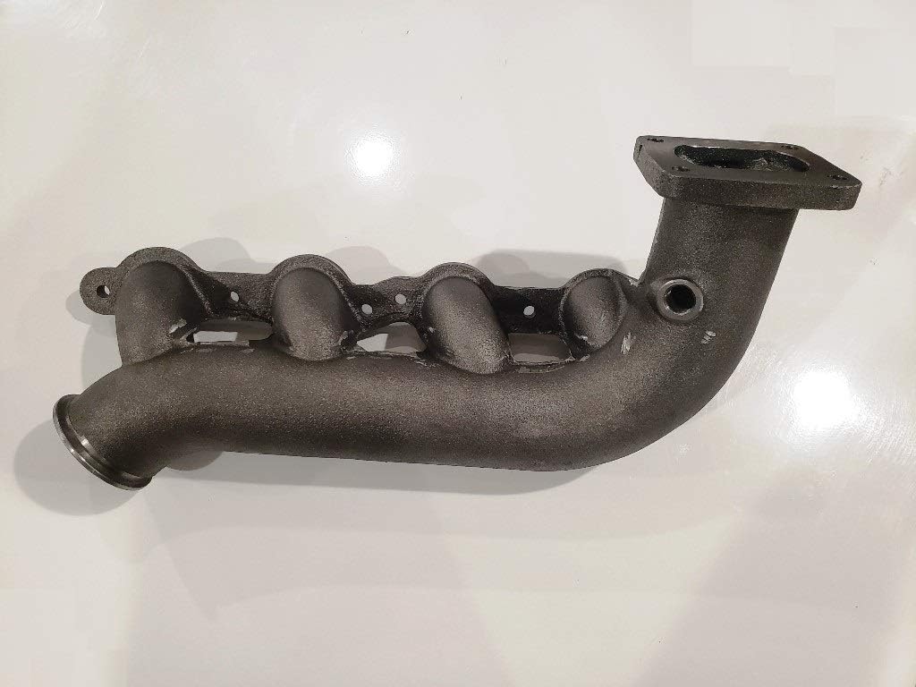

    Ok I have finally gotten around to setting my LS swapped 98 up for turbo. Already prepped the motor, ported 243 heads, larger cam, ring gap, head studs and MLS gaskets, trunion upgrade, new lifters, oil pump, timing chain damper setup and a double roller T chain.
    I ordered a rear feed passenger side manifold with a rear entry and front T4 exit, I can just build and run a crossover from the driver's side mid length tube header over to the rear of the pass side to get the hot air into the turbo.
    I have a VS racing Billet next gen 7875 and should have most of the other parts to put it together by the end of next week.

    Material construction looks very similar to the Boostlab turbo that I have recently been working with.
    Only took you a little while to finally get that turbo build in gear. ;):boink:
