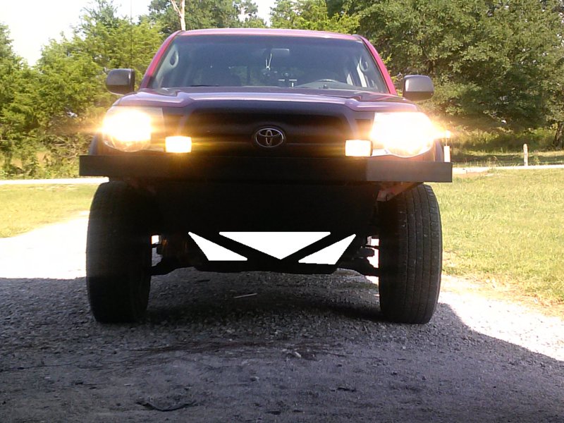

    so I have made Microsoft paint skill and I think I may do something like this for my IC cut out for my skid. I feel like it will have adequate air flow while maintaining a good bit of structural integrity as opposed to just 1 or 2 large rectangles the length of the IC... any thoughts?

    Looks fine to me, unless you plan on stuffing that bumper into any dirt lol

    well I'm 2wd but we will cross that bridge when we get to it. also if anyone else needs any work in paint, lemme know haha

    A lot of guys put holes in their prerunner bumpers. They push it towards the top of the skid. The tubing does all the work. The skid section is mostly for loose dirt, brush and style to cover up the factory stuff.

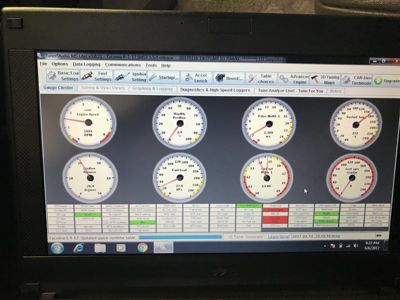

    Installed the 550's today and it started right up and hold idle now. Just kind of high. ~1500rpm. Also leans out quickly under load.

    Does the M.S. require injector dead times or dwell times? Aside from just the size?

    It's does. I'll post up those settings in a while. It's approaching toddler bed time....

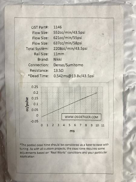

    I hadn't even realized that. This is what the info was that came with my injectors. I'm guessing I can input this number into that screen I just posted up earlier :notsure:
    I'm not really sure how to use this but it definitely looks like I need to

    Correct.
    However, when displayed by voltage, it is much easier to input.

    So do I need to enter 0.542 in both of the boxes that currently have 1.000 entered in them? Or just on of the two?
    Does anything else look like it needs to be changed based on the info provided with my injectors ?
