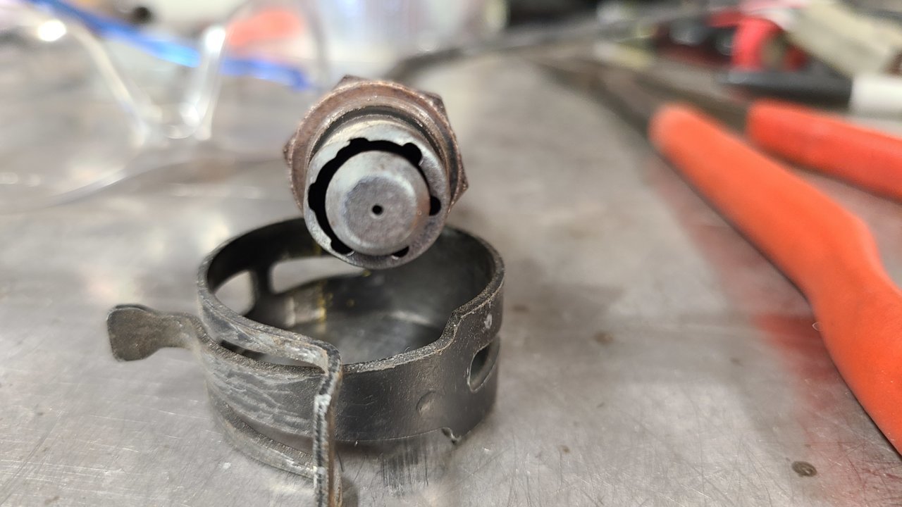

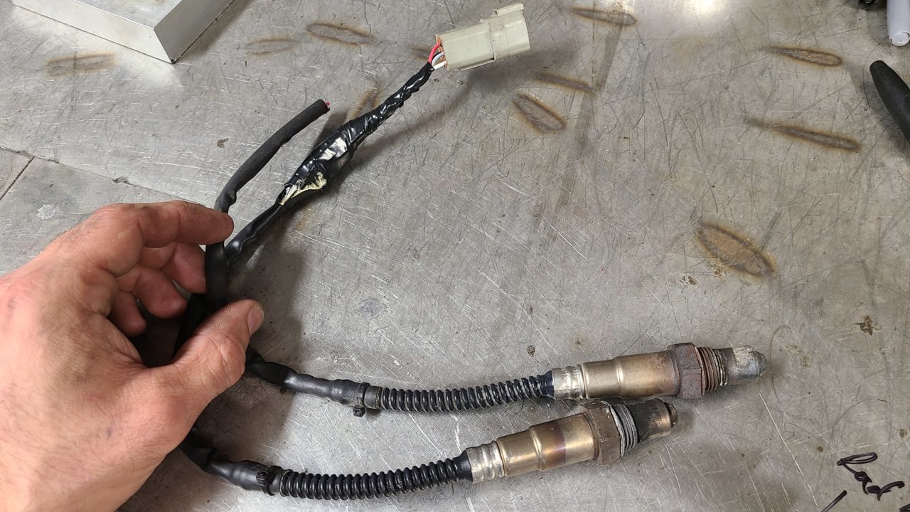

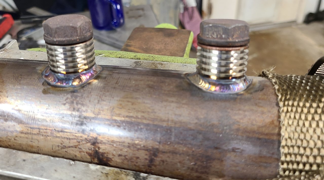

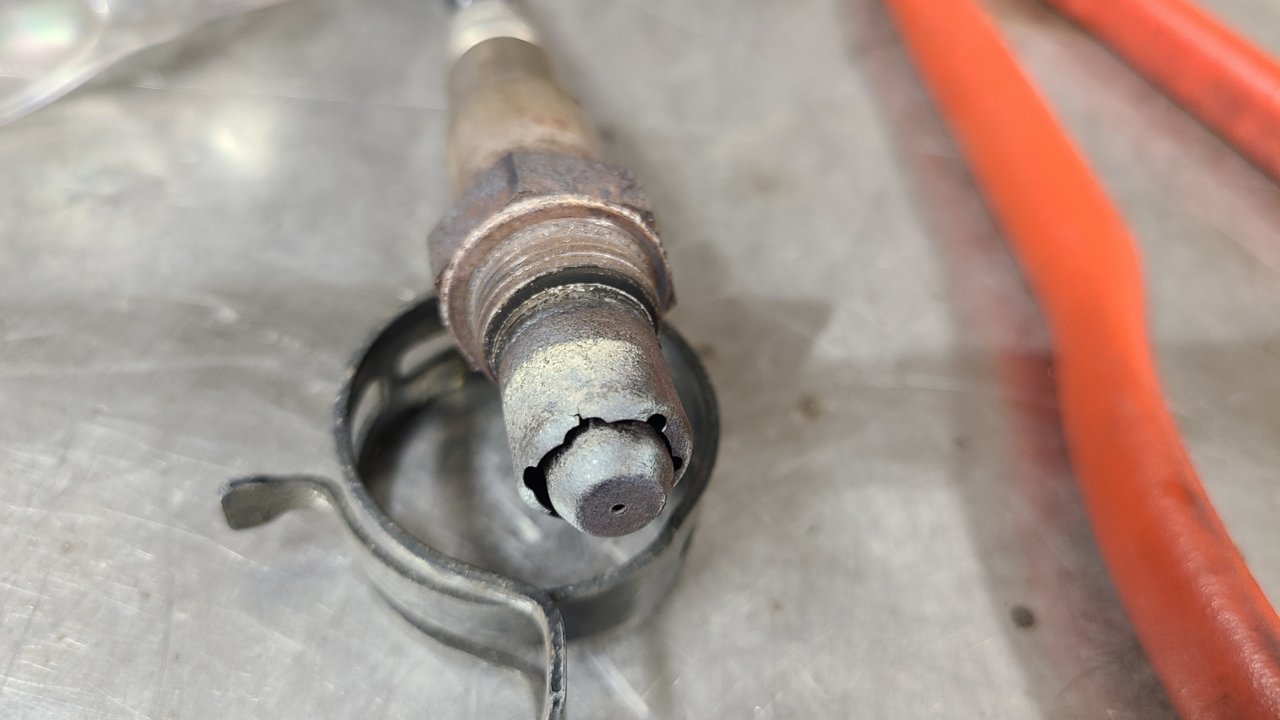

    So I must admit. I was lazy and didn't do what I knew that I should have. Came to bite me in the rear recently. Tuned the truck in N/A, then expanded that tuning into F/I. Never moved the wideband sensors from preturbo to post turbo. It worked and couldn't tell there was a problem. Until recently. Started having some weird engine stumbling, and temporary dips into the 9's AFR's, while lightly coasting and idling. At no specific intervals. Ordered some heat sink bungs to weld into the down-pipe. Here is what I found.
    This is the passenger Haltech WB. Closest to the turbo.
    Next to the driver side Haltech WB.
    Didn't have a spare sensor on hand with the same plug, so I cut and spliced. Blasted soldering iron wouldn't cooperate.
    www.stainlessbros.com bungs welded in. Truck didn't seem to run any better. Actually, it kept doing the random stumbling. Yesterday, I had the opportunity to do some troubleshooting. Seems the driver side sensor had extinguished its life as well. Just wasn't visible telling.
    Disabled that sensor, and truck is running like a champ. Way better than expected. Need to upgrade to the CAN system now, with two new sensors and it will be perfect.

    i've been having problems with my aem wide band. in a year i've gone through 3 sensors and now seems like a 2nd gauge.

    How far downstream of the turbo are these failed sensors? Never had any issues with my VW o2 and it was about 2’ downstream seeing regular EGTs upwards of 1200*. A few spikes into 1300/1400 territory but my EGT bung was 4” post turbo (2.5->3” DP) on the last iteration and in the hotside housing before (3” DP).

    for me they are maybe 20-24" from the turbo. im pretty sure aem recommends a minimum of 18".

    On an A4, it was within 3"-4" from the turbine outlet.
    Just to reiterate, mine were pre-turbo. Getting all of that glorious pressure and heat. That pressure really skews with the sensors though.
    Now, they are about a foot away.
