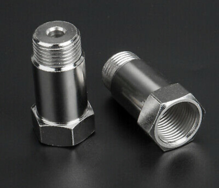

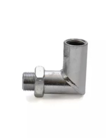

    Quick fix would be parts house spark arrester in the ‘Help’ section. Slightly longer would be a fleaBay purchase of purpose built one using same principle.
    I’ve read that a sleeve of pipe tie wired onto the bolt on kind so well.

    I believe has the something similar with the catalytic material in that extension.

    Maybe an extension on and extension??? :anonymous:

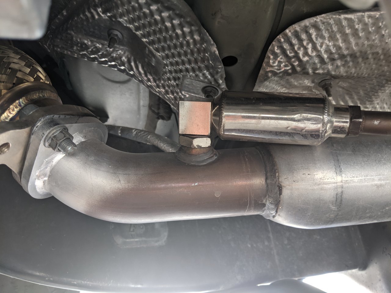

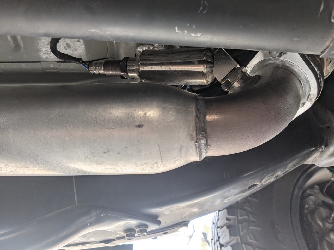

    Yeah I have Fabspeed's sensor spacers with mini cats

    No code for passenger side, which would be p0420. I just have p0430

    Have you tried pulling the sensor and checking to see what that Fabspeed insides look like? Since it has a few miles on it now.

    I peeked inside the mini cats when I first got them. They had actual cel material in them. Idk what they look like now though. I guess it's possible they'd be clogged but after only about 2500-3k miles, not likely I would think
