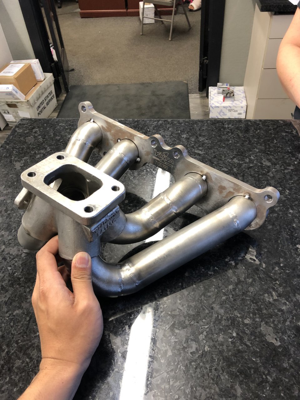

    I found a guy who’s able to make a turbo manifold for my 2tr. This unit is for a 3rz that he’s making now. I don’t believe he’s made one for a 2tr yet. Price was quoted at 1000 to 1500 range. Thoughts? Any interest? I’m thinking possibly a group buy for better pricing.161C3099-D2CF-4379-8A6E-C61DE211804E.jpg

    It took me 40hrs to make my 2rz manifold, but I'm slow. 1k sounds about right. I would swap runners 1 and 2 around. Makes for an easy oil drain.

    If you swap runners 1 and 2 wouldn't your flow be messed up with unequal lengths?

    Im actually considering buying a welder and having a go myself. Probably a log style, simpler the better. Do you have a picture on how your oil drain is ran?

    It's unequal in that picture anyways. Switching 1 and 2. Also 3 and 4 would give you closer to equal length. It might help scavenging because fire order is 1-3-4-2. Mine is a unequal short mani. I felt a huge difference going from log to a 4 to 1. Couldn't tell you how much better equal length is.

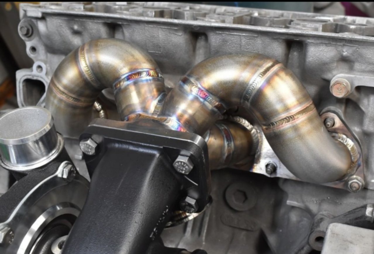

    I was going for an amateur version of this, but a tighter collector angle than this.

    I can see why that angle is wide though. Easy to access the weld points.
