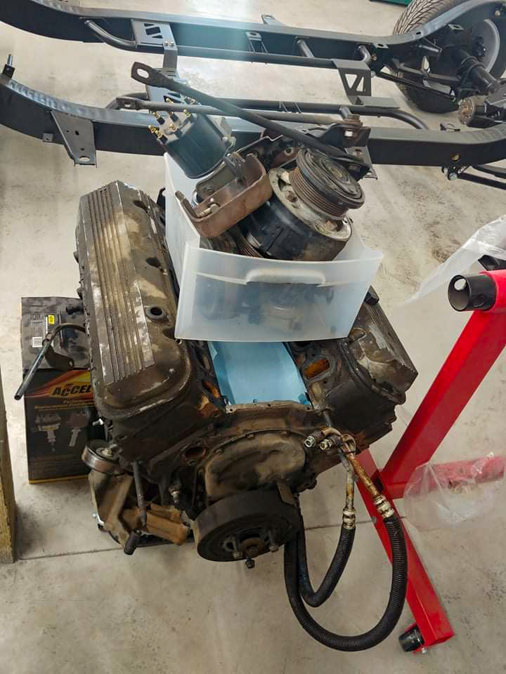

    I sold the BMW, but I did buy a beater 1978 Chevy C10 and a 454 that's I'm working on building and then swapping in so I can later boost it.

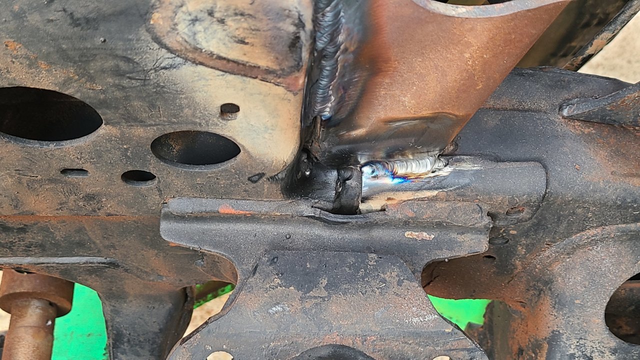

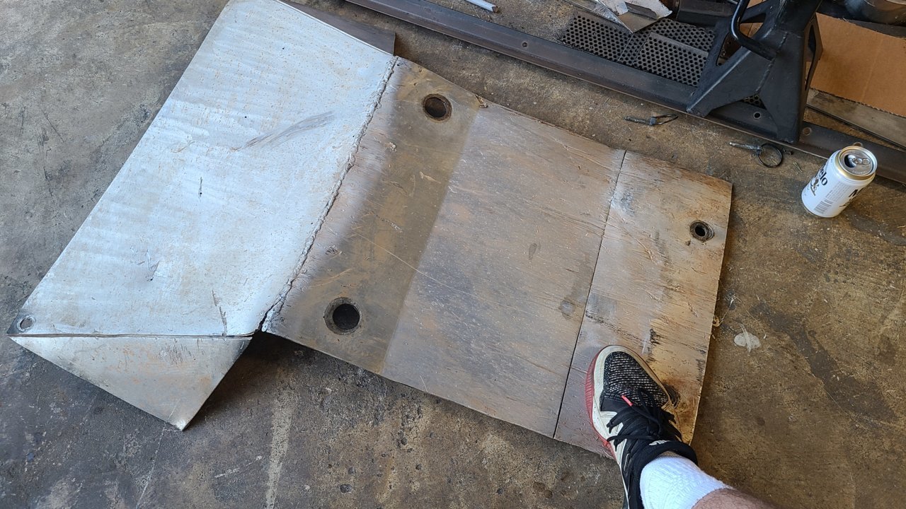

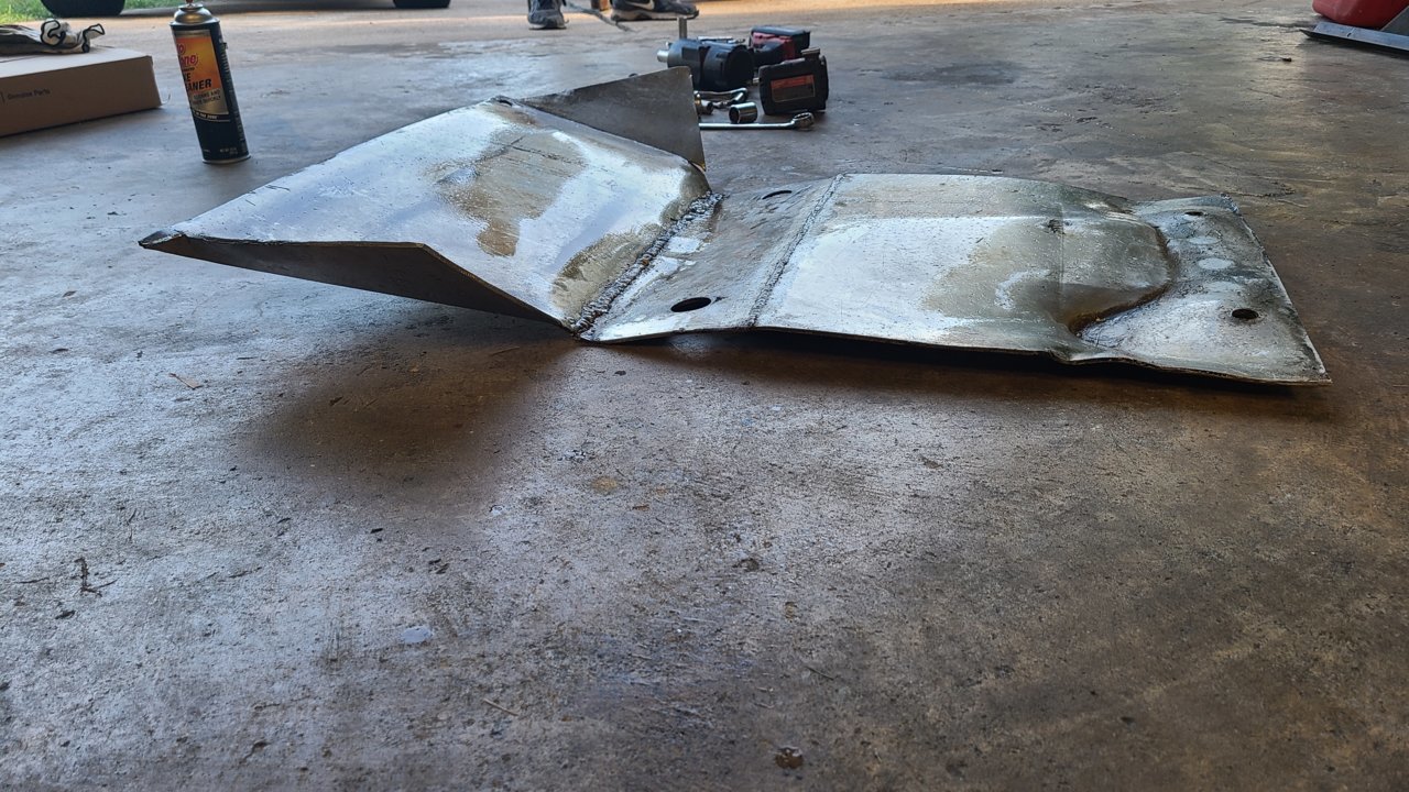

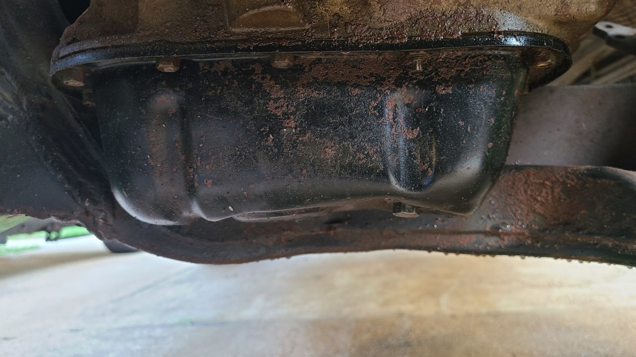

    The skid plate (3/16" AL) had taken some gnarly hits. Bent it away from the lower oil pan, where they had formed an unhealthy relationship.
    Then flattened as best as possible with my meager tools. Hammer and heat.

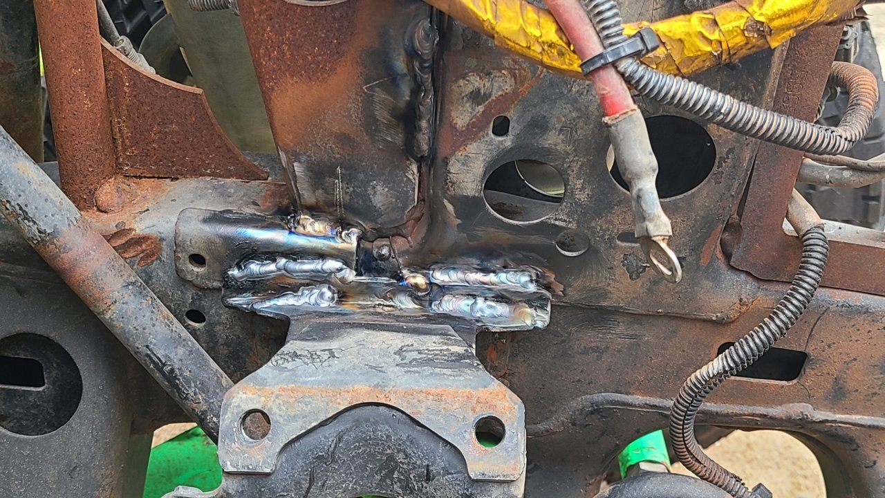

    Under my advisement, I was able to repair the engine mounts. As well as weld up the gussets a little further than before. Driver side mount on the frame isn't as pretty as I'd like it, but it has solid welds and double passes.

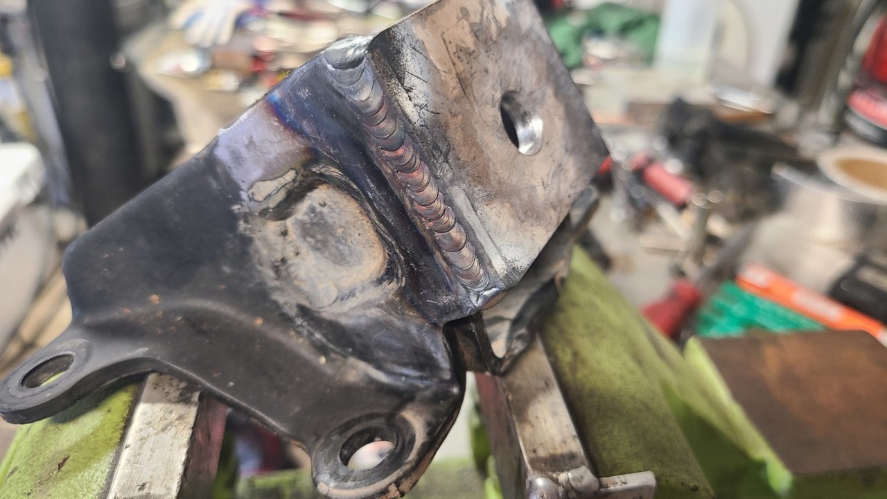

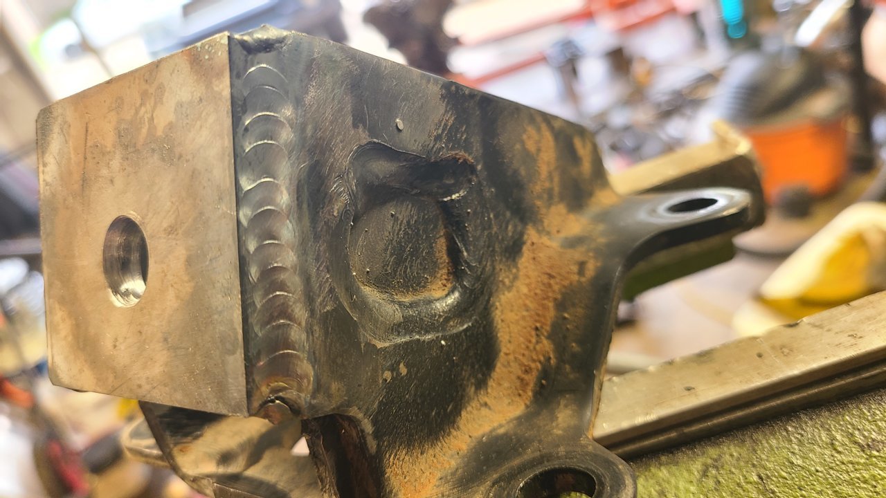

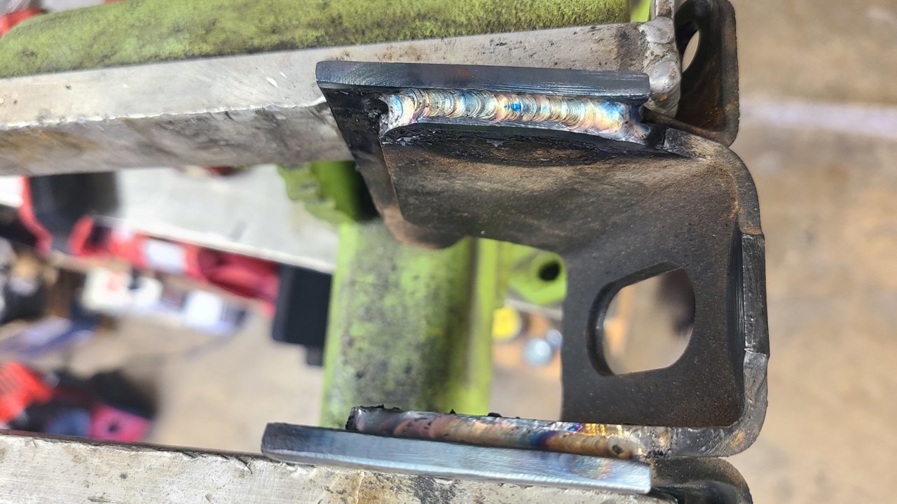

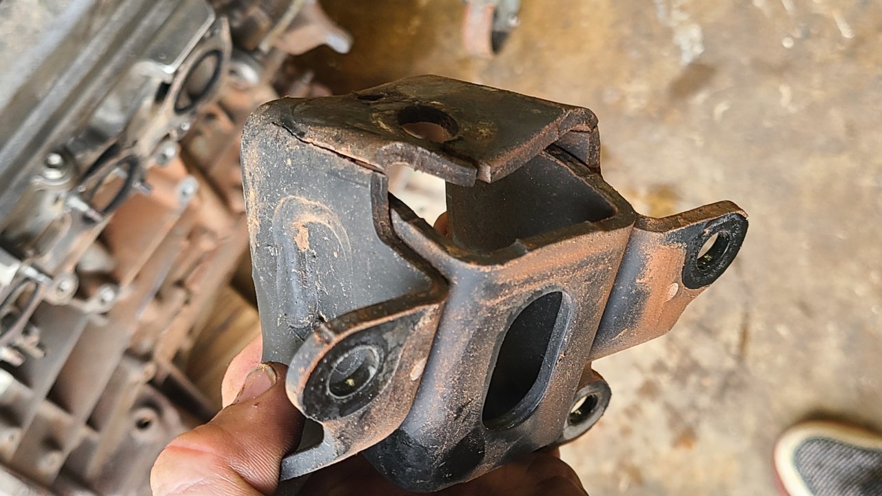

    Better suspension means bigger jumps, and harder hits. Shows on this passenger mount.
    Cut off the damaged area, and added a thicker plate. Added a pair of internal reinforcement welds. This mount is only welded at the center, of either side.

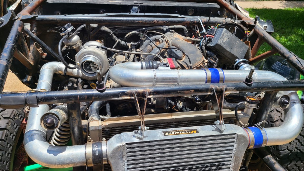

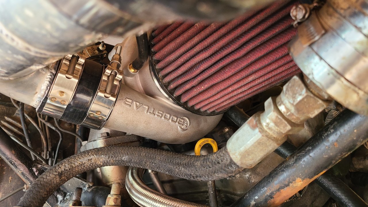

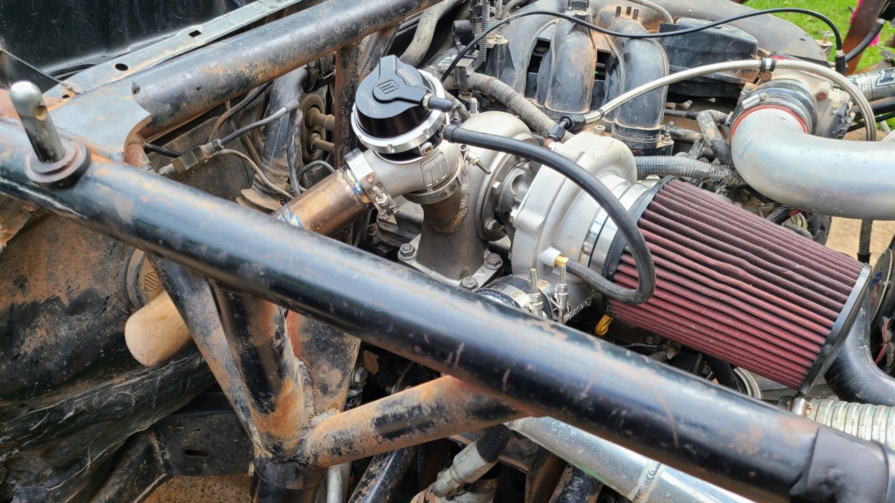

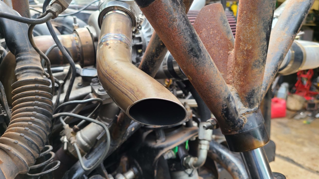

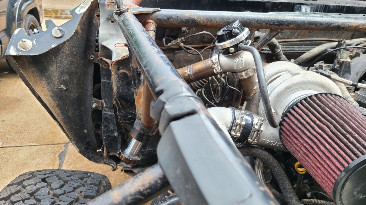

    Everything back together, I needed to make the screamer tube.
    From this perspective, you can see how tucked up it it, next to roll cage. Should never interfere with the cycling of the tire, at full compression.

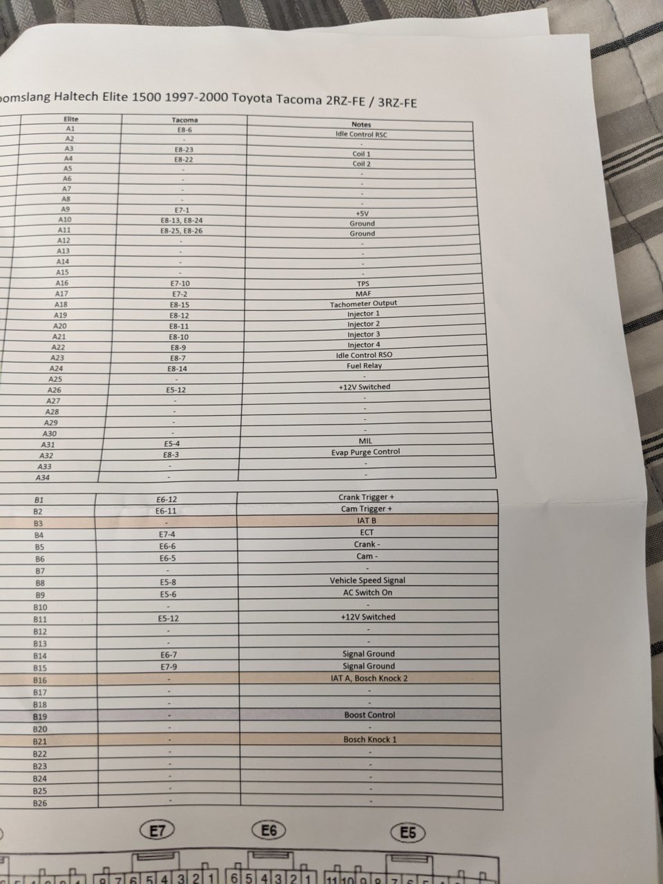

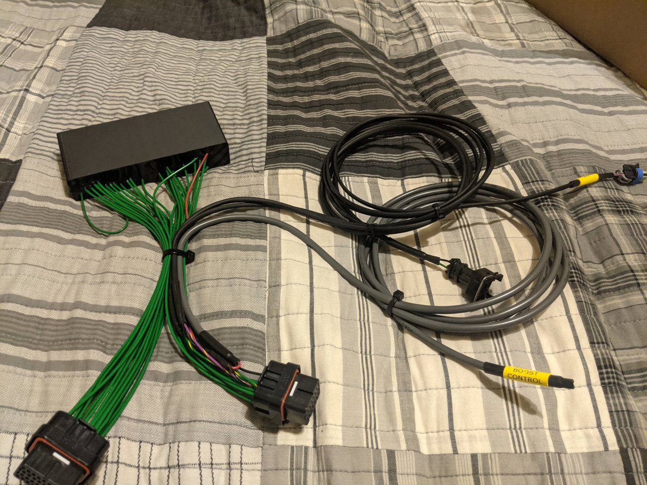

    My harness came in. I got my work cut out for me. Now I just need to get motivated. Had no idea it was a complete ecu delete. Crazy how many wires are eliminated now. Cool it can run everything. Shoot I still have charcoal evap canister control.

    Where did you get the harness from? And what ecu are you gonna be running?

    I seem to remember him going with the haltech, and I believe it's the boomslang harness? He'll have to correct me if that's wrong.

    right on the money. Haltech 1500 and boomslang harness.
    I had boomslang add a knock sensor and iat sensor. Boost control included.

    Now I thought the boomslang harness allowed you to keep the factory Ecu for gauges and stuff?

    It might be different for late model trucks. All I need to light up on the dash is speed and tach. I'm going to look at the oem electrical diagram again to refresh my brain. Here is what wires I have going out if it doesn't resize it too small.

    You should still be using your stock ecu
