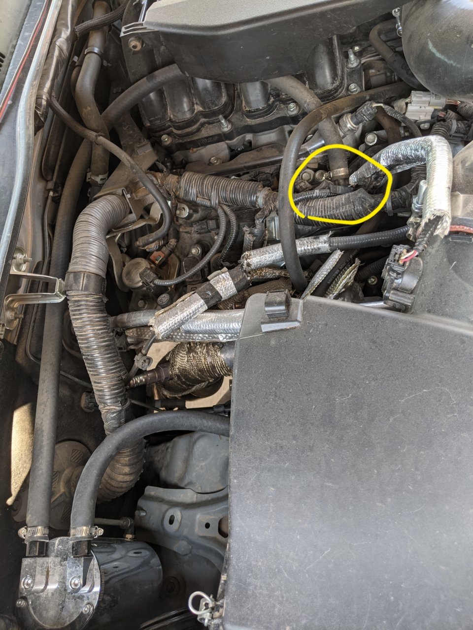

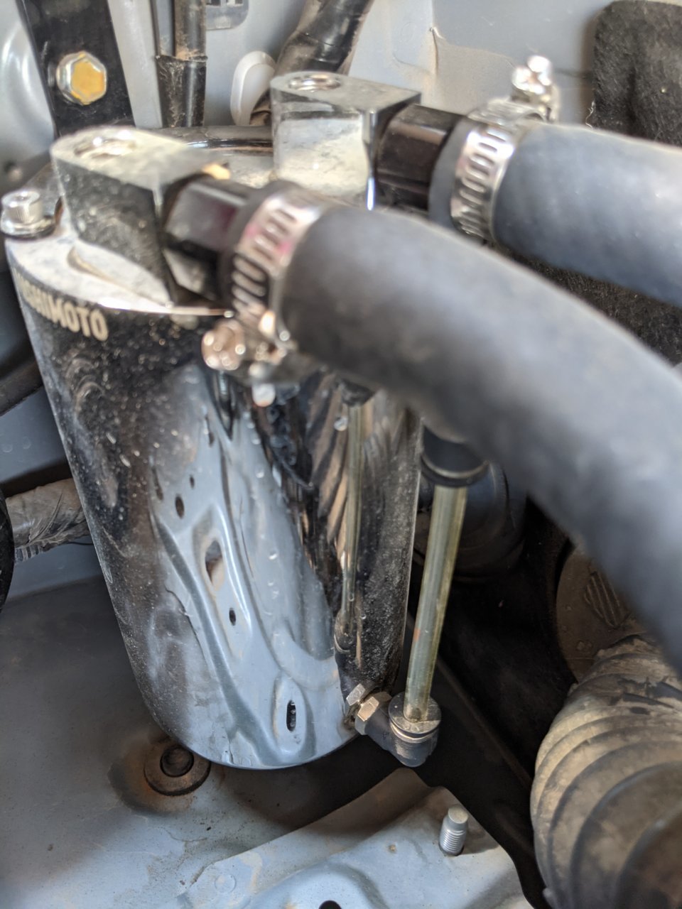

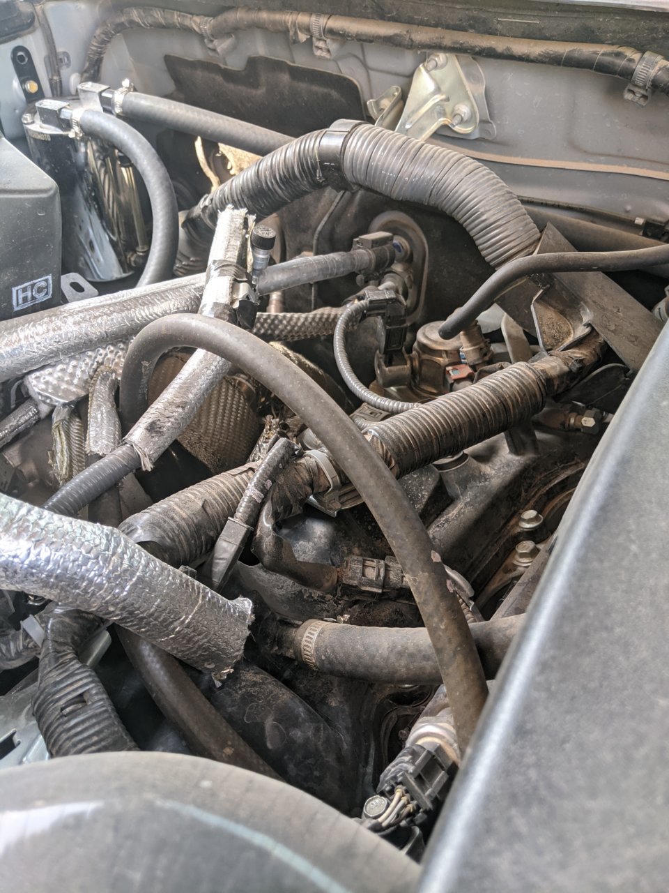

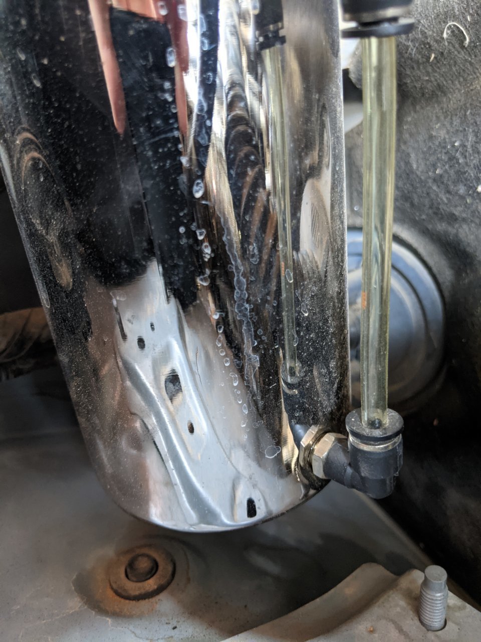

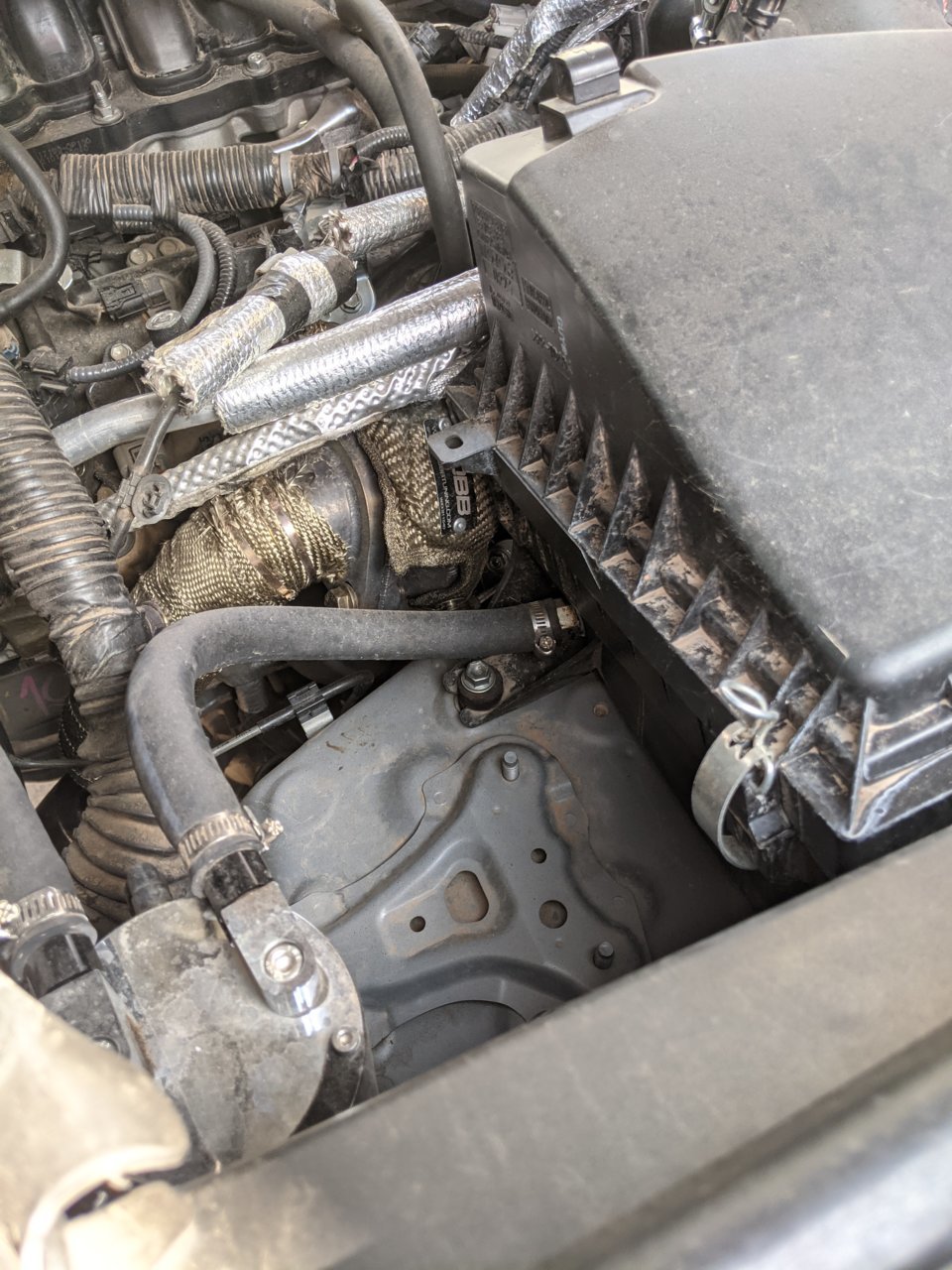

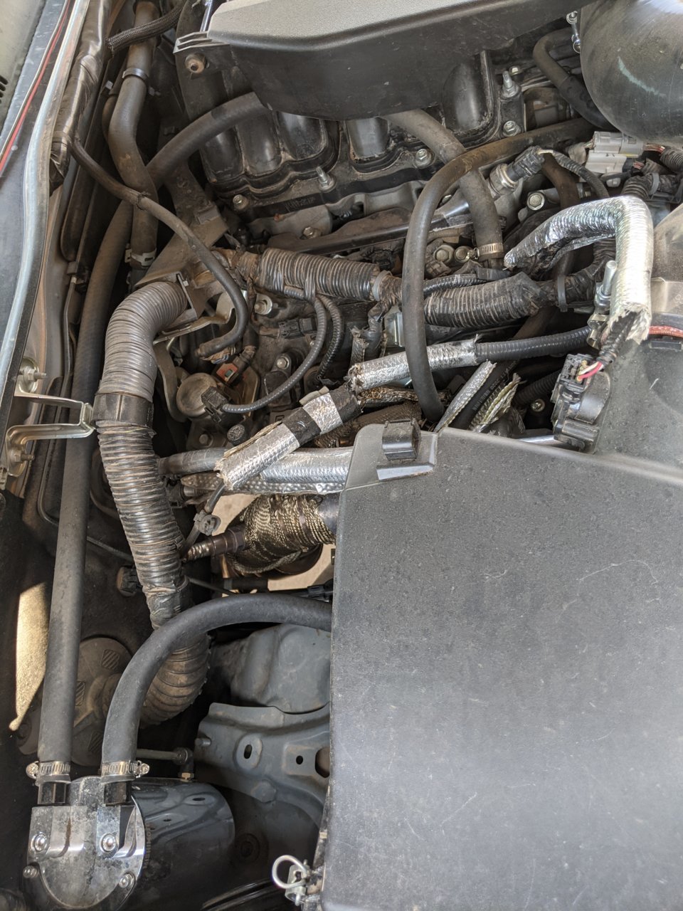

    Looking for some input from turbo wizards like yourselves.
    I've got 5k miles on my TT kit and don't get me wrong, they haven't like really hard rough miles, but I feel like my oil catch can should have plenty of gunk in there by now, no?
    It's got none as far as I can tell by looking at the tube on the side.
    It was hooked up by the shop that did the initial kit install. Passenger side since the driver side has that check valve provided with the turbo kit.
    Hose to pcv, hose to airbox for fresh air...
    There's no way the truck is simply just running that beautifully...is there? No way right?
    Do I need a check valve in the hose that runs from pcv to catch can? Is it just installed flat out incorrectly?
    See pictures below:

    @mZiggy
    Ditch the can and run hose down to the frame.

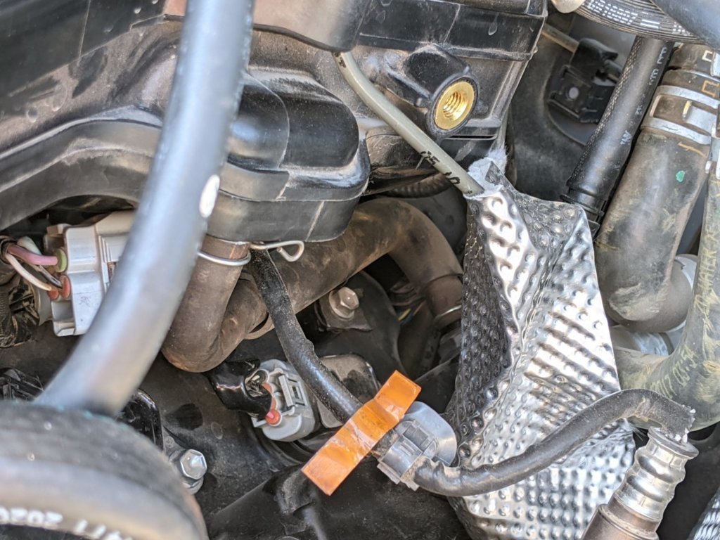

    On the driver side, from valve cover to upper (plastic) intake plenum, is there a vacuum hose? Is there a PCV valve there as well, on that valve cover?
    Is that attached to the valve cover?
    Does it normally go straight to the intake filter box?

    I basically figured out that my passenger side catch can is working, but not really doing too much either because it's breather side, and then shop probably placed that line at the airbox out of convenience rather than post-maf. But probably not a big deal since the truck is running well anyway.
    As for the driver side, I thought the check valve was doing more than simply preventing boost leak, so I need a catch can there but idk if it goes before or after the valve. I'm assuming it's too far to use the same catch can I've already got.

    So I apparently don't have a photo of the line after the check valve went in, but that's it. The brown one. Check valve is in there, and from what I understand the line for the catch can needs to be as well then
  18. Jul 22, 2021 at 12:36 PM
    mZiggy
    mZiggy Honey badger
    Apr 8, 2017
    #215707
    4,709
    Marc
    2020 MGM Tundra SR5; 2020 4R TRD Pro; 2008 4R SR5 v8
    Okay, someone saw my posts in the vFTuner thread and took pity on me, explained what to do.
    Basically I need to get the JLT catch can for example and put it in-line, after the check valve.

    I want you to try something.
    Cap, plug, pinch like a water hose, whatever necessary, that port on the driver side intake manifold.
    You can leave the PCV side, on the valve cover open.
    If the only other tube routed to the intake, is from the passenger side valve cover, but that one goes only to the intake box, and not a source post MAF, then you can leave that one alone. Or you can pull it off of the intake box, and cap the intake box port.
    Basically what you're doing, is disconnecting the PCV system and hoses from the intake manifold. Which is not a bad thing. Especially not for just testing.
    That driver side port must not be able to pull vacuum, and be sealed well and good.
    If there is a vacuum hose going post MAF, to a valve cover, it must be capped.
    Then test drive.

    What it comes down to as the easiest method for a catch can, is to have both valve covers routed into a catch can. Then a breather on the catch can. All manifold ports to the valve covers must be blocked or capped.
    The little blow by from the rings, will then vent nti the can. No positive boost pressure will be able to go into the crank case this way. It will only go through the throttle body, into the combustion chambers as it should.
    We can talk about how to route one can then.
