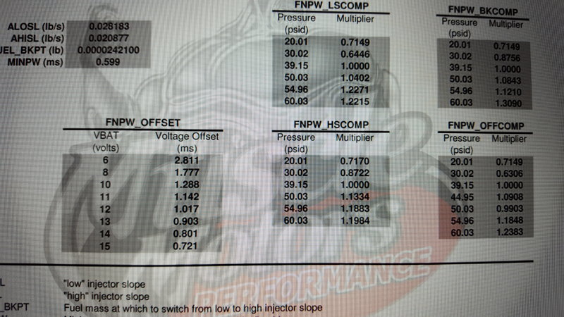

    It is quite a capable EMS. I know that yhere were quite a few Custom Tacos owners, who used the older versions.
    @boostedka, I forgot to take a picture last night. Did you happen to make any progress?

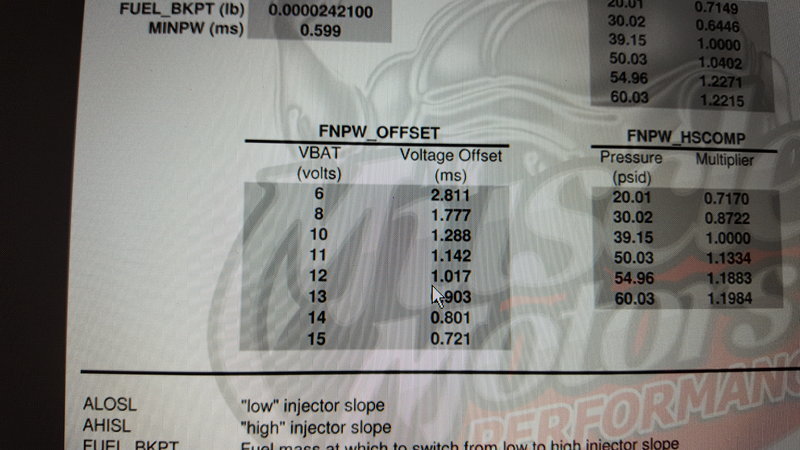

    Here is a reference in voltage format. These are Siemens injectors.

    Thanks for that reference. I'm going to mess with it more this afternoon. I didn't get a chance to last night

    I talked with Kurt about some of the features that he was using but I am not and figured out what settings needed to be changed. Once I did this, I was able to play with the fuel table a bit and get the cruising AFRs decent. I'm hoping to get some more tuning done this week and probably throughout the summer.
    The main thing I need to figure out is lower the idle speed. Once warmed up I'm at about 1600rpm. I obviously need to get this lowered to 800 or so.
    Thanks to those of you that helped me out so far
