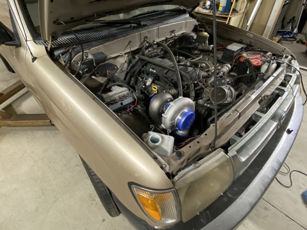

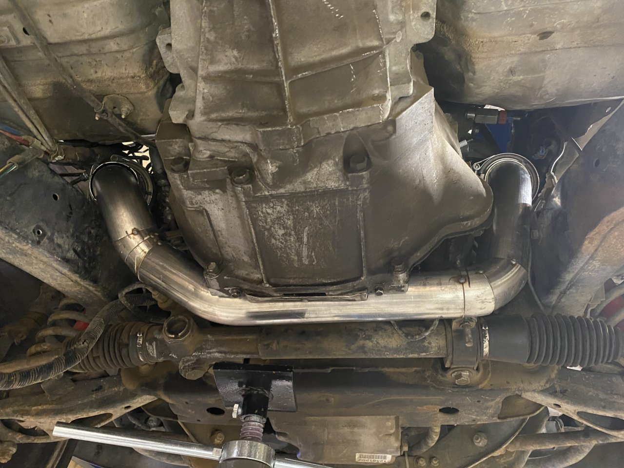

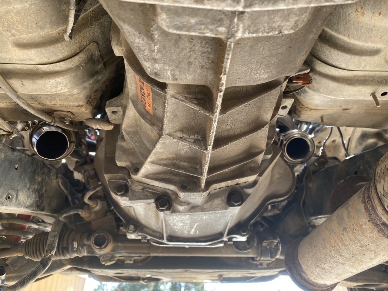

    Finally been able to make some progress on my own truck after working on everyone else's truck all day long!
    I got my crossover pipe done and installed as well as the turbo passenger side manifold, got the turbo just sat on there for mocking purposes so I can start the plumbing and IC mounting. I should have the cold side plumbing done by the end of the weekend. I still have to order some 3" stainless for the downpipe and I am going to expand it to 4" just after it exits the turbo for better flow since I will be running full length exhaust.

    Got a flex pipe on the crossover? Can't see it from this angle. That down pipe from the turbo looks fun to make. Crazy that the wheel wells are still factory. Power to you squeezing 15 lbs of shit in a 5 lb bag.

    No flex crossover but hopefully the manifolds wont move much, I was thinking about it but Im really having a hard time with packaging. I dont think a flex bellows would fit due to the increased diameter since its literally touching the oil pan gussets that I had already cut back to make space for the old exhaust.
    So I'm just hoping there is not much thermal expansion creating A lot of movement, but if there is I will have to address it later.
    Yes more like 40lbs in a 5lb bag, everything is fighting for real estate, also realized one of my AC lines off the compressor is toughing the manifold so that's not good, lol. And those wheel wells are likely going to become swiss cheese if I want to get the hot air out of the Turbo hotside, Im going to run a single 4" from the 3" out of the turbo.
